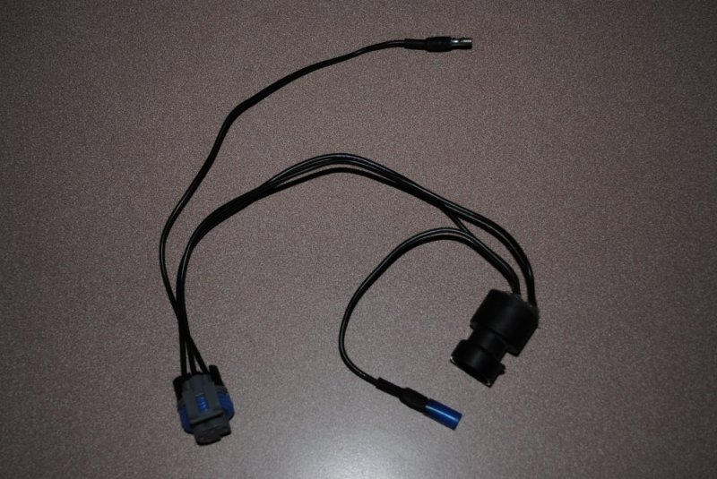

I bought this OPS pigtail:
http://www.wiringproducts.com/gm-oil-pressure-connector-pigtail-1-pc.html
I'm about to remove the original Chinese OPS pigtail from my harness to add this one, above. The other side of what I suspect could be an issue is the portion I made up using an old OPS, where this part plugs in. Both are shown in this image
Does anyone have a photo of how Leroy's harness plugs into the OPS?
I think his harness plugs into the lp. So if the system isn't working right it won't help until you get it fixed. Once fixed its only the signal for the new relay.
His does plug into the LP harness, but it has to pick up a contact from the OPS, also. I know there is a battery power wire, since there is a momentary switch to prime the filter, also.
