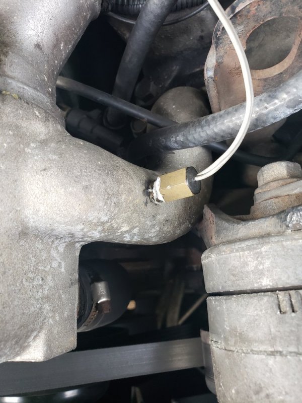

I drilled and tapped my cross over \, has worked fine for 2 years so far
Could You take a pic of the crossover, for location of drilling purposes.

Take a look (I can’t remember how tight it is) if you can just put a “T” in the current crossover port there now with the hose going straight thru and the sensor into the new T port.
