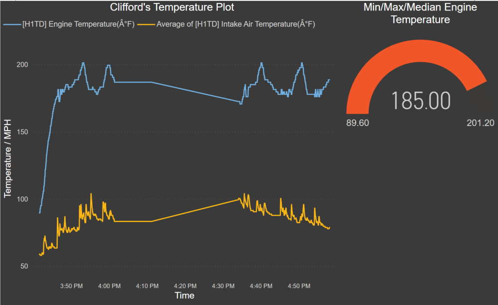

Yesterday's drive to the gym and back (my debugging trip) was MUCH better. The disengagement was still longer than I'd like but MUCH better than with the tee there. My max temp yesterday was only 201 so I have a bit of headroom on the engagement screw, so I went ahead and bumped it up a smidgen and will test today.

(long slopes in the middle were while the truck was parked)
