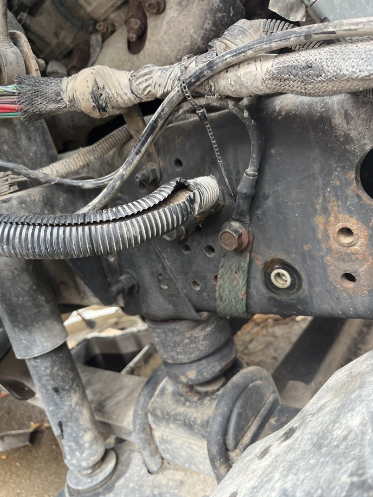

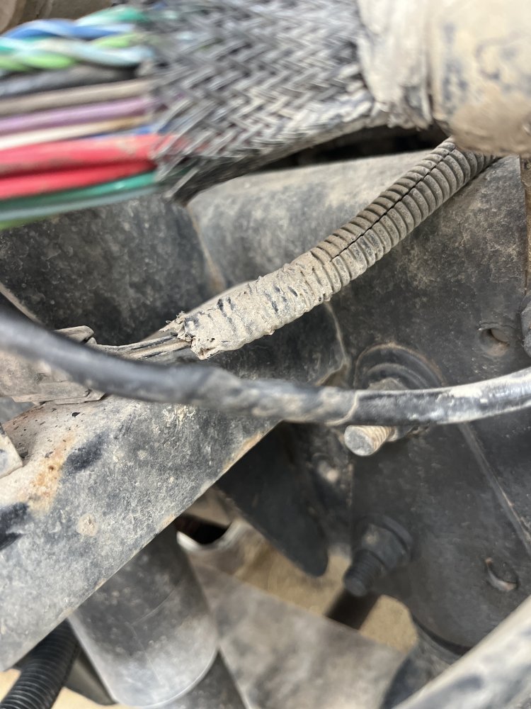

What’s the best way to possibly fix this ground wire. It’s a little distorted and bulged
If I new we’re it went I would just run a whole new line.
Maybe someone has a wiring schematic
This is on the front side frame rail
