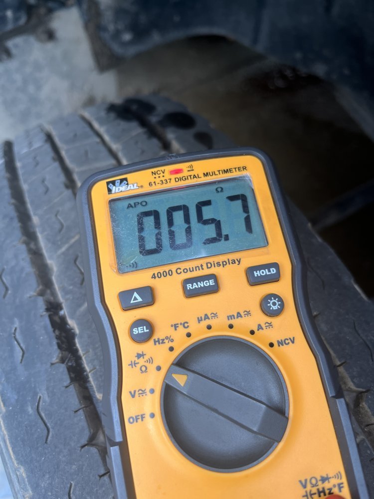

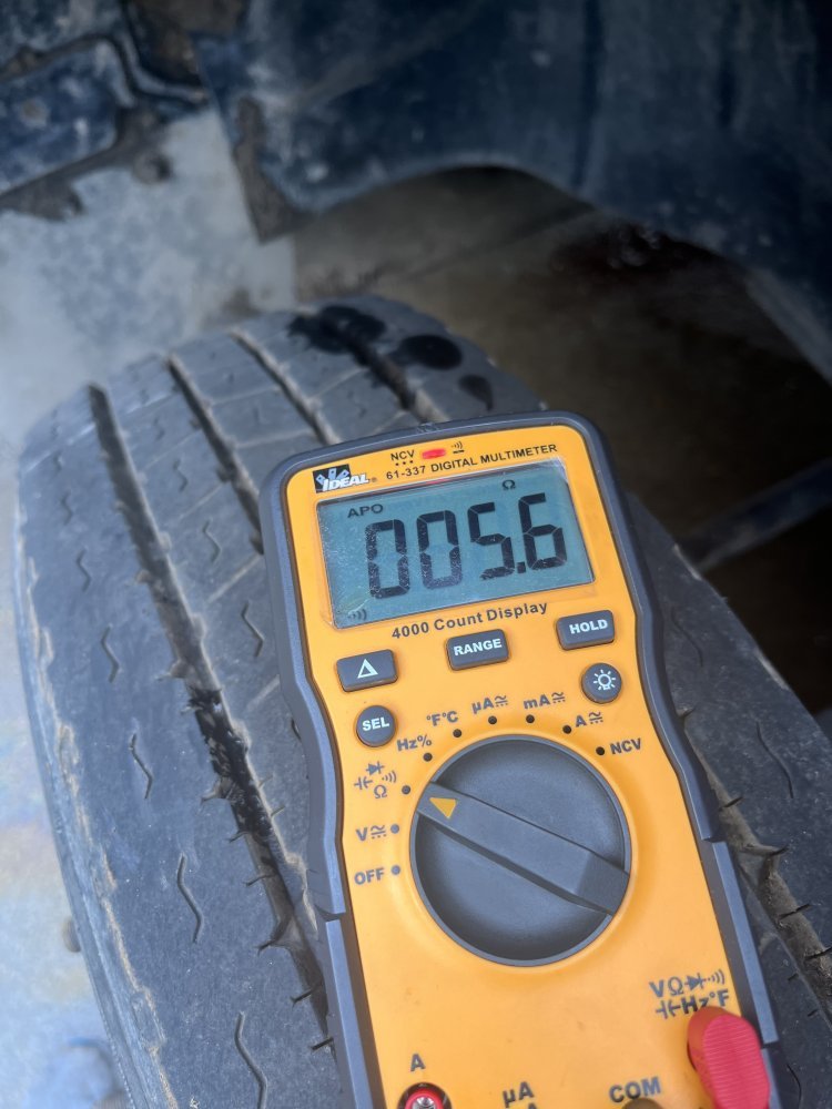

Is there a chance this solenoid is bad right right from XDP diesel’s.
Does anyone have a diagram or no we’re the ground for the TCM goes. I would like to change that to.
