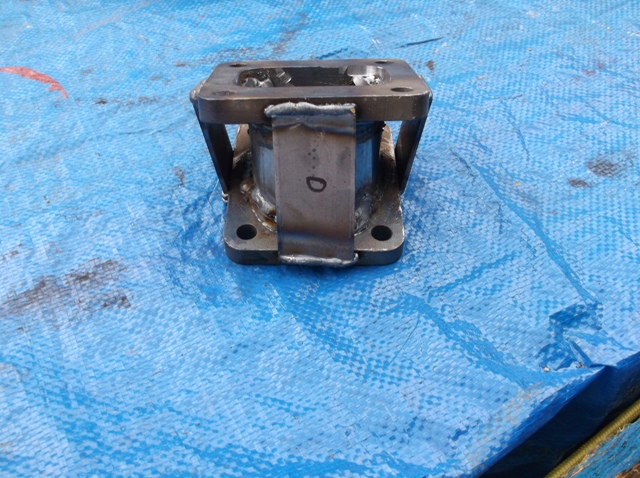

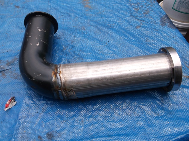

5. Got an adapter made to clock the turbo 90*.
Forgot pic's
Turbo adapter.

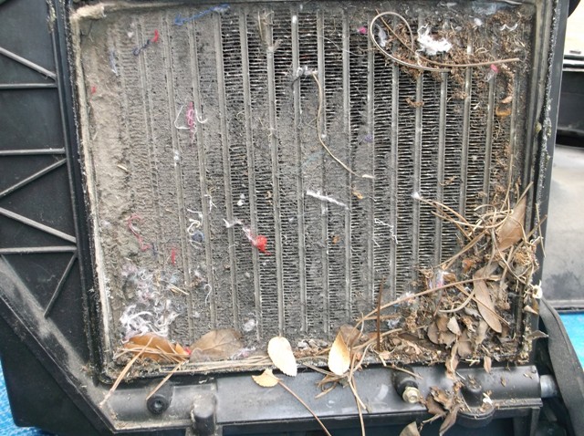

This is after I brushed of the heavy stuff then remembered to get pics.

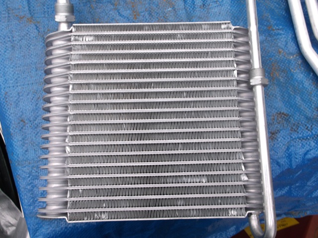

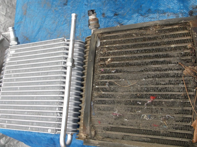

This is after a good cleaning! JK its the new one

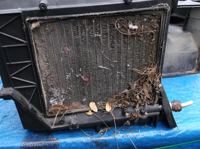

We really need a cabin air filter for these old trucks. Maybe I'll have to do something about that? For now Im thinking of stuffing a piece of foam in the cowl. Do you think it would restrict the air to much? Guess it depends on the filter eh?

Ewww. Makes me want to take mine apart to clean it. Then I think about hours taking it apart and I change my mind.

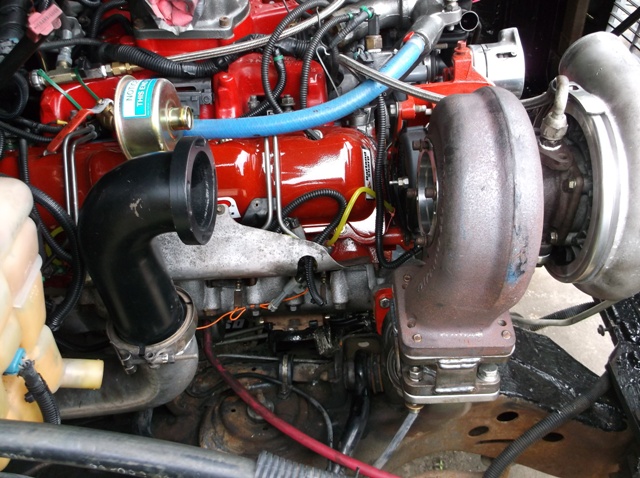

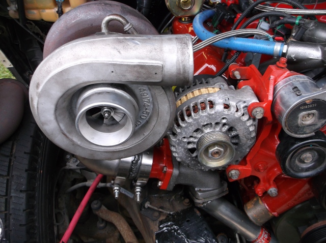

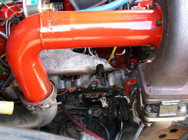

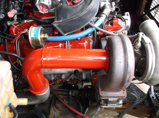

Got turbo mostly installed, just have to make a new oil drain hose tomorrow.

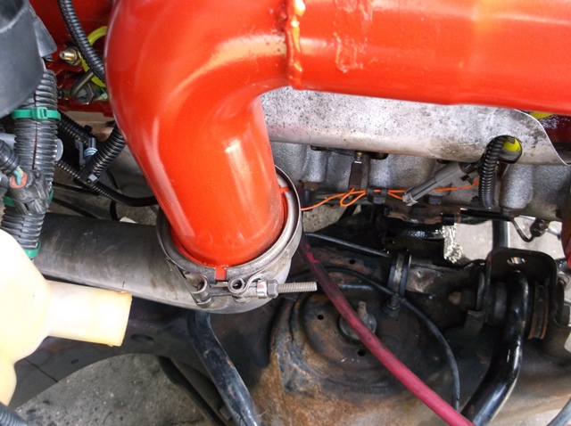

Almost looks like a belt drive blower? Here you can see the Vband clamp set up I used to space turbo away from Alt.
With this set up like it is I should be able to remove the turbo in 20 minutes.
Starting DP mock up.
Painter high temp red to hopefully help resist rusting.
Hooking into original DP.
Look at all that room to service injectors, GPs & return hoses.

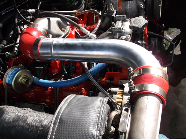

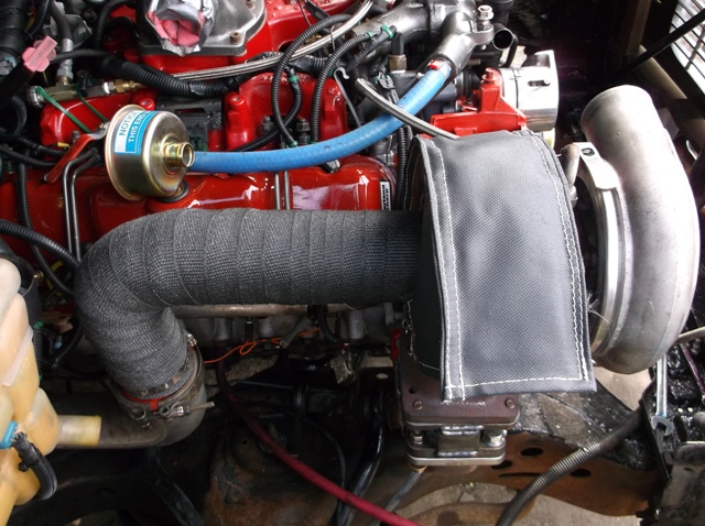

Heat wrap installed and turbo blanket.
Plumbing to intake just about done. I need a 3" coupling and 2 clamps to finish it off.

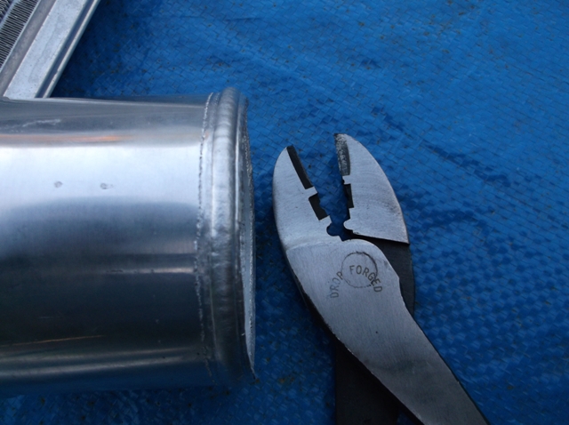

Do your charge air pipes pop off? Life just sucks because you have to pull over and reattach parts on the side of the road? Wife and kids laughing at you? Dropping a load in your pants when you hear that big POP! under the hood?
Well no more! For just $29.99 + S&H you can have the most advance beading tool known to man, but wait I'll throw in an extra pair of regular pliers for free (just pay extra S&H).
Or you can go to Harbor Freight and get some "Linesman pliers" for $7.00

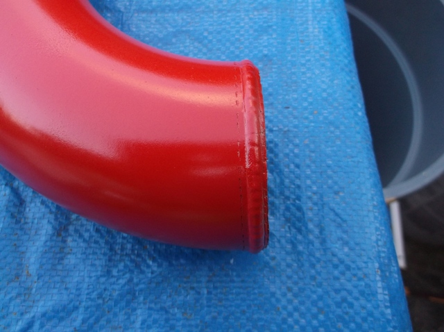

But wait....do they slice and dice too??? :p
