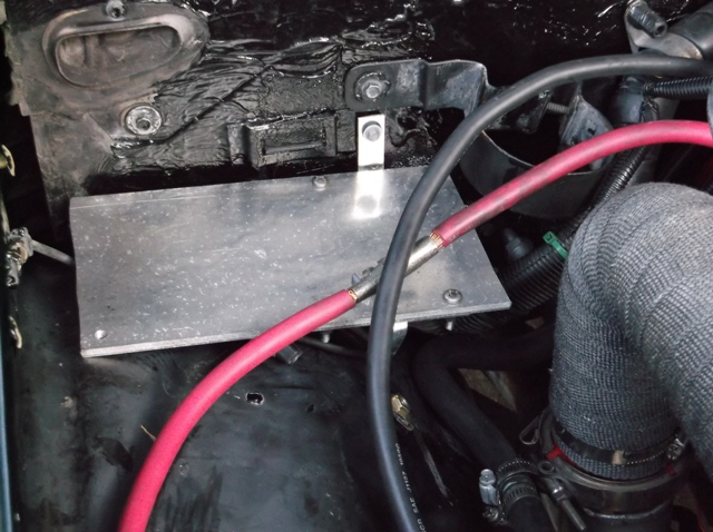

One thing I noticed is how fast the thing turns over while cranking. I made some 1ga bat cables for it, not sure if thats doing the trick?
Should not be a problem, The factory drain would have the same issue too, if there was one.
Thank you. Its raining today, so I'll have to get out between storms to find the small leak before I can drive it. Good news is I can get interior back together even if its raining.
I made 1/0 cables for mine and it cranks a lot faster than before, though like you, I also changed the engine so I can't say with 100% certainty that it's all cables....
IMHO any increase in positive cable diameter/gauge should be complemented extra negative straps from chassis, body & that 6.5td.
Doing so reduces the chance of lots of other problems that may rear their ugly heads at some point. Using a torch to fill void in crimp on cable ends with solder is another important step to eliminated corrosion in there.
Good point. I sealed mine with heat shrink tubing, but solder would have been a more secure seal.
Agreed, I have 1ga grounds from batterys to engine, and 4ga from engine to cab and engine to frame. It is DB2 so not as critical. But this is the fastest RPM on cranking Ive ever had on a 6.5.

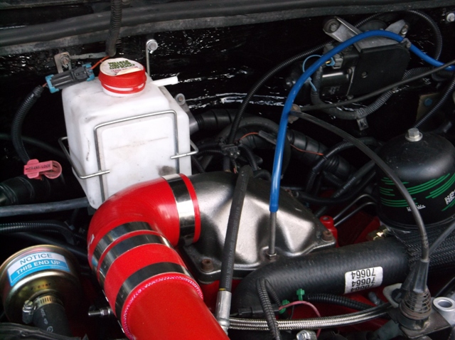

Looks and sounds great Leroy! Did I miss where you relocated the coolant expansion tank? I think I see the filler in the front where the battery used to be, but can't see for sure what's going on up there.
Well, i'm still trying to figure out what to do about that. I'm running the Evans coolant so thought for some reason I could go without an expansion tank...NO Evans still expands :wideyed:.
I had a remote filler neck that you saw, but coolant is coming out.
Part of my problem is the height of the neck is borderline low, i'd like to raise it.
I had an old generic overflow tank I got when I did the Isuzu swap in the Suburban that's not being used. I bolted it up to the firewall today (it bolted up perfectly using two existing bolts). I'm thinking of eliminating the remote filler neck and using the bottle as the filler. Should work better I think. I'll get a picture of it soon. What say you guys?
Since you're running the Evans and don't need to pressurize the system it seems like your new overflow setup is a good idea.
I like your new battery location, nice and tidy. I want to keep my factory overflow so I'm going to keep improving my current battery location. I've thought about fitting both batteries in the front driver location, but that was before I did my remove FMU, so I'm not sure there would be room up there for that anymore.
Should be ok on the overflow bottle, but I just remembered my A/C hose needs that space, so I'll have to find another location for it.
