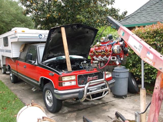

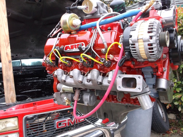

It has the air over hydraulic ram. Sure is nice, I refuse to pull an engine without one.Sure looks good in there. That's one heck of a cherry picker you have.
Oh yeah....that would be real nice!It has the air over hydraulic ram. Sure is nice, I refuse to pull an engine without one.

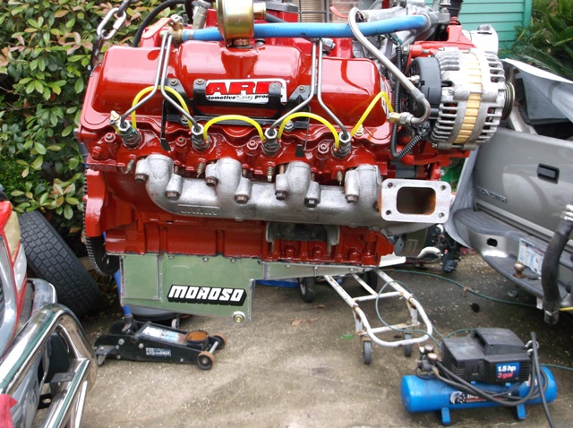

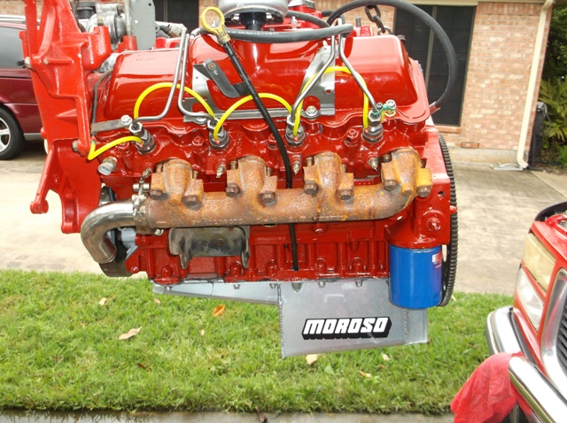

Yep oil pan,Are the oil pans different? Or just a sticker added?
Congrats on the insertion Leroy.![]()
Good news!Yep oil pan,

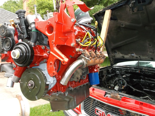

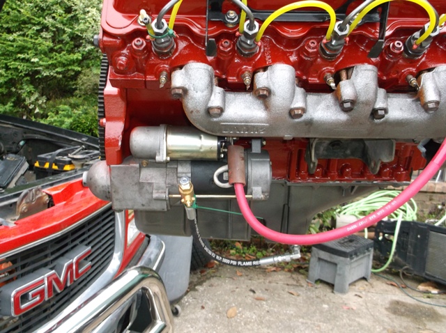

I can now confirm the stock P400 oil pan will not fit in a 1/2 3/4 or one ton 2wd (HD may be different?)
The 4x4 Moroso oil pan fit perfect though.
So now I/we can't call it a Moroso 4x4 pan its just the "truck pan" now. Good thing I had one in stock.

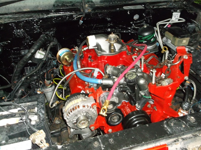

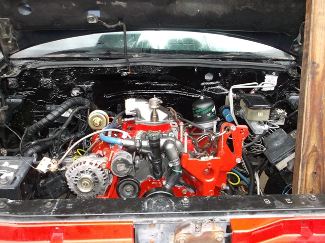

Yesterday I thought the engine was hitting the trans as it could not set down, then ran out of light for the day and rain.
This am I moved the trans back and still could not get engine to set down! It was hooking on the motor mounts then trying to rotate the back downwards, but it would hit the oil pan on the crossmember. New pan fixed it right up.

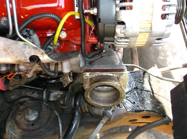

Now still working between rain I can get all the small jobs done to botton up the install.
The turbo system will be a challenge now that I can see how it sit in the frame rails. Also the driver side manifold is interfering with PS pump.
One small step at a time though.
