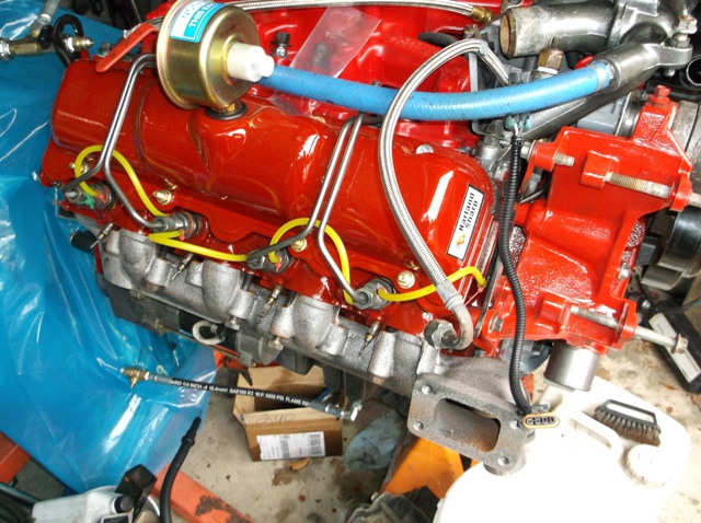

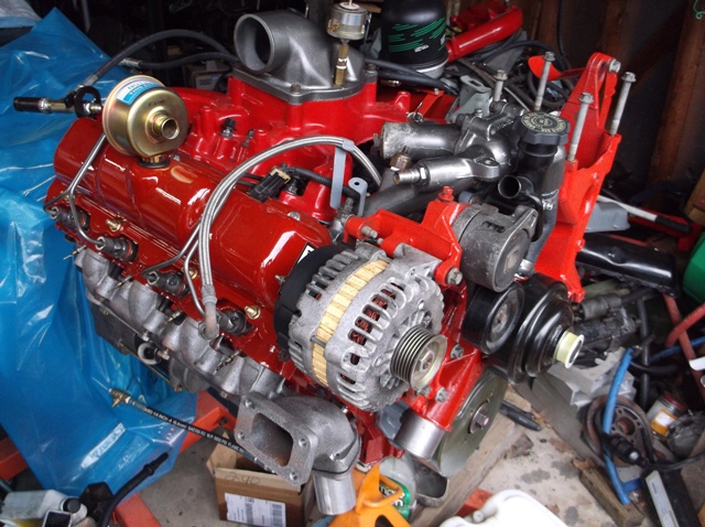

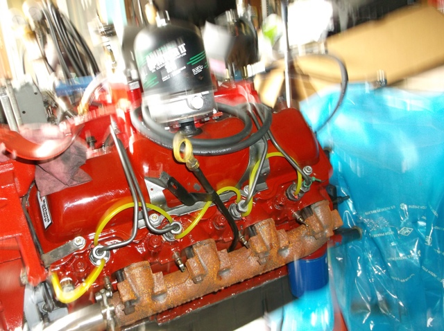

Finally some real progress. Got a lot of the small stuff done today. Ip installed, New injector lines installed, Intake, return lines, starter installed. Got some more parts cleaned up in the "fish fryer" You guys need to try that, you'll never clean parts by hand again. Parts come out ready to paint a lot of the time. I shoot them down with carb or brake cleaner to remove any oily residue before painting.
I found that I cannot use the single tstat crossover it will interfere with throttle cable bracket (bummer). So Nate I'm going to copy what you did and put a plug in it to restrict the flow on a dual tstat.
