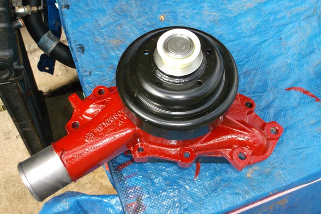

That looks really good. I'm going to try threading one to the outlet on the crossover when I put mine together.Small progress. Got water pump painted.

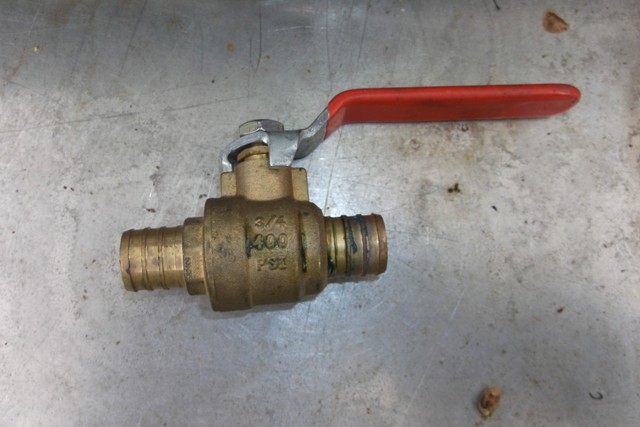

Here it the ball valve I was talking about.

I think it was Lowes, but Home Depot should have.Leroy, that is SOOO perfect. Where from home depot or something?
That would be a good place, when I get to that point I may do that too??That looks really good. I'm going to try threading one to the outlet on the crossover when I put mine together.
