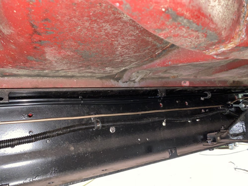

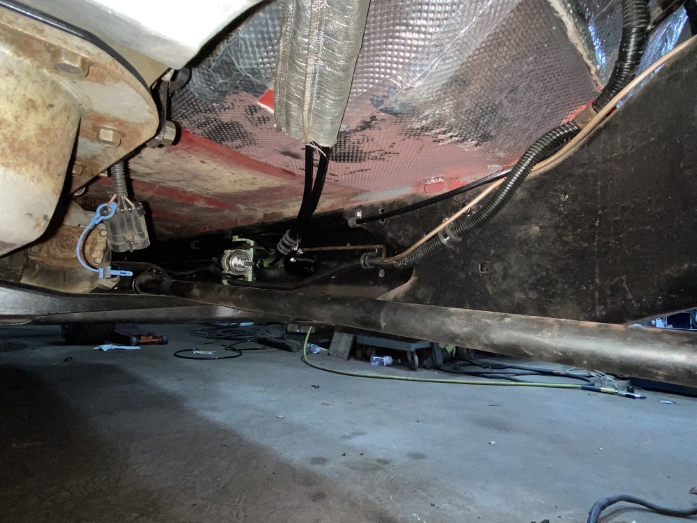

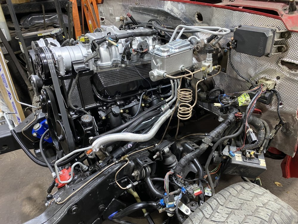

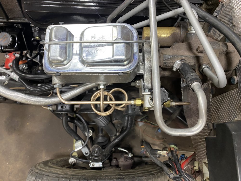

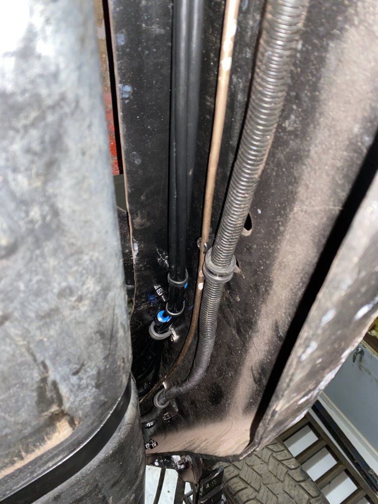

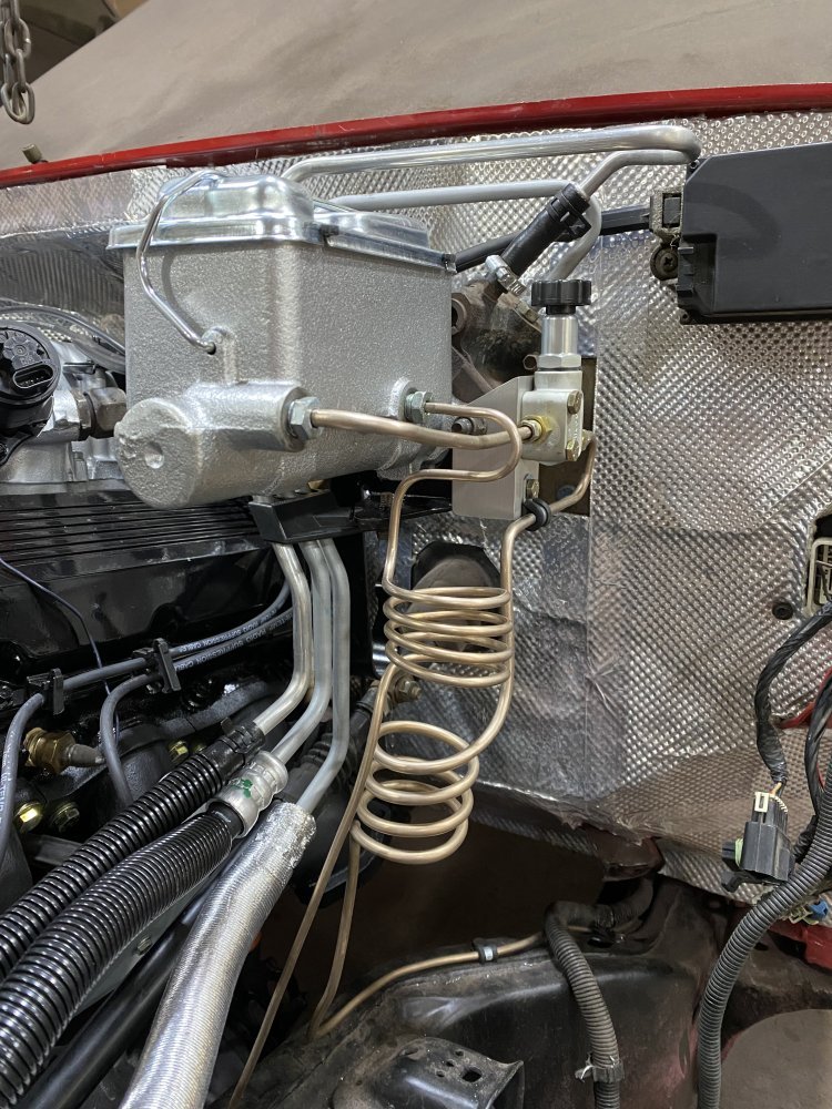

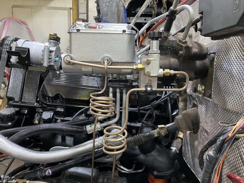

where did you source the coil you put on the brake lines?
I’m pretty sure I got it from The Stop Shop, but I’m not seeing it listed on its own. I bought it a couple years ago.where did you source the coil you put on the brake lines?

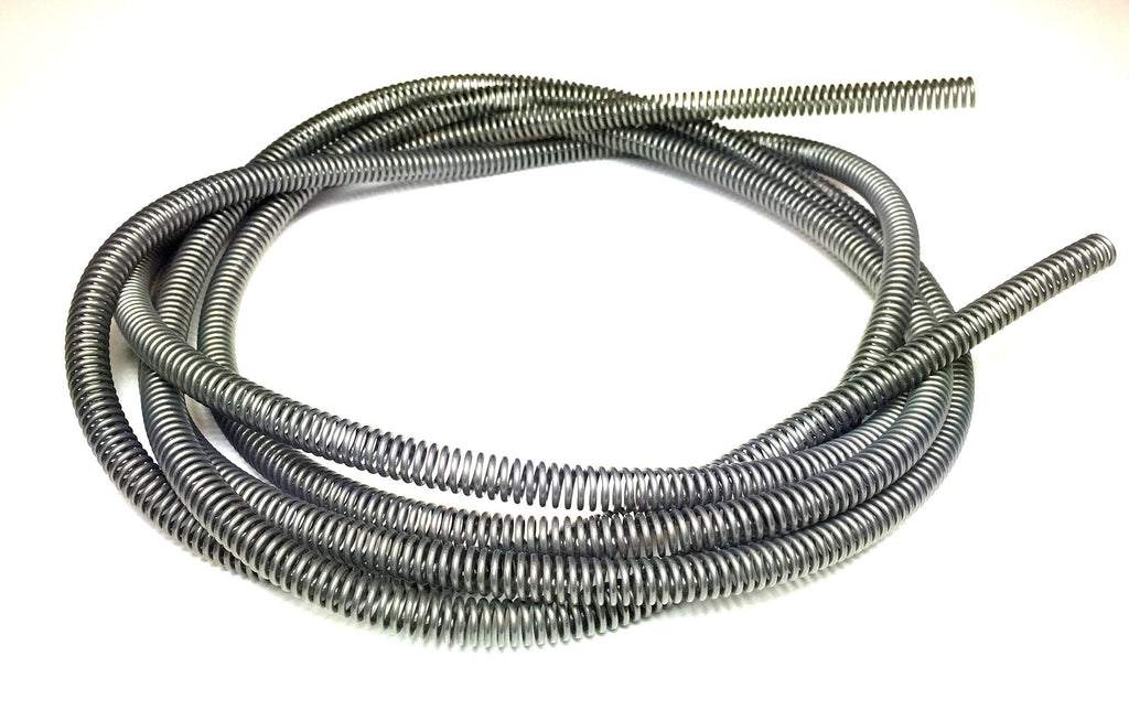

Yup, that’s it.this it?
Brake Line Protector (Gravel Guard Spring) for 3/16
Gravel Guard brake line protector shields the outside of the tube to protect against rock chips. Made from 304 stainless steel or Galfan coated steel.www.thestopshop.com
I am using that kit. That’s an interesting idea.Are you using the Dorman wire kit for the upgrade 4x? If so run the brown wire to a dash switch then he can have low range 2wd. Really nice for backing trailers on inclines and such

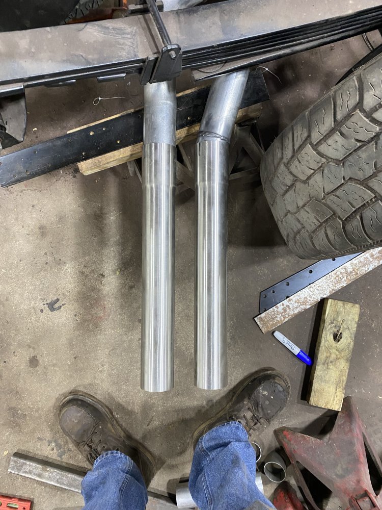

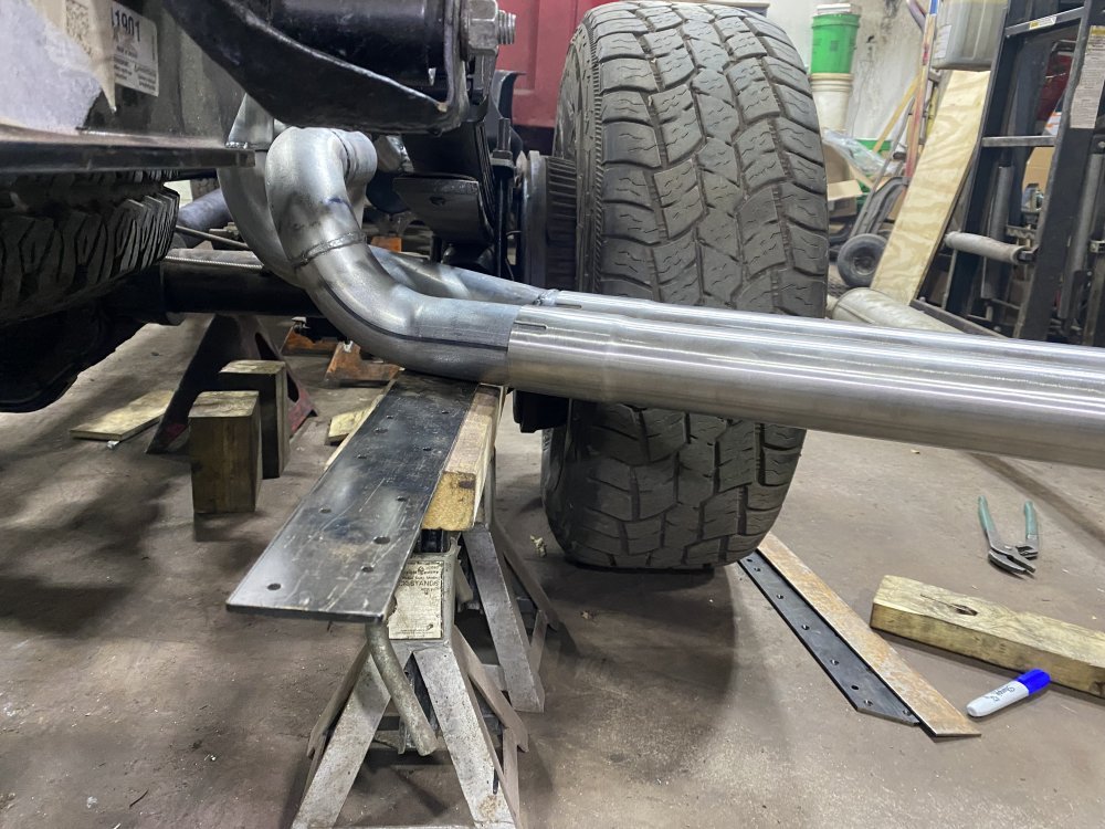

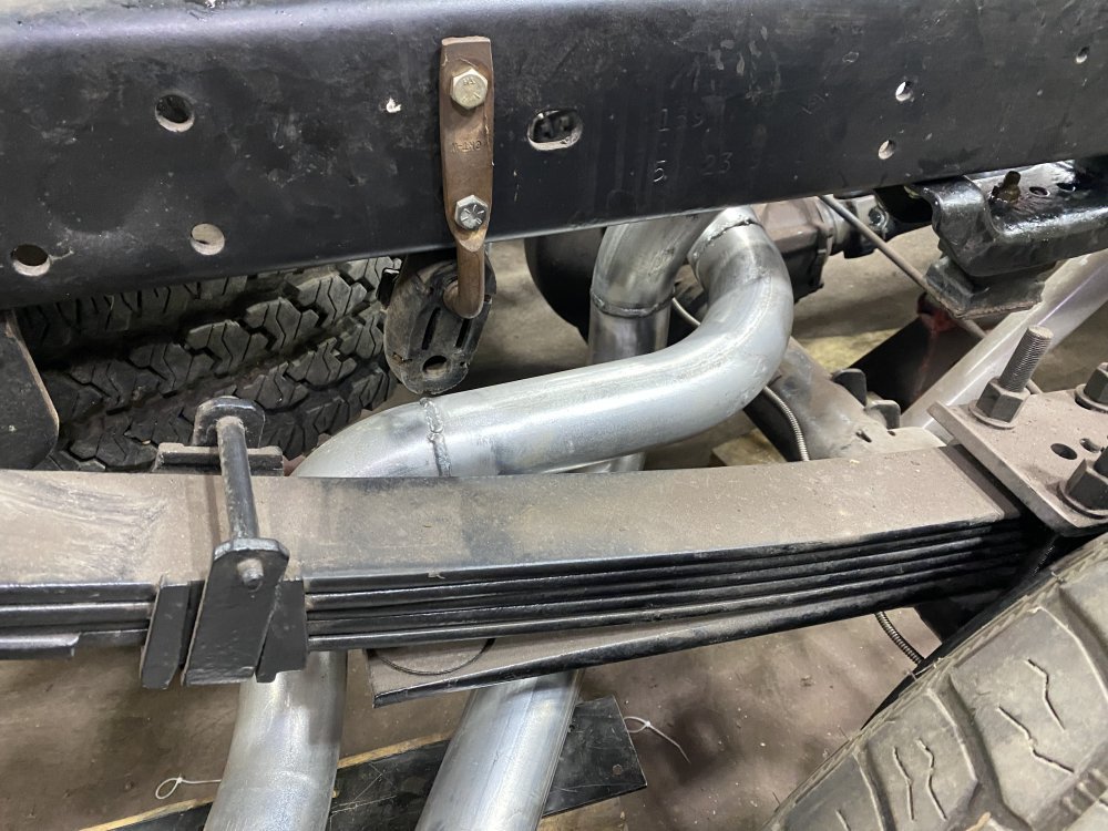

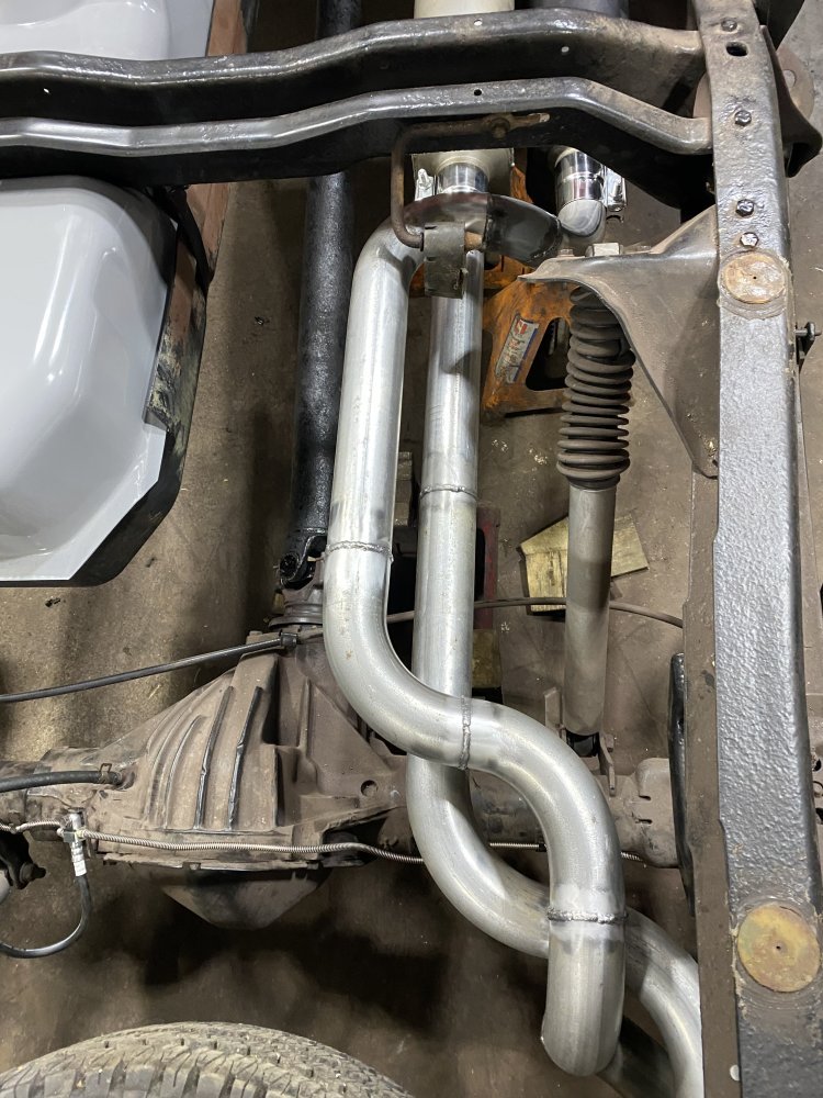

Holy Bowl of Spaghetti Pipes, Batman!This weekend I got the exhaust mostly done.

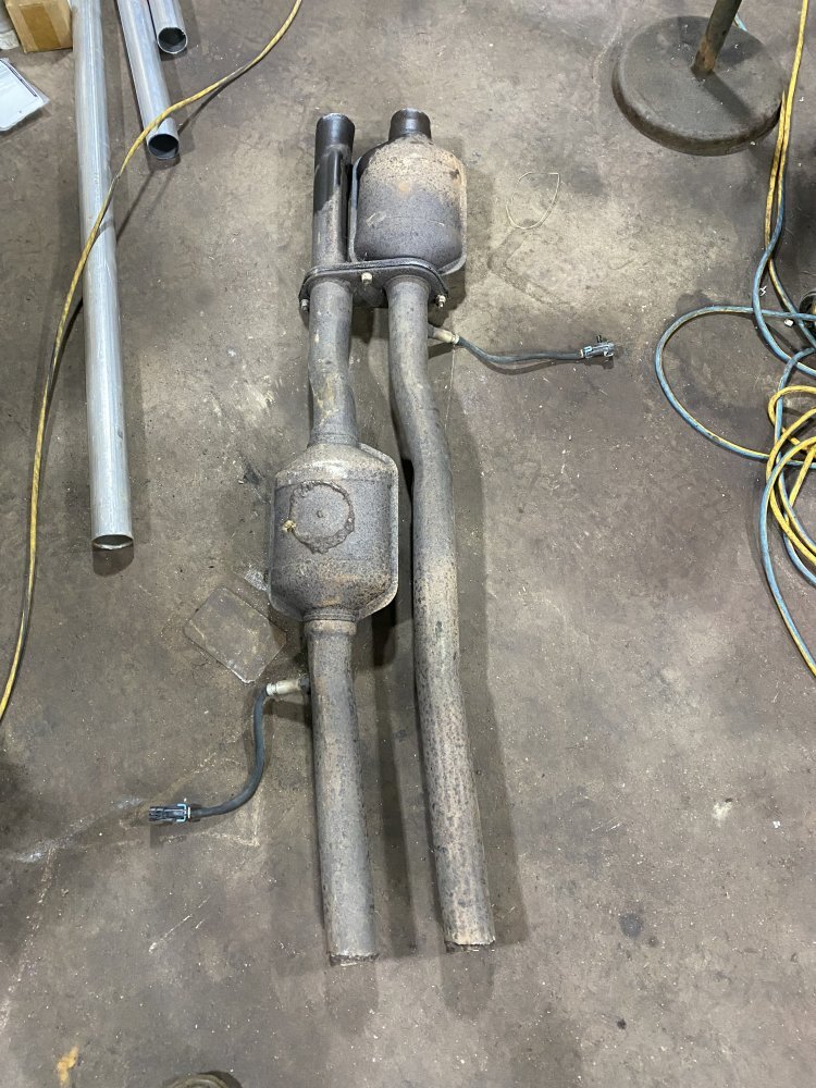

I started by cutting the 280,000 mile factory cats and pipes off of the head pipes. As you can see, one had surgery in the past and wasn’t doing it’s job anymore, so might as well finish the job and reduce the future places to leak. This truck is supported by HP Tuners, so I’m going to turn the rear O2 sensors off using that so we won’t get a Check Engine Light.

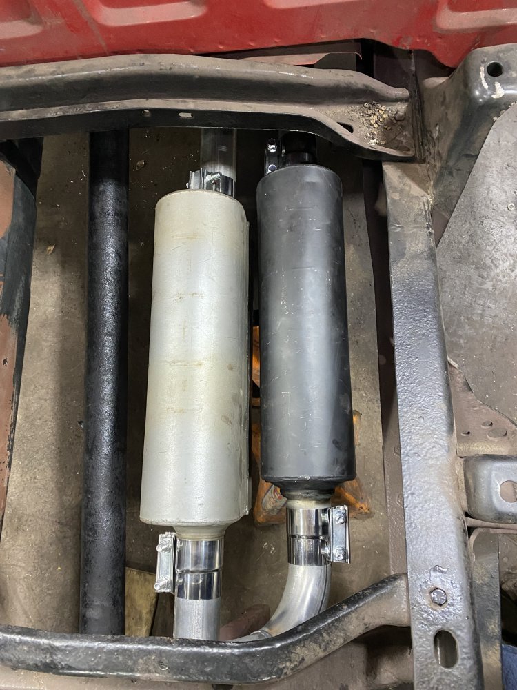

I had a couple Flowmaster 50 SUV series mufflers already and they were perfect for this truck. The silver one is stainless with 2.5” inlet and outlet. The inlet was conveniently offset to help me get the outlet tube up over the axle. The black muffler is carbon steel with 3” inlet and outlet. Since I needed to put a jog in the tube to get around the shock anyway, the center inlet and outlet were fine. I cut off the inlet and outlet tubes and welded on some 2.5” muffler tubes I had in my pile.

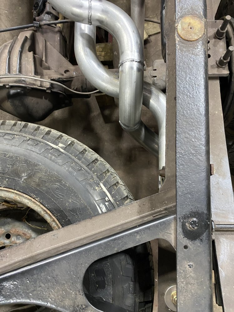

My dad wanted true dual tailpipes that both exited on the passenger side in the stock location and wouldn’t interfere with a spare tire. This made the routing a little tricky, but I made it work. It took four and a half 180 degree mandrel bends and about half of a 45 degree bend…..a fortunate quantity because that was the exact number of bends I just happened to have already. It may look a little unconventional, but it achieves everything wanted and needed. The stainless pipes on the end will be trimmed to length once the bed is installed so we can make sure they look correct. Not sure yet if they’ll be straight or slash cut yet - we’ll determine that when we get to that point.
View attachment 89830View attachment 89831View attachment 89832View attachment 89833View attachment 89834
Yup, a start of a bundle of snakes for sure.Holy Bowl of Spaghetti Pipes, Batman!
Looks like two anacondas trying to mate!Yup, a start of a bundle of snakes for sure.
