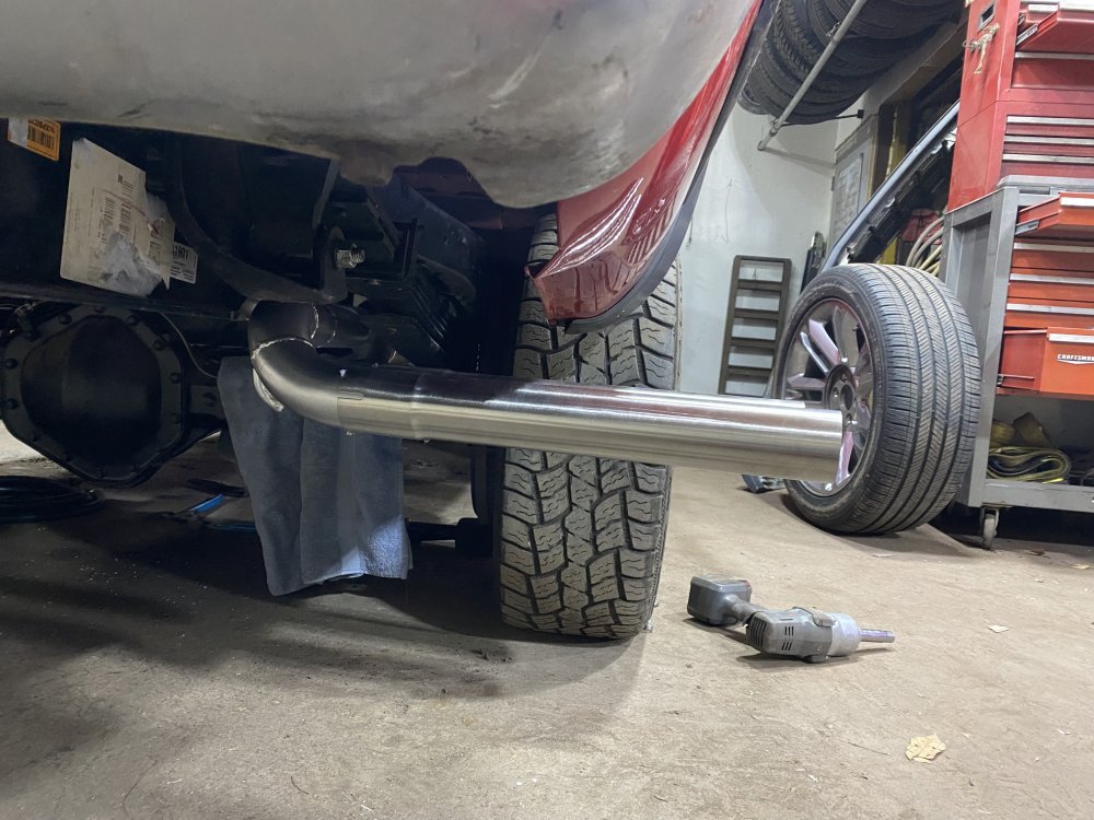

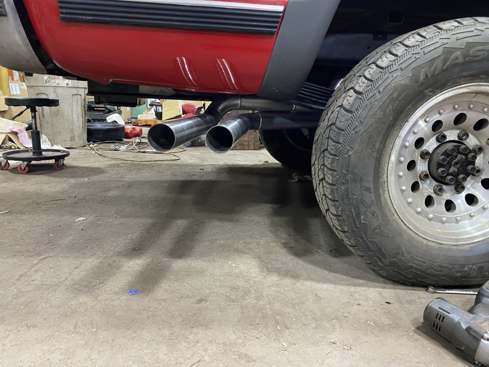

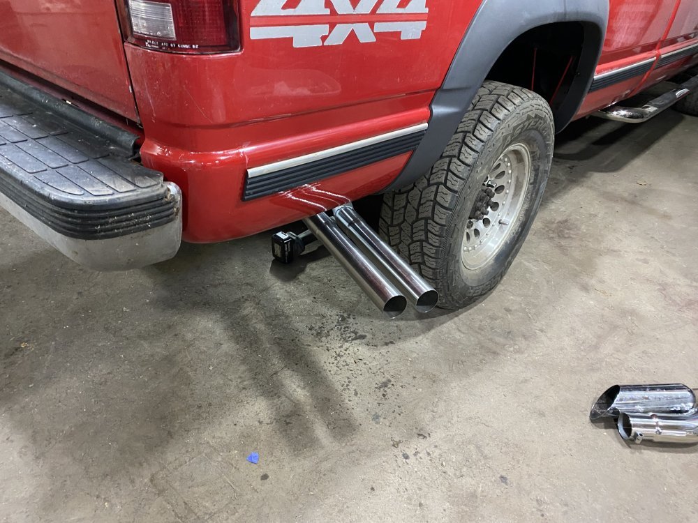

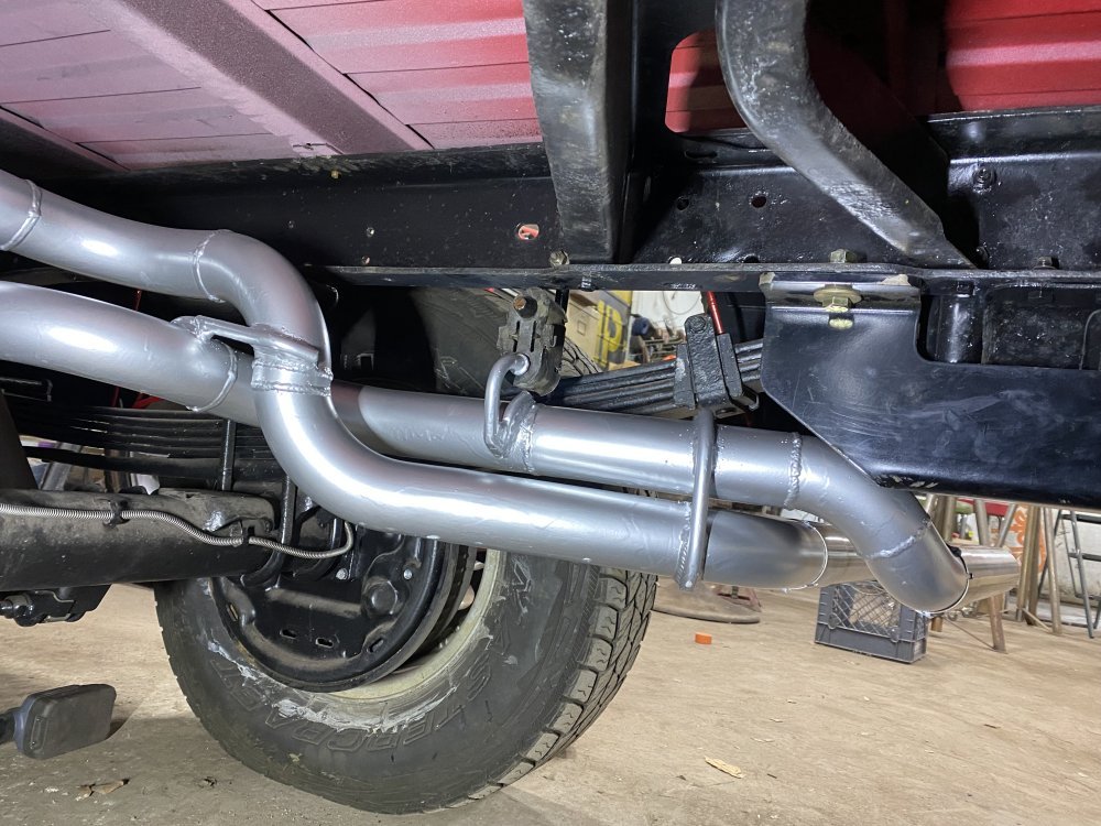

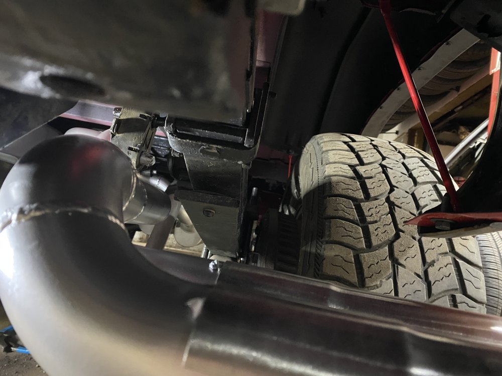

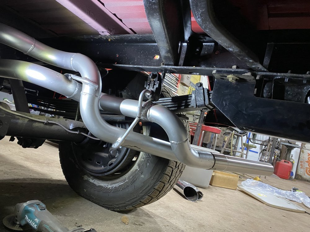

Monday night I was going to make the exhaust tips. My dad had bought some 2.5” stainless slip-on tubing, and the idea was I would cut them to length and clamp them on once the bed was installed. I slid them on and realized I was very unhappy with how far from the bed that the pipes were. Though I didn’t like it, I also didn't want to rework the exhaust, so I figured I could probably find some larger tips to make it look better. But then I decided to check the clearance between the exhaust and the spring when the axle drooped to see if that would sway my thoughts. Holy crap, this axle droops a TON and the spring was resting on the tailpipe big time. Damn. So that clinched it, time to redo the tailpipes. Here are some shots of the exhaust as it was Monday night. The stainless pipes are installed to help judge heights/distances.
I’ll show the final results in the next post.

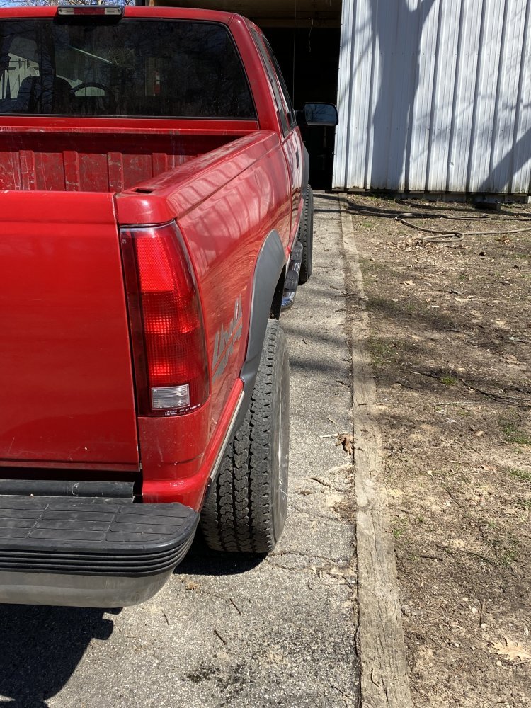

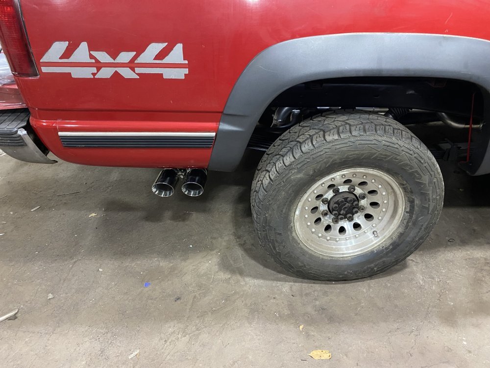

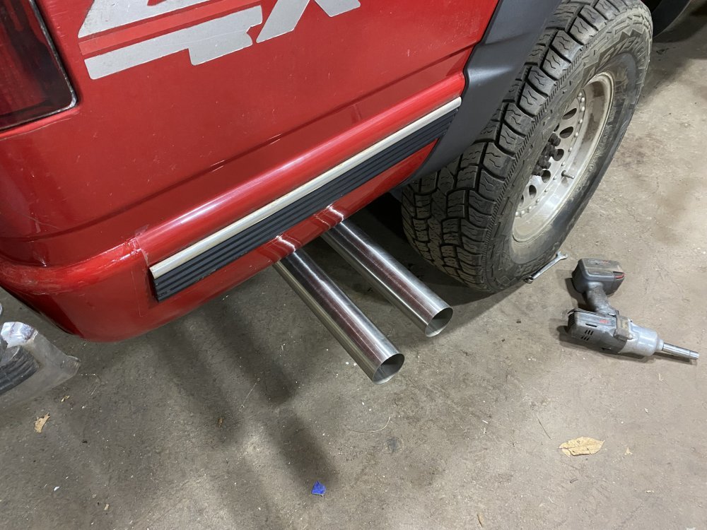

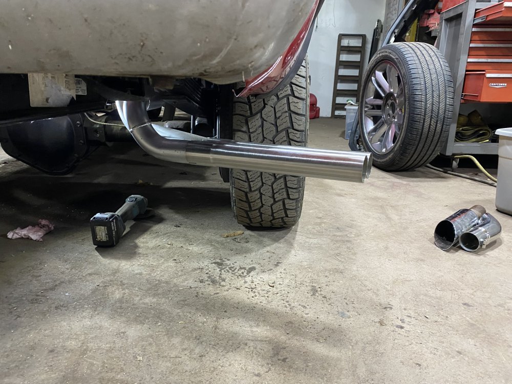

I got the pipes finished up the other night and finished painting them today. I managed to raise the pipes just shy of 2 inches. I would have liked to get them a little higher still, but it was challenging just to do what I did with all that was going on in that space. Good news is the spring no longer hits the exhaust and it looks much better than it did. Here are pics with the stainless pipes on for comparison purposes.

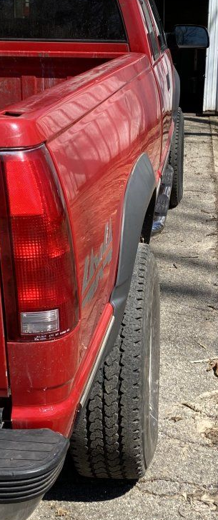

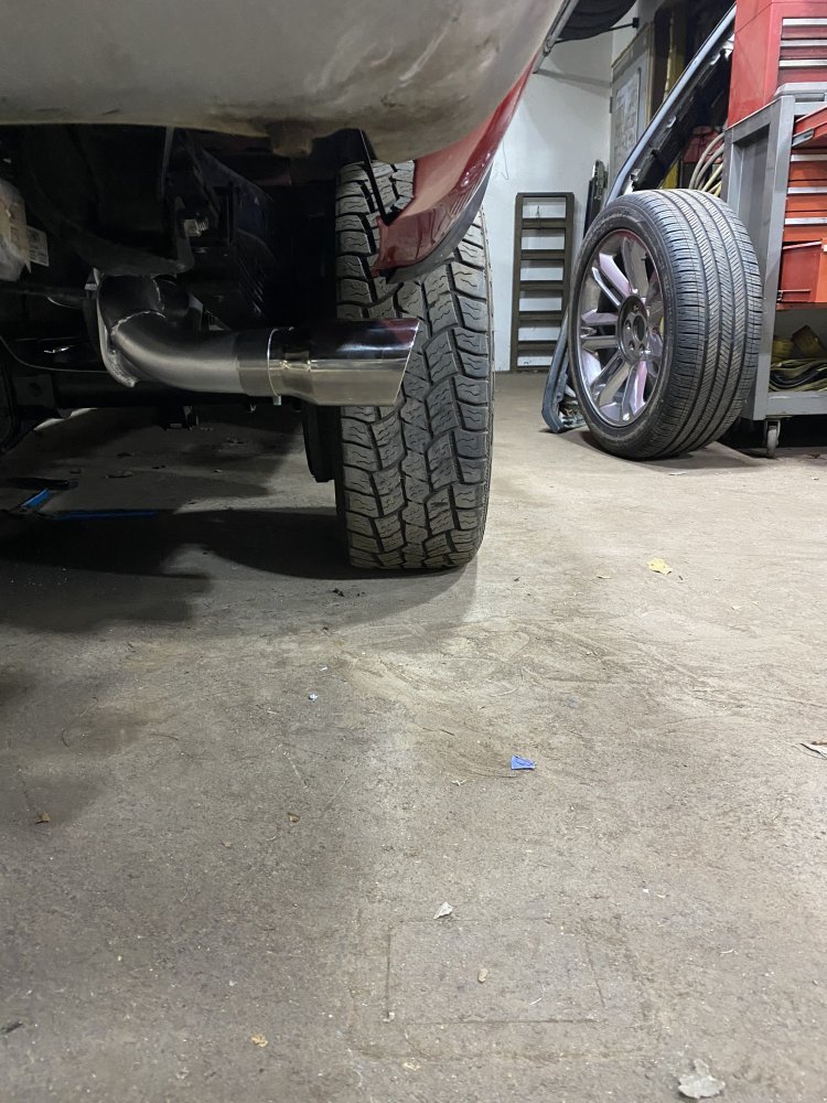

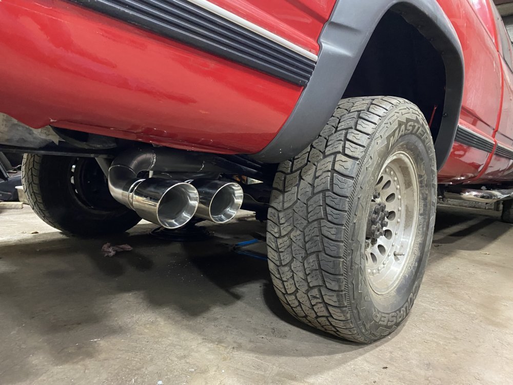

And here’s the finished product with some 3.5” tips off Amazon that help fill the gap a little nicer. I’m happy overall.
It sounds pretty decent, too. Gotta love true duals.

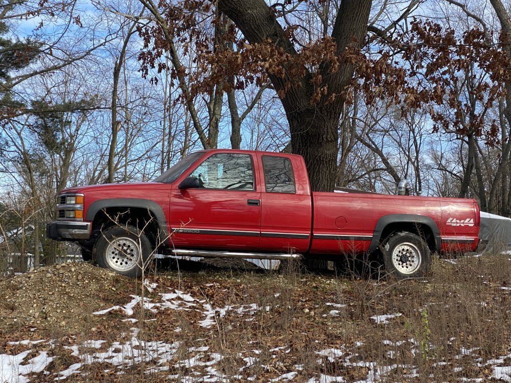

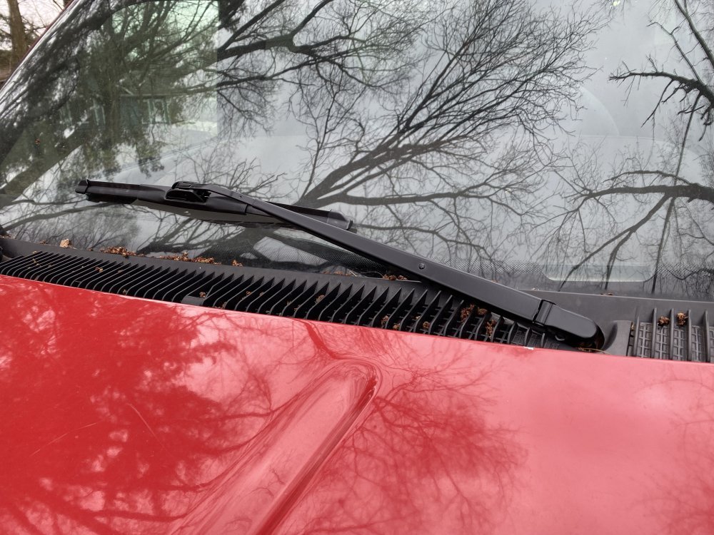

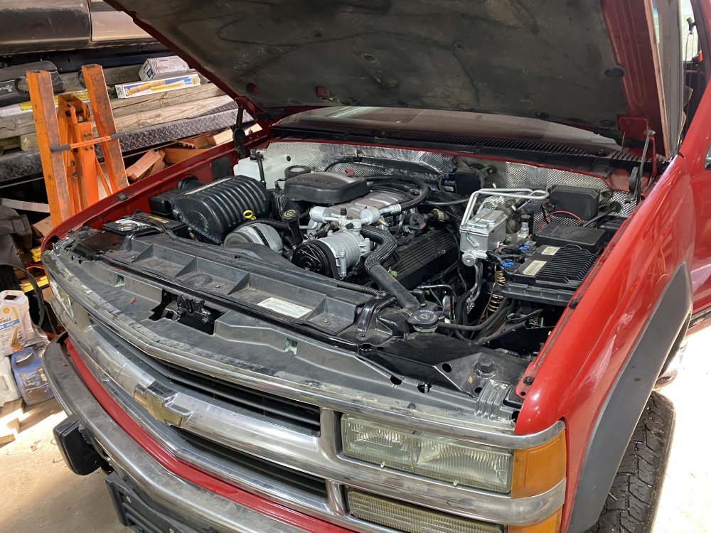

Thanks guys! I dug out the hood and put it on. I need to find a new one - this one has a rusty substructure and dents - better to just replace than repair. I might have another good one to use, but I’d rather find another red one.
Now it’s done until dad is ready to drive it in the spring - just needs tires, alignment and charge AC. I hope he drives the puss out of it next year.

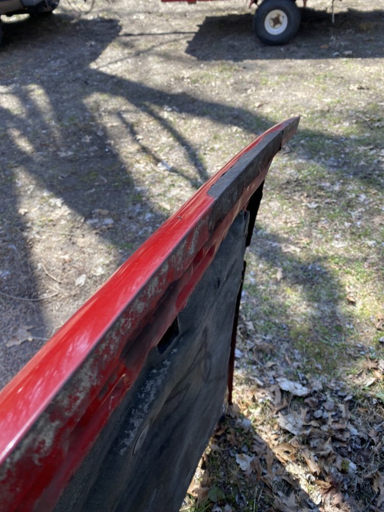

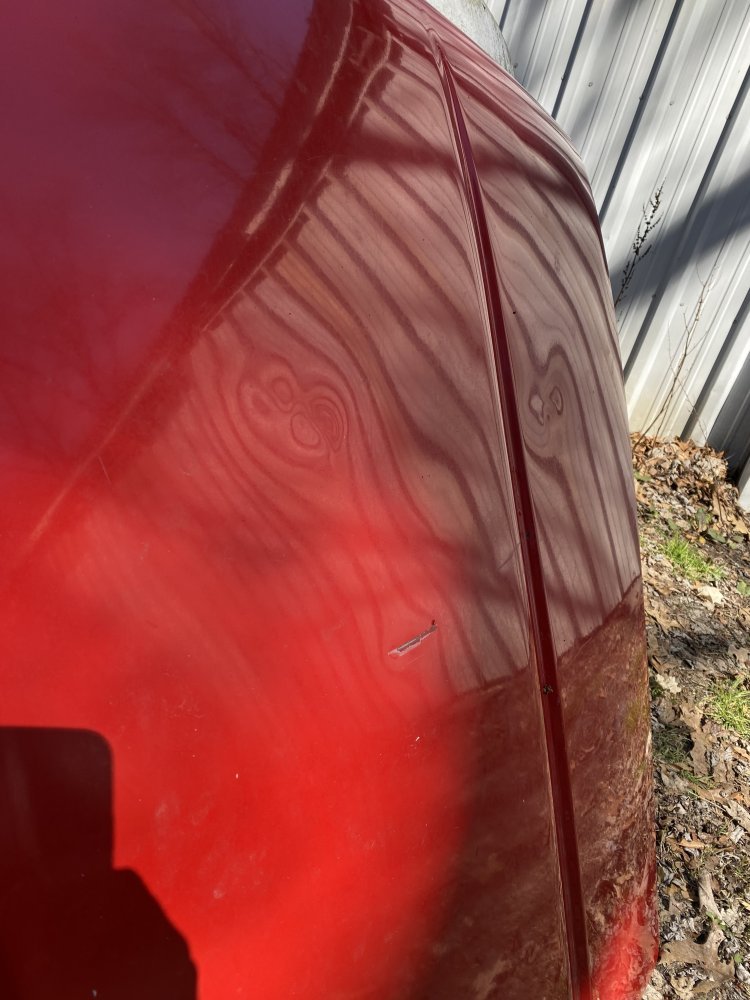

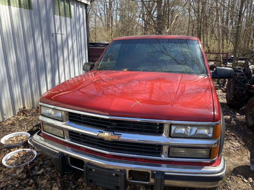

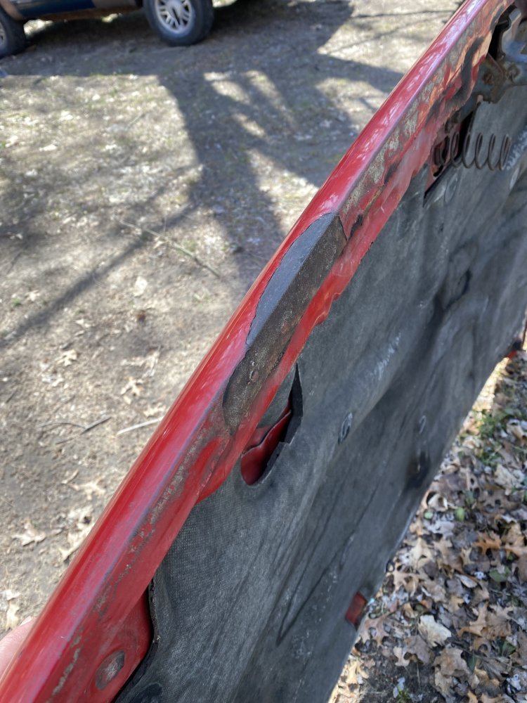

Today my brother and I found a pretty good hood at the junkyard for the truck.
The original one had a bunch of dents and rust that really detracted from the overall truck.

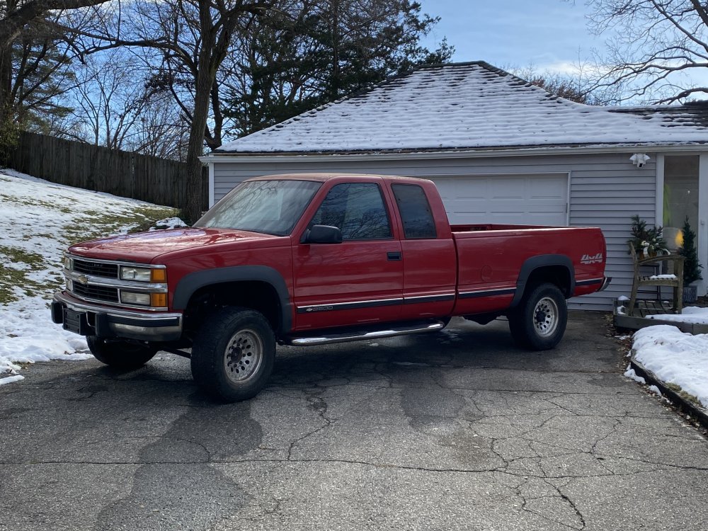

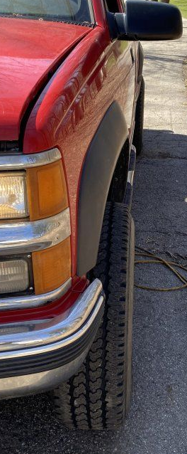

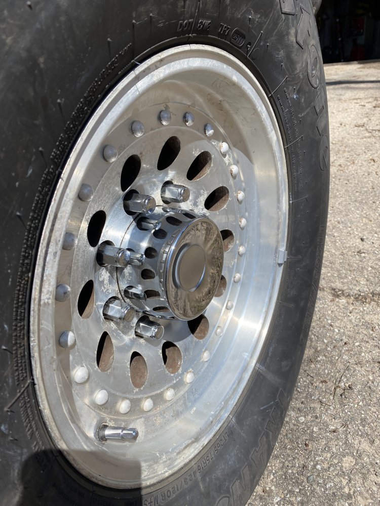

I took off the tires that were on the wheels and mounted some 265/75s. I also mounted some 2” spacers in the rear so the track widths matched front and rear.
Installed with the chrome lug nuts dad bought and some chrome center caps I found on eBay.
The truck is going for an alignment this week and then I’ll put some paint on the front suspension bolts that are still bare metal (I left them that way knowing they’d get wrenched on during the alignment). After that, it’s dad’s to drive!
