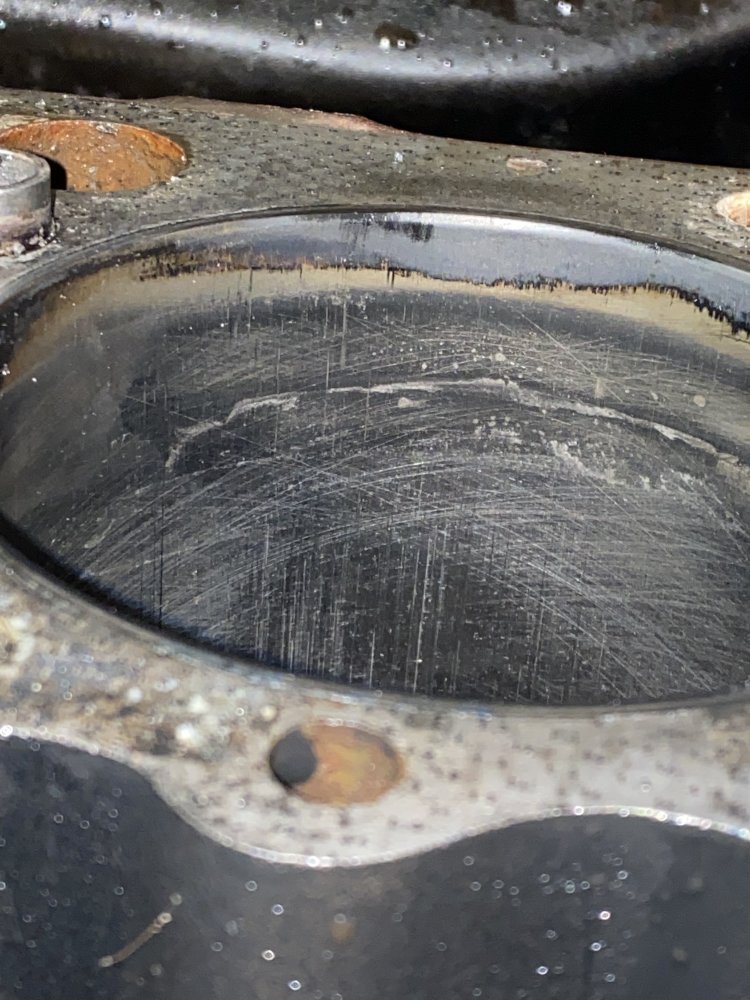

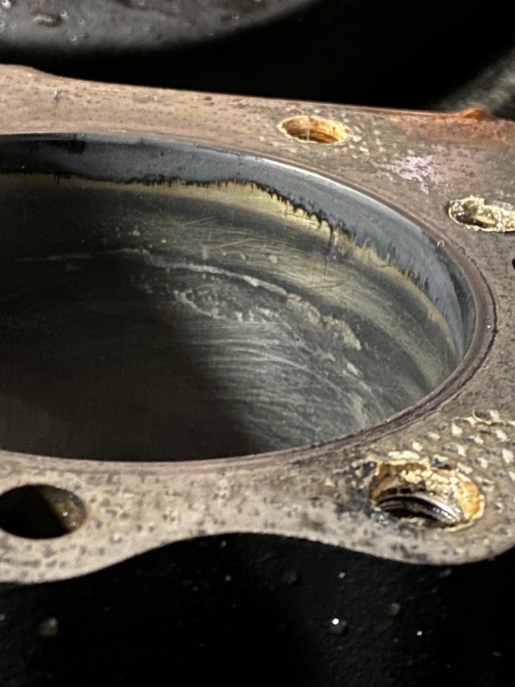

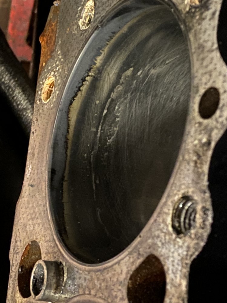

Yeah. Sucks. Definitely not what I needed to deal with right now.Ouch that's a kick in the balls! Hopefully its not a crack and you can fix it with some oversized pistons... it would be cool to try the 6.2 sleeves in a 6.5 block we had talked about. But im sure you need to save money for the square body project.
Yeah, and I think I abused it with the high drive pressure and EGTs. I should have swapped the turbo much sooner, though I think it was first hurt at the Ohio event last year and that was when I was still shaking down the 62mm HX40.In all fairness to the Optimizer, that thing has held a lot of power for a long time.
I have other blocks I can use, but yeah, I’ll definitely not throw it on the scrap pile. I’m curious to see if the mains are still intact.Dang man. Well, one sleeve isn’t too expensive?
