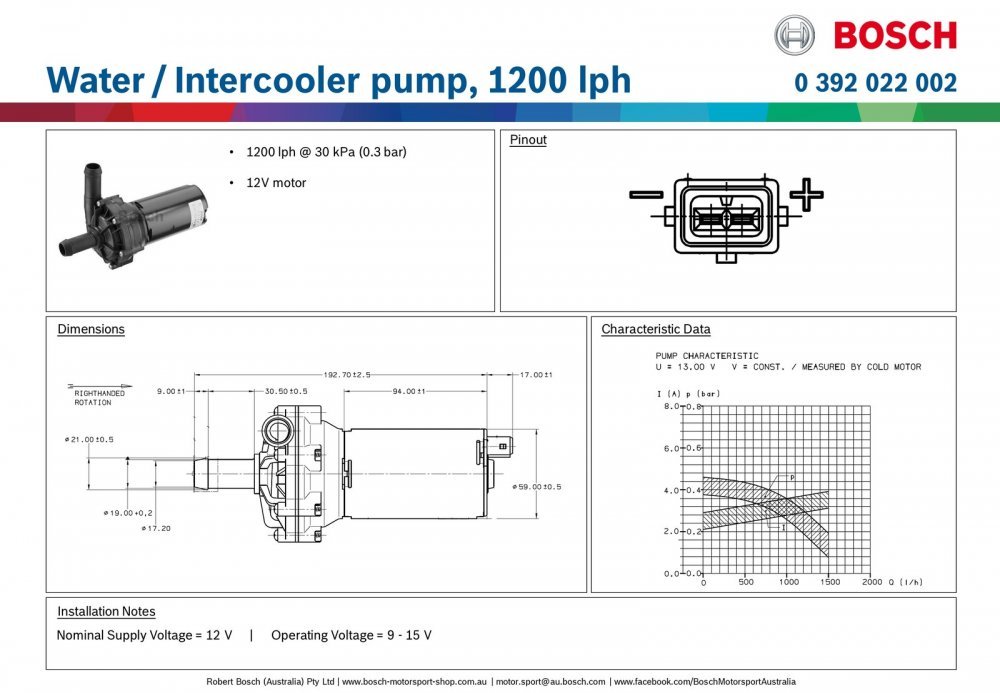

N8IN8OR have you ever thought about upgrading the water pump that supplies the intercooler?
think you used this Bosch 0392022002 for the system, from the few data found I think it is insufficient to create a consistent flow towards the intercooler, especially on WOT
the rate of this pump is 1200 lts/h (20 lts/min) but @ 30kpa (0.3 bar - 4.35 PSI) only
this makes me think that a pump with better characteristics should be used

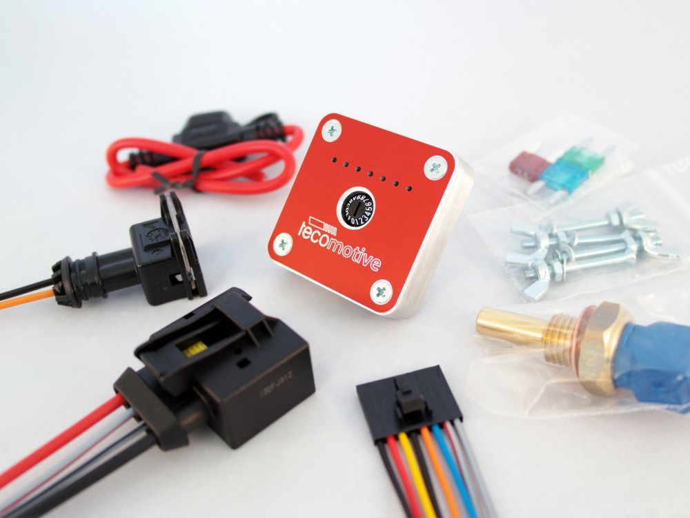

instead of a simple PWM those pump can be very well managed by a dedicated module that manages the pump according to the set temperature, there is a kit prepared for installation (includes the module, connector, and sensor, fuse) install it, run the setup and you can forget it. point against perhaps only the price vs few dollars PWM

beauty of these electronic pumps is that they can stay off/standby during engine warmup, can use very little amperage during idle or normal road use, and jump to high amperage/flow when required
