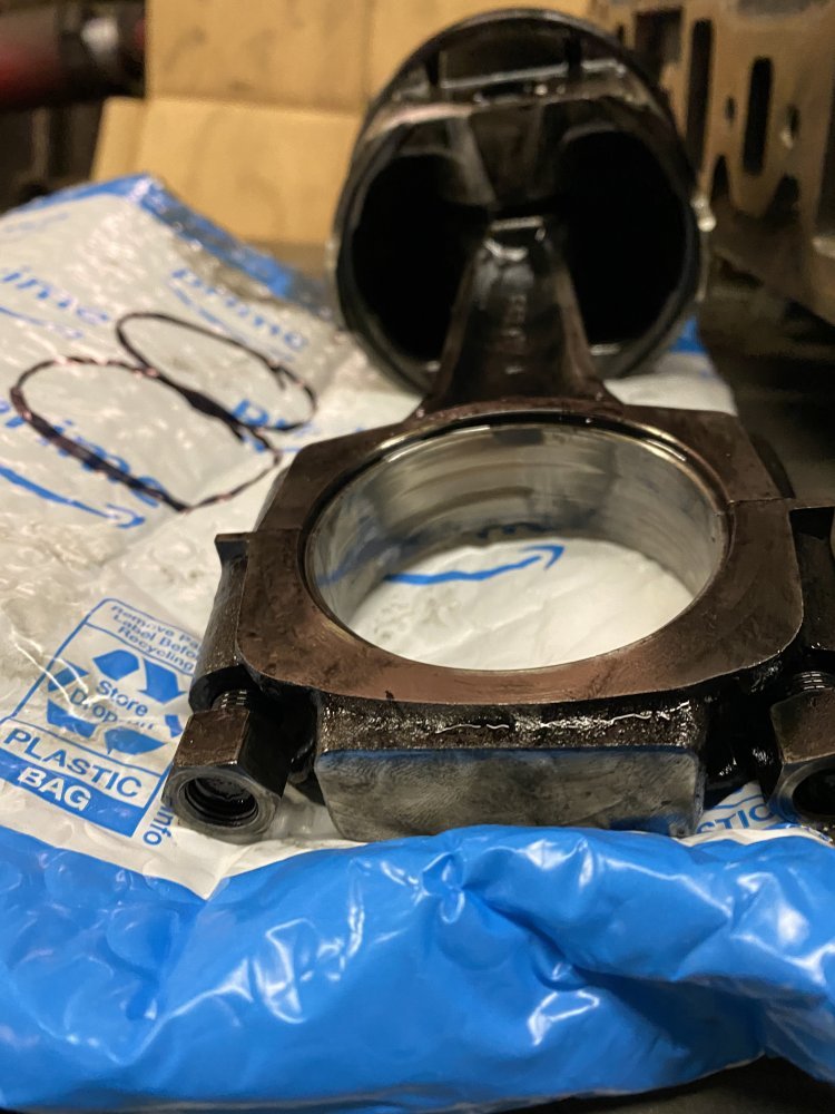

I finished getting the short block torn down this evening. Still no main cracks, which really kind of surprises me, but maybe that DSG girdle was doing its job? Plus that girdle adds studs in those outer main holes, so that would be a second benefit, versus the stock bolts. I took everything apart pretty quickly since I was trying to get it all done tonight (I want to be ready so if the shop calls and says they’re done with my heads then I can take the block with me when I pick them up), so I don’t have a lot of other observations to share. So far all of the pistons look good. One other thing I did notice is all of the upper shells of the rods are worn in a narrow band, so they were apparently seeing a lot of cylinder pressure….. I’ll clean things up, inspect and take pictures in the next couple days.

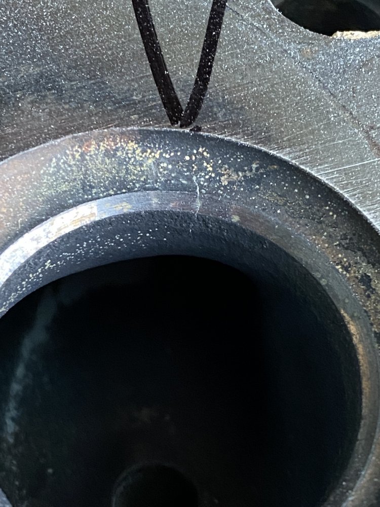

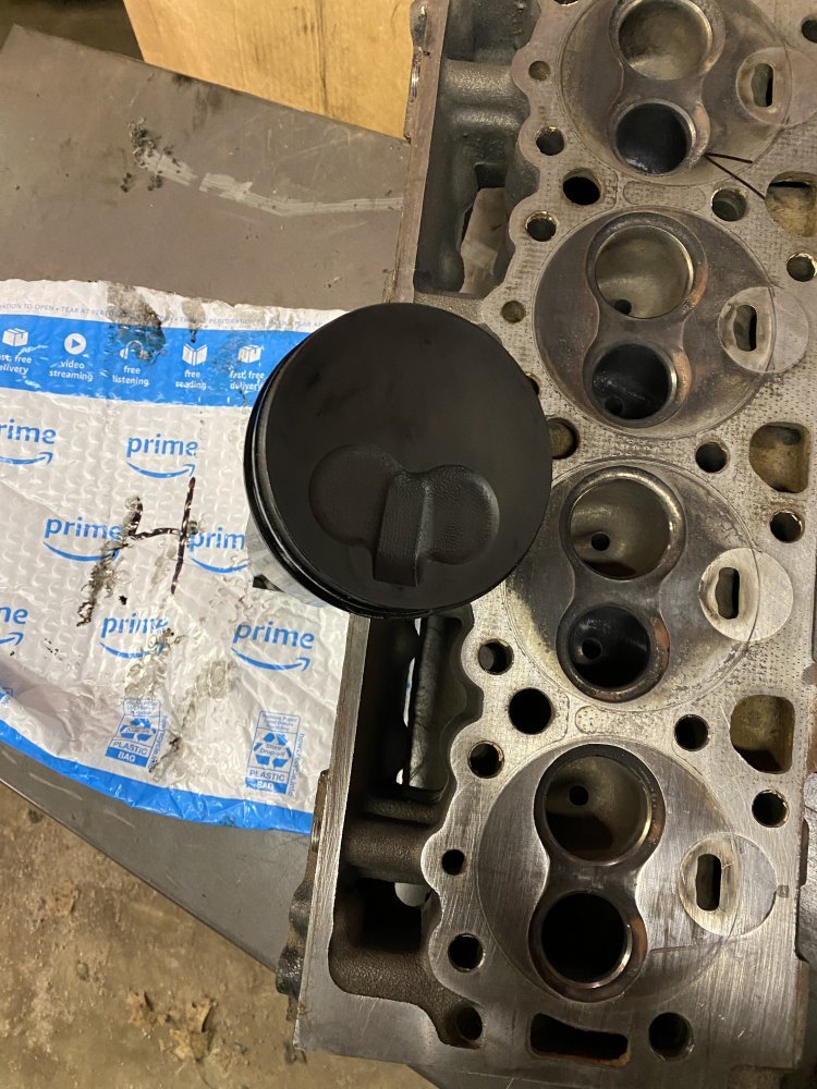

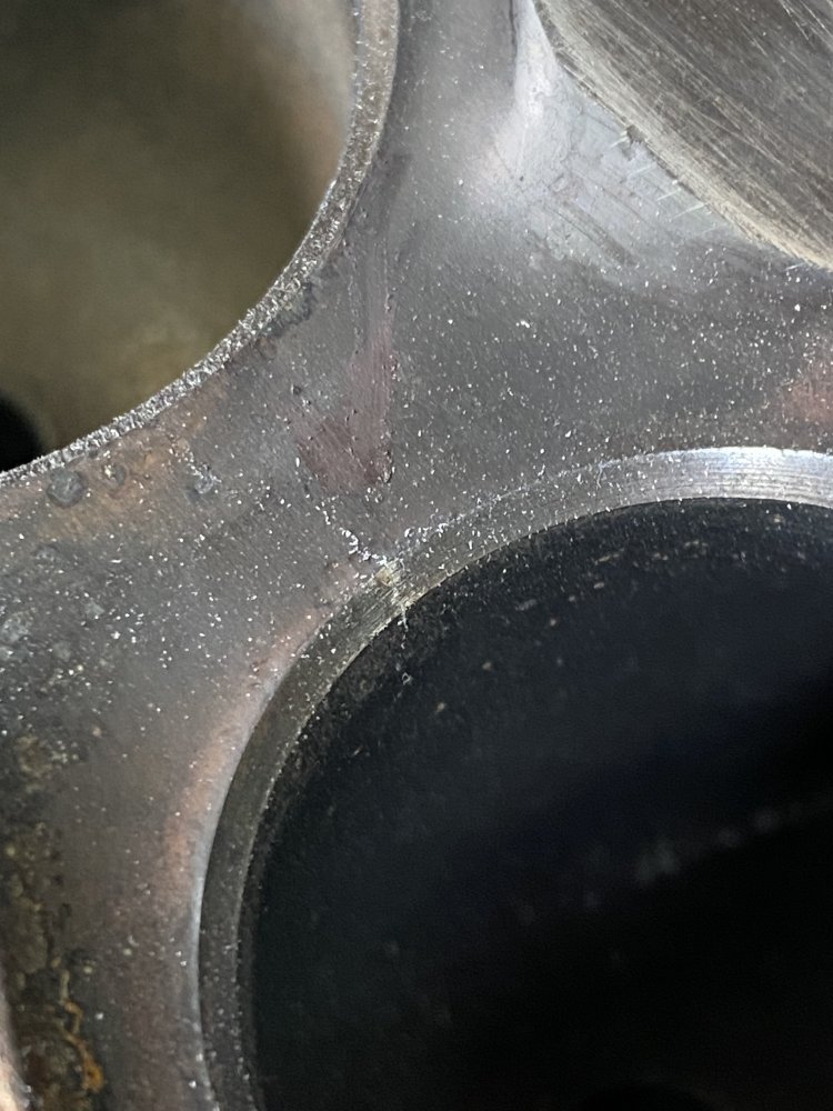

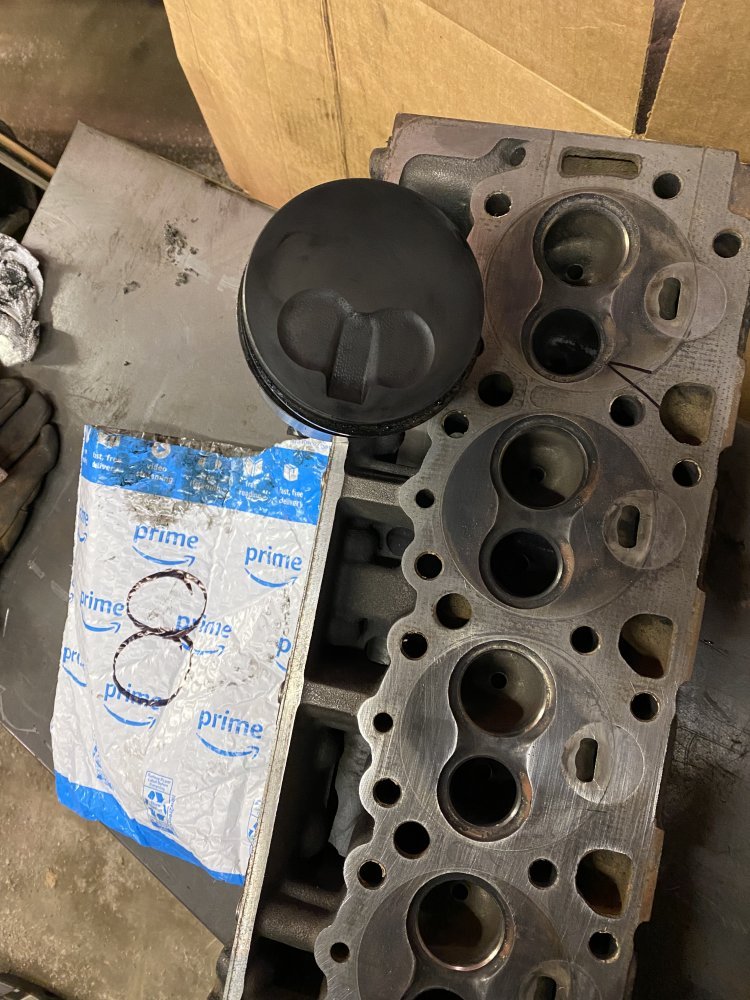

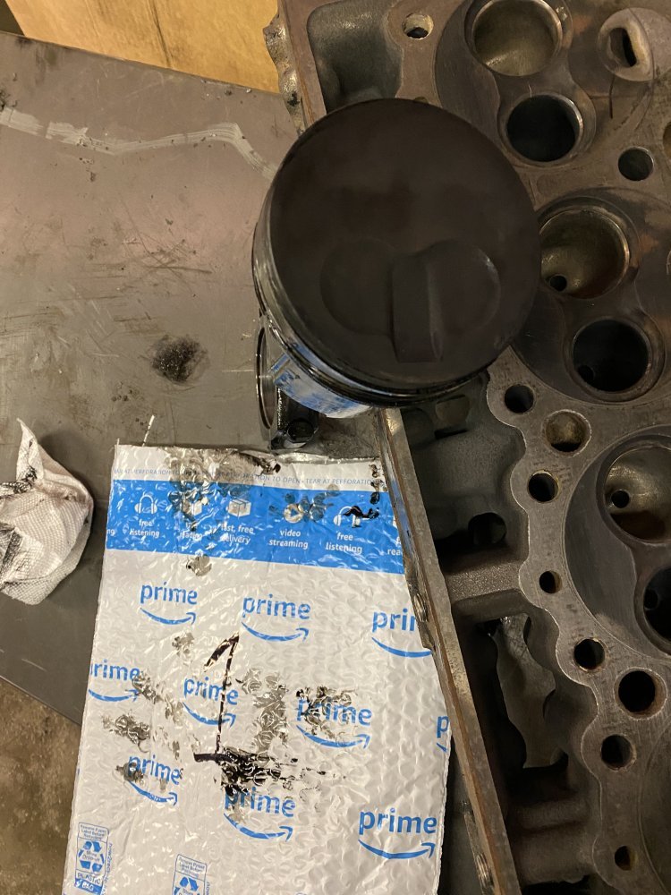

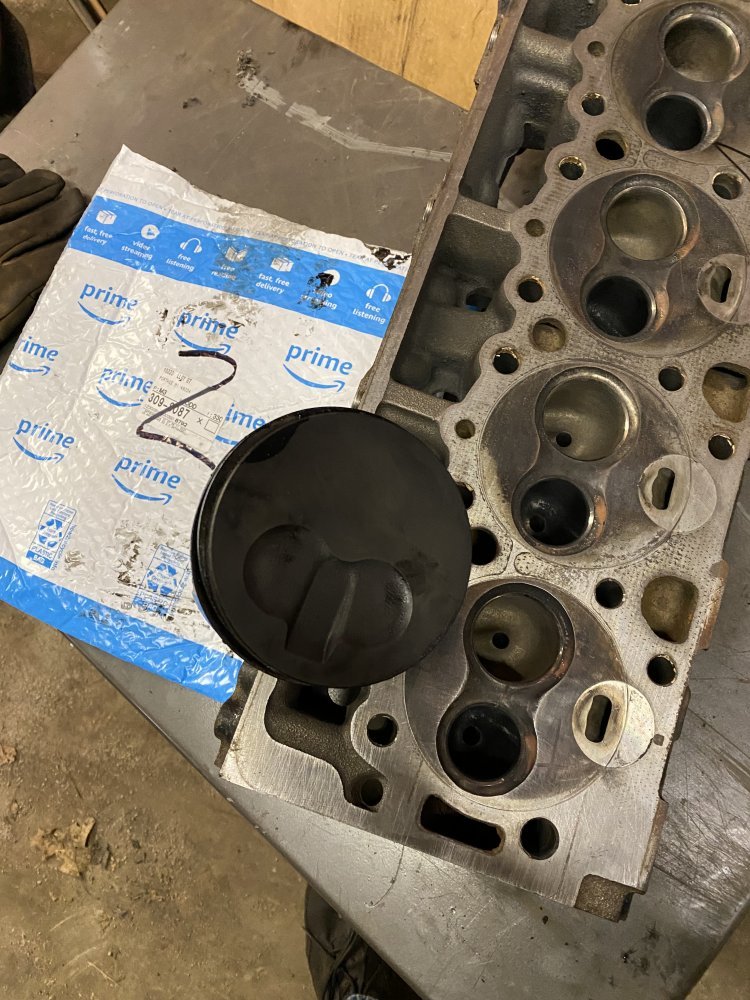

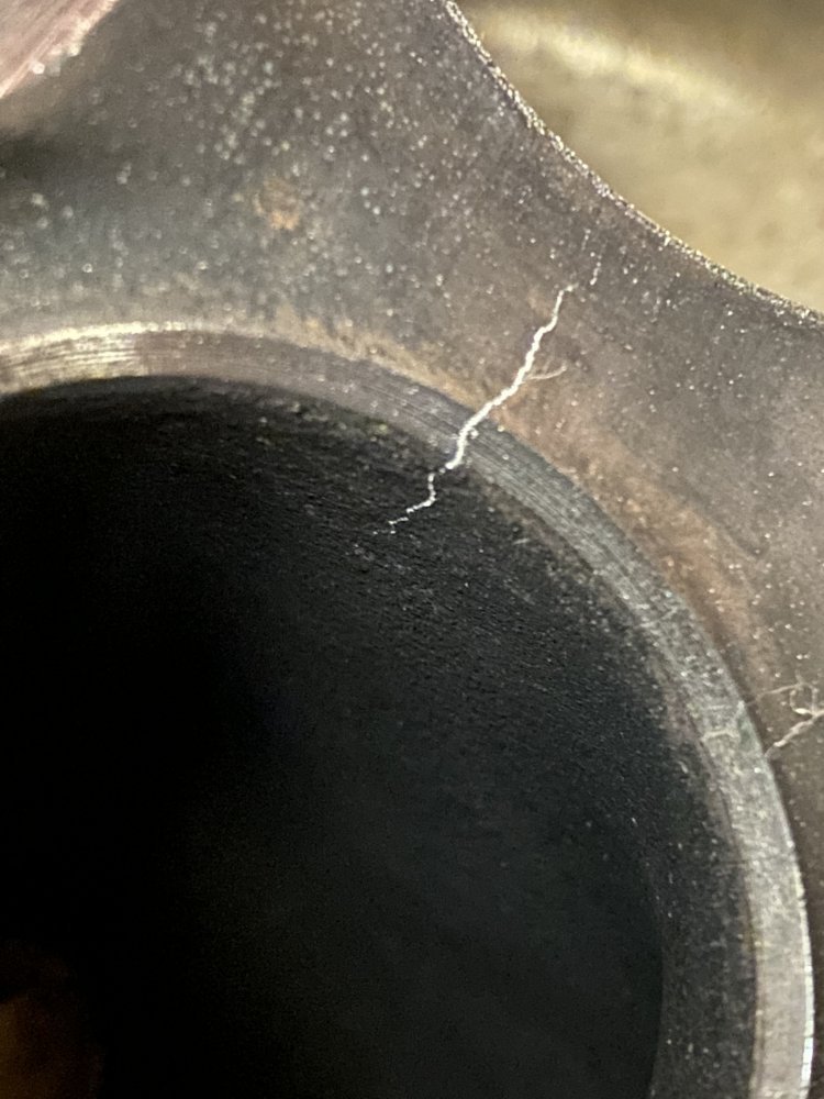

I got the heads from the machine shop. Bad news is both heads have serious cracks. Good news is that makes the likelihood of the block being savable higher. Cylinders 1, 2 and 8 had cracks in them. I looked at the pistons for those cylinders and I don’t really see any signs of the tops being washed, so that’s interesting.
C1B2BB4C-05C7-428C-9C0E-286B4E887974.jpegF86B1BB9-8627-44B9-A0DB-5BF82ADA20BE.jpegD03EBD17-AF9C-4965-BB1F-DE1A9EF2F695.jpegCDA6B376-B889-4878-9C91-DB73E69AF4A1.jpeg0E27E40C-050D-456A-B20B-2DB9E8C2467C.jpegE4467FB3-5951-4697-A2F0-686CA8058024.jpeg
I also looked at #4 as a control and it looked the same to me.

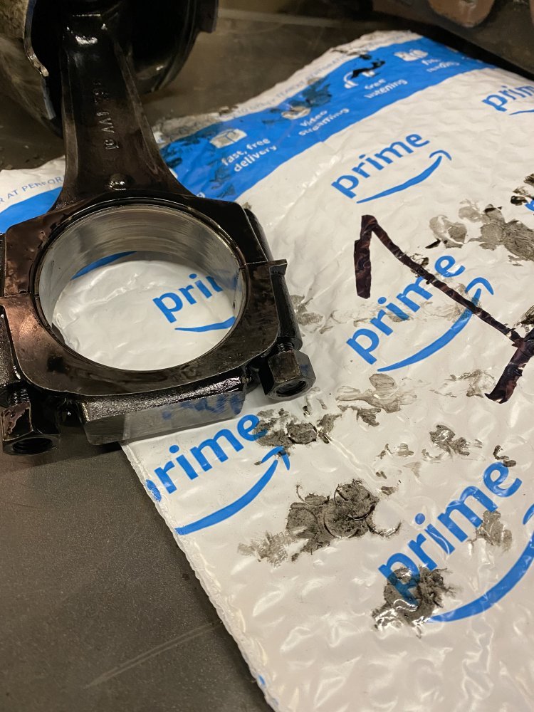

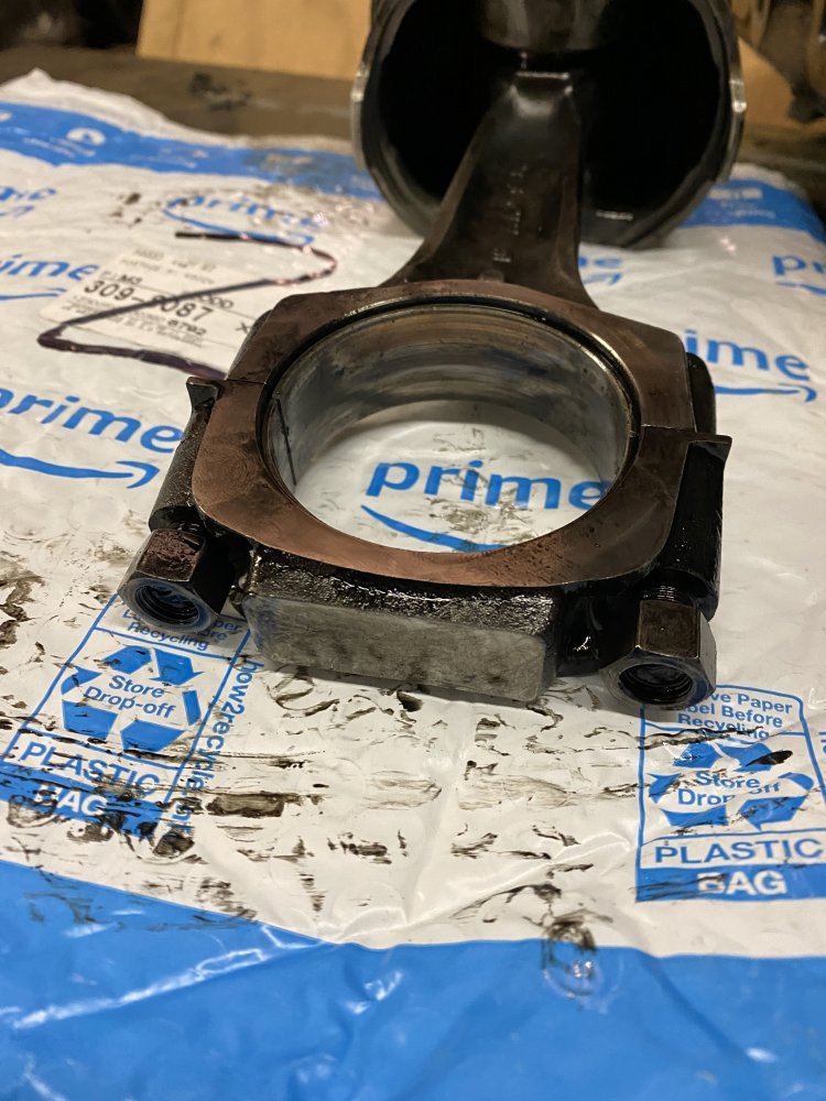

While I was looking at the pistons, I took some pics of the rod bearings for reference. Definitely some concentrated wear on the top shell.
