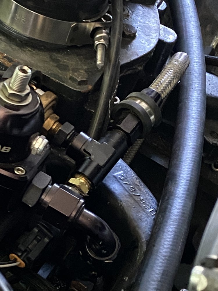

This is the regulator I’m using. I ended up with one that has -6 inlet and outlet because it was a scratch n dent unit and I saved about $50. That doesn’t seem to effect its operation so I think it’s ok, but if all things were equal, I would have chosen one with -8 port sizes so it matched the hose size.Man that thing really zips for a dually!

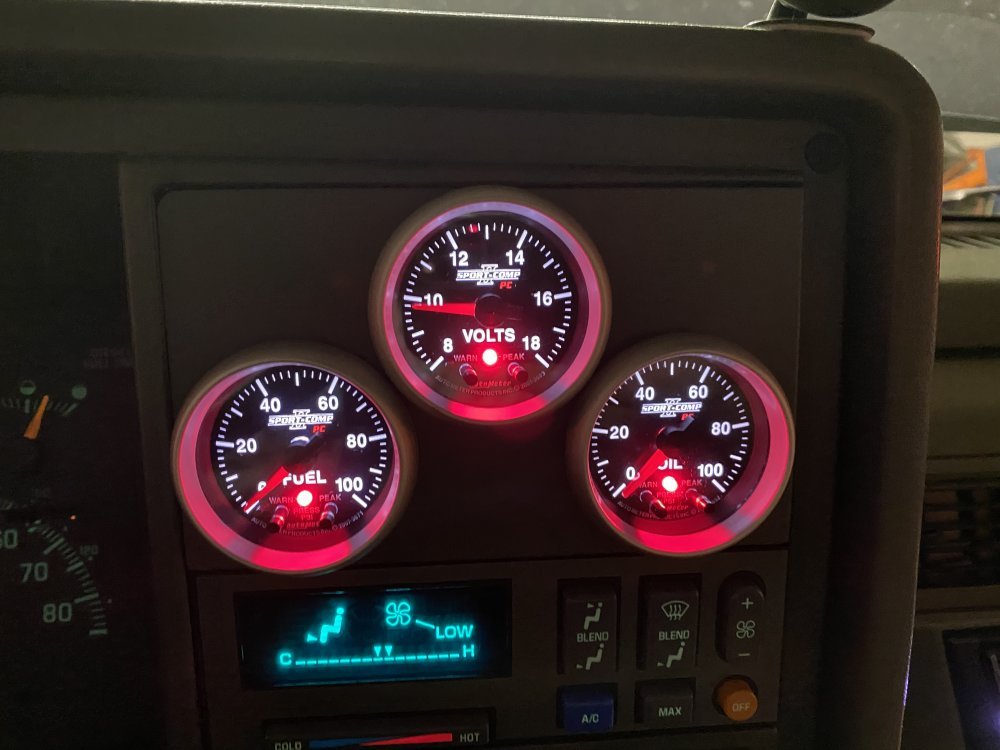

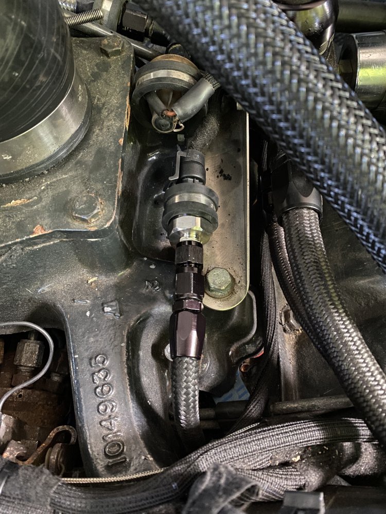

I’m not sure on the isolator yet. I sealed the seam with silicone and that seems to be working, but I think I still have air in the system I need to address because sometimes it will read really low at this gauge but be normal on the gauge at the regulator, then as things warm up it reads normal. I’m not sure it’s worth it to go mechanical for the gauge - between the cost of the gauge, the isolator and the hose and fittings to hook i, I probably spent just as much as I would have just getting an electronic gauge and it would have been easier to hook up.
