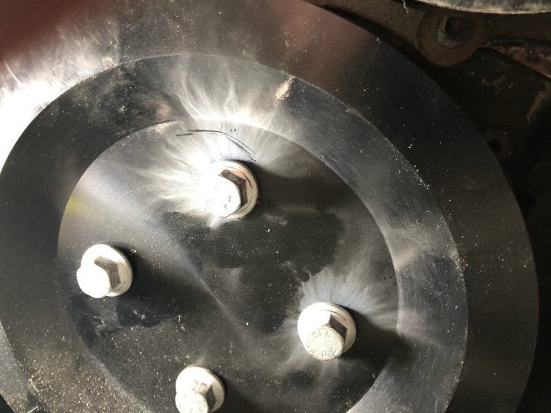

Has anyone ever experienced a compression ignition when running in a bolt. I was using My 3/8ths impact, trying to take it slow and easy, run in two of the bolts just fine, the 3rd and fourth went okay but then I smelled something like ignition. I sure hope it did not crack the new fluid dampener. Guess I`ll keep a watch and see if there is any weeping from that area. :banghead:
