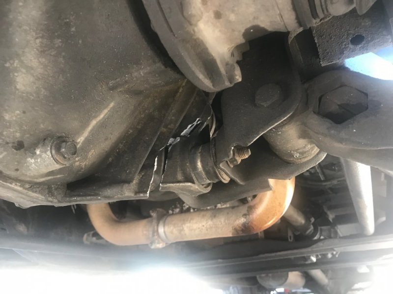

While it was jacked up I got another shot underneath and noted that the front differential housing is busted (sounds like my Pickup).

I think the torque applied to the lower control arm by the tire being folded up and back over it stressed the mount at the frame which is shared by the front differential. That and the attempt to push Half Shaft out the passenger side...another recall to the issues with the Pick-Up.
