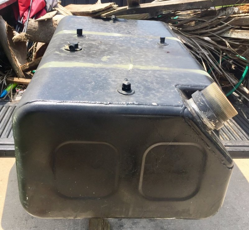

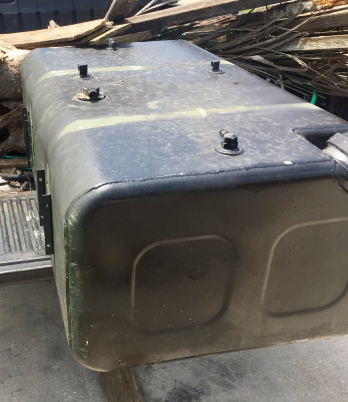

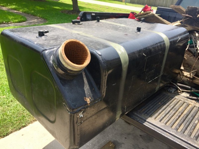

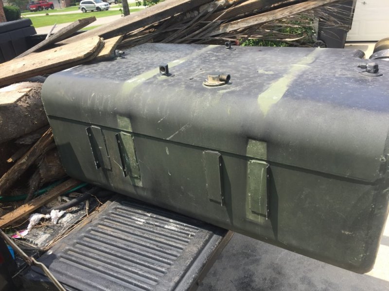

2 weeks ago i picked up this 100 gallon aluminum tank. it has a sending unit so i'll get the correct ohm piece and connect it to the OEM gauge. got it for 50 dollars. i'll be putting it in after i build some brackets. it will be replacing the 30 gallon i have in there now.
