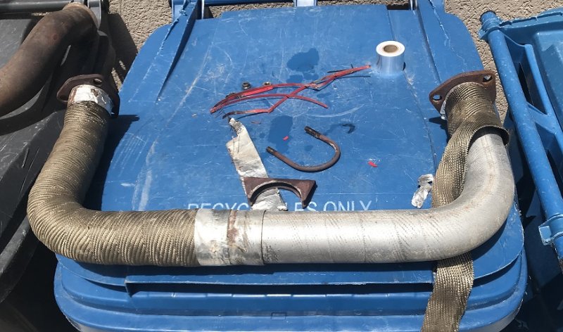

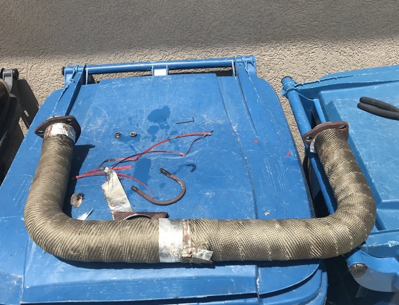

To replace the EGT gauge sender, the fitting in the crossover wasn't budging with a wrench and the wrench was starting to round off the fitting. So I pulled the cross over to get at things better and was able to remove the sender without damage and then the fitting came out with a socket. Whew, thought I was going to have to use my old crossover or drill out the old fitting and chip out the remaining threads like that hot water bung at the T-Stat housing. Since there some discussion as to the effect of wrapping the crossover and it now being subject to rusting I unwrapped one side to see how things were looking under the stuff.
Wrapped
Unwrapped.
No issues after 5 years and 30K miles. Only rust is from the clamp crimping the two halves together being in direct contact with the pipe and that is very light and cleaned up with some steel-wool and elbow grease. I live in the high desert but, the truck is parked outside and we do get snow. The pipe was sourced through Heath Diesel. I never got him to tell me his source for the exhaust system but, it isn't whatever brand folks tend to recommend here.
One issue with the wrap is the clearances for the bolts to exhaust manifold suffer, even with studs and wrestling the crossover off the studs on the passenger side is further complicated by the down pipe being wrapped too. One can get the nuts off but, the socket is a pain on a couple of the nuts. I had other issues but, it stemmed from using studs so it won't apply to the majority here. I don't have a picture and I want to spare ya'll the '1000 words' that probably won't make any sense.
LOL my Heath crossover did not look like that after 5 years under the wrap but then again I'm in the land of copious amounts of salt use. Replacement is now unwrapped and looking way better after several years.
My first Heath sourced cross over doesn't look as good as this one and it was never wrapped.

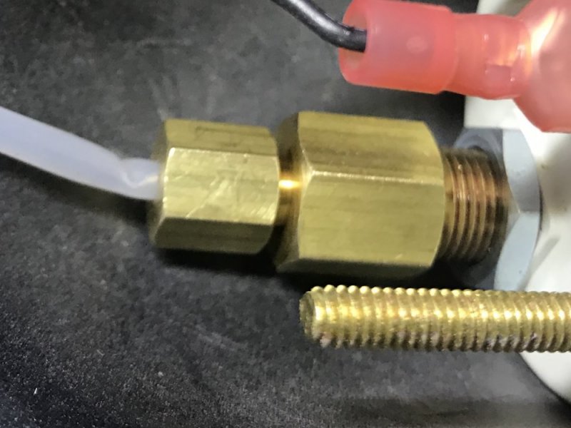

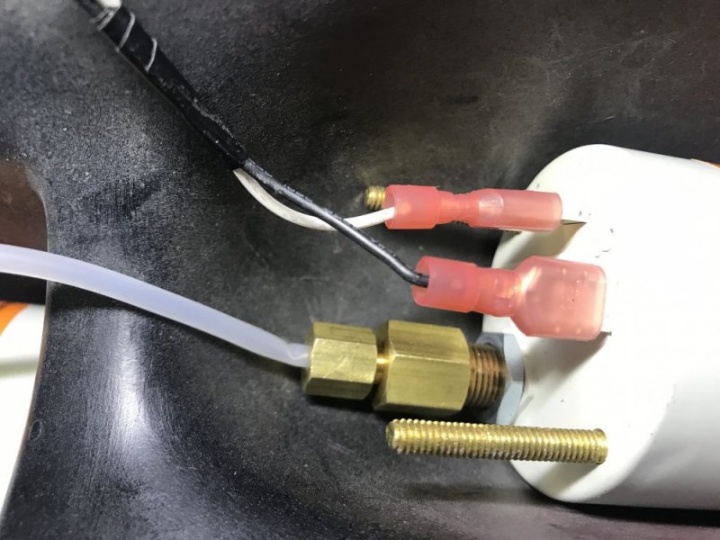

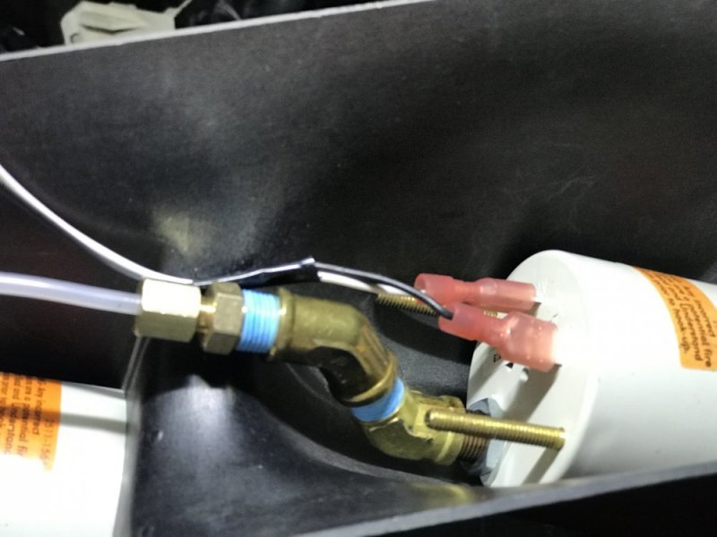

Sorted out the Boost gauge. As I thought, the tube was crimped/kinked at the back of the gauge. Not enough clearance in the way the pod is molded for the compression fitting and tube.
Used two 45 degree brass fittings and new compression fitting (all 1/8") to route around the issue in the pod's molding.

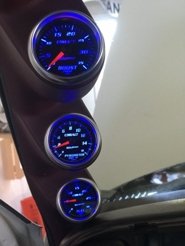

Works fine now. No more swinging / unresponsive Fuel, Pyrometer or Boost gauge needles.
Though I miss the green lighting of the ISSPRO's, the blue looks pretty good.

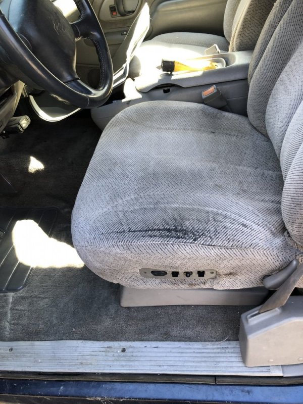

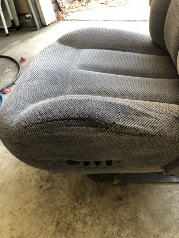

Replaced the foam in the driver’s seat of the ‘99 Suburban. The foam cushion I ordered said it was for 1999 to 2001 Silverado and 1500/2500 Suburban, but it was not an exact match on the sides. So I trimmed and glued pieces from the old to the new and all is good. Seat is much better now.

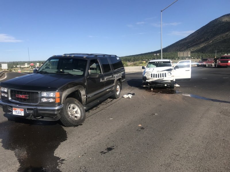

RIP 1999 Suburban. Taken out in a left turn, T-Boned by a Jeep Patriot driven by a 20ish year old who doesn't know what a red light is. Spun me 100 degrees and ruined a beautiful day. I'm sure the gal's insurance company will not want to pay for the cost to replace the Fender, Flare, Inner Fender, Bumper, Bumper Filler, Valance, washer fluid tank, radiator, hub, ball joints, upper and lower control arms, CV half-shaft, tie-rods....
