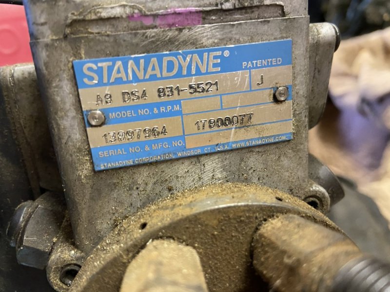

Pretty much it was only the IP on the '94 3500 HD that was the "oddball" that used a different type of signal input to the ECM's PROM. 94 Burb <=> 95 Burb, "no proburbo" (problemmo, LOL) for the swap.
Hmmm...are You sure those Ips are interchangeable? I thought 94 was a oddball year? 🤔
Post #49 Big T
Using a mirrror and translating backwards, I believe the top row on the ‘94 IP reads: D24 831-5521. Could not read the lower row, but it seemed more like a serial #.
Post #50 Jaryd
Since it’s a 5521 the ip from the 95 will work
Interesting, the IP nuts on the ‘94 were hex flange nuts, as opposed to the 12 point we’re used to.

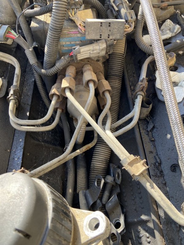

Got the fuel lines off without using a crow’s foot, as my 19mm is MIA. Ran and got some crow’s feet from Harbor Freight after pulling it.
