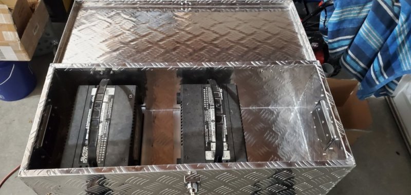

Working on the battery box for in the bed. Just need my welder buddy to call me back to get everything burned in. Then I'll work on getting it mounted in the bed, cutting holes, and building new cables.
I would say, buy the little $5 adapters now that use top post cables. Use them now with a battery charger to try keeping alive for now. Wire it in for top post and use the adapters until the batteries die. Then going foreword you are dialed in for better ones.
Do use some rubber, like mudflap under the batteries and use good tie downs in there.
I have some 3/8" rubber mat I plan on putting under them. It was used as flooring in hockey locker rooms so I think it will hold up fine.

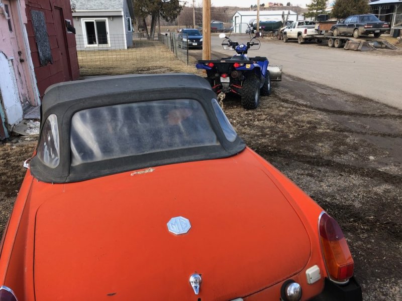

Then, hooked the four weeeler to the MG and give it a yank to the garage. Used the plow to push it in the last 20 foots or so.
Now, bleed the brakes and get them to functioning, clean it up some, flush the fuel system, its been setting for six or eight years, install a battery and see if the little beast`ll fire. Years ago, the ignition system failed, machined down a big block olds distributor, installed four cylinder components into it and now the MG has a HEI GM distributor. LOL
You could always retrofit the OEM MG distributor with a Pertronix 50,000 V electronic ignition kit. Did that with an old (1950's) 4-cyl Ford industrial motor that kept frying it's ballast resistor at the most inopportune times. Bye-bye points, condenser, ballast resistor and old coil! Hello electronic pickup module assembly and 50,000 V coil and no more issues!
