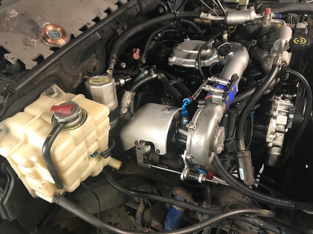

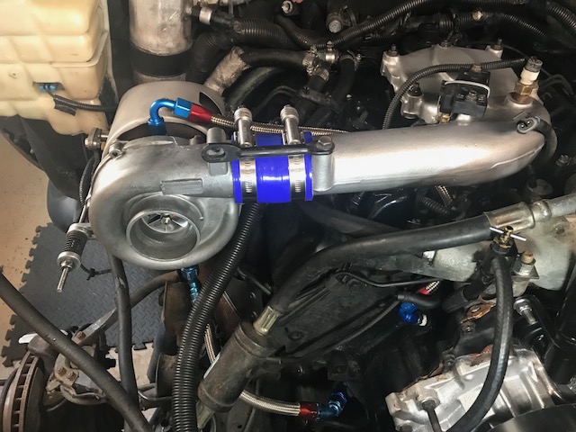

Turbo is on. Old drain line is too long so I tried to shorten it but, these 10AN fittings can only take so many re-uses and this one gave up the ghost. Waiting on parts now.

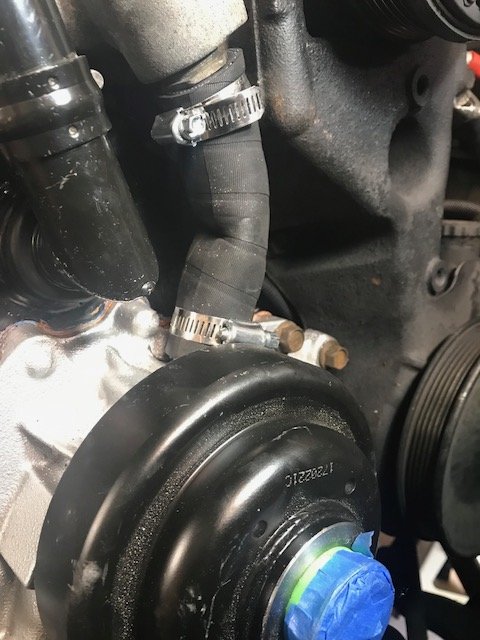

Ran into an issue with the T-Stat to Water pump 5 inch hose. The one I got was cut off at the wrong angle so it doesn't it. I attempted a couple of alternate solutions only to be frustrated in the efforts (bending a straight hose only introduced a kink and I don't need a restricted flow at that point in the system. Ordered another part and will compare to this one to ensure it's cut correctly.

Getting the bypass radiator hose corrected was the main thing. The part I re-ordered was cut correctly so it went on as it should. Unfortunately, I marred the first one tightening it down trying to make it work so they wouldn't take it back.
Here's the straight piece I tried that kinked in the middle:

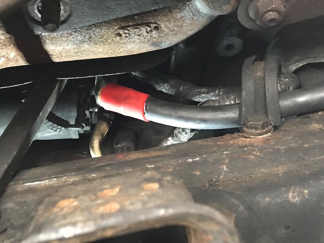

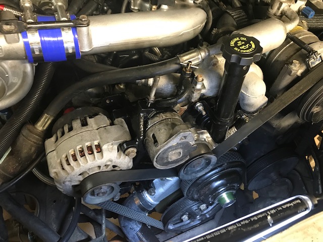

Additionally: starter battery cable replaced with the upgrade from PT Wiringsolutions; alternator bracket and alternator installed; radiator installed; radiator hoses installed; serpentine belt on; top fan shroud trimmed back; fender's lower portion sanded and painted after some POR-15 treatment and, of course, a lot of cleaning up some other rusted parts and treating them as well.
Access around the starter is never fun but it's in. Big thanks to Bruce. Bat cables and GP wiring harness are great upgrades.
Not sure why I took this shot but, it shows the before alternator etc. work.
After. Alternator bracket was all flaky rust so it got wire wheeled and POR-15'd and then a top coat of black gloss. I rushed the work, believe it or not, as I know it doesn't matter, really.

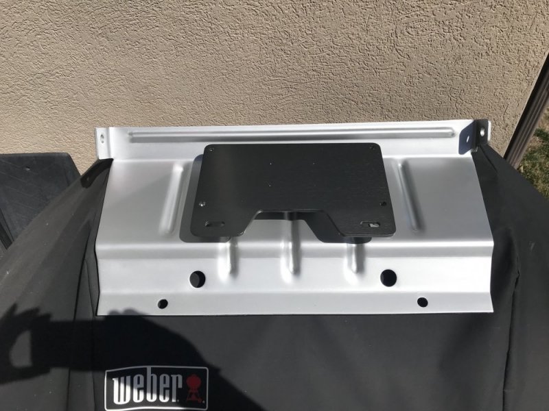

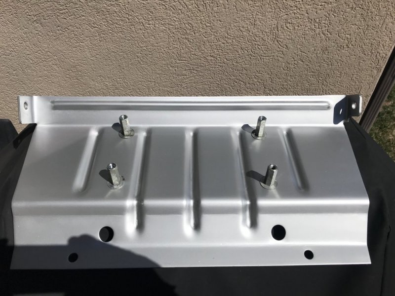

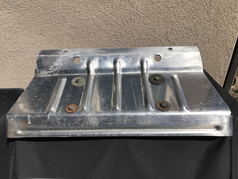

Long ago, I linked up with member from DP who gave me an Aluminum Skid Plate. I had made a diamond plate version for the truck so this one has been on the shelf. Figured it was time so I'm using it on the Burb. FWIW, He's the one that polished the back side if it (I wouldn't have...really).
The front was oxidized, pitted and such so I sanded it down and painted it silver.

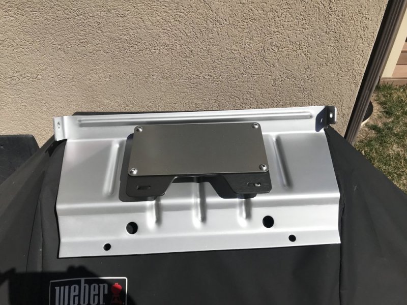

The PMD cooler's aluminum parts were begging for some TLC too so I cleaned it up, painted the Heat Sink a color matching gray and the front plate a color matching the trim.
Looks good under there.

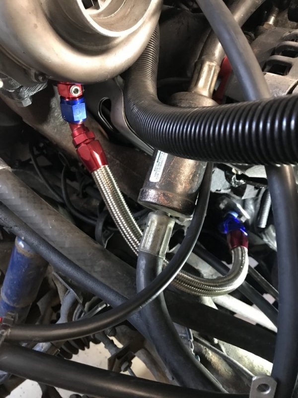

I also got the new 10-AN fittings from Russell today so I repaired the Turbo Oil return line and got into place.
View attachment 52381 View attachment 52382

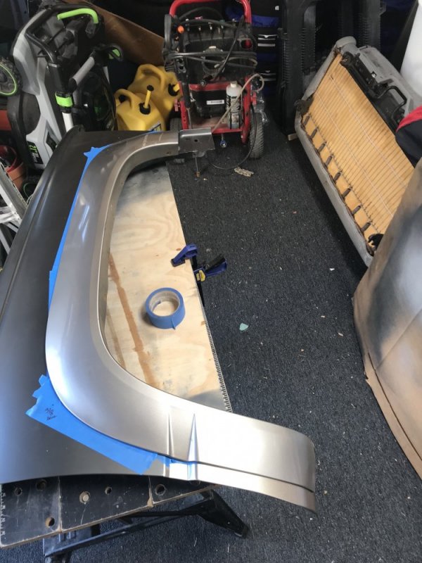

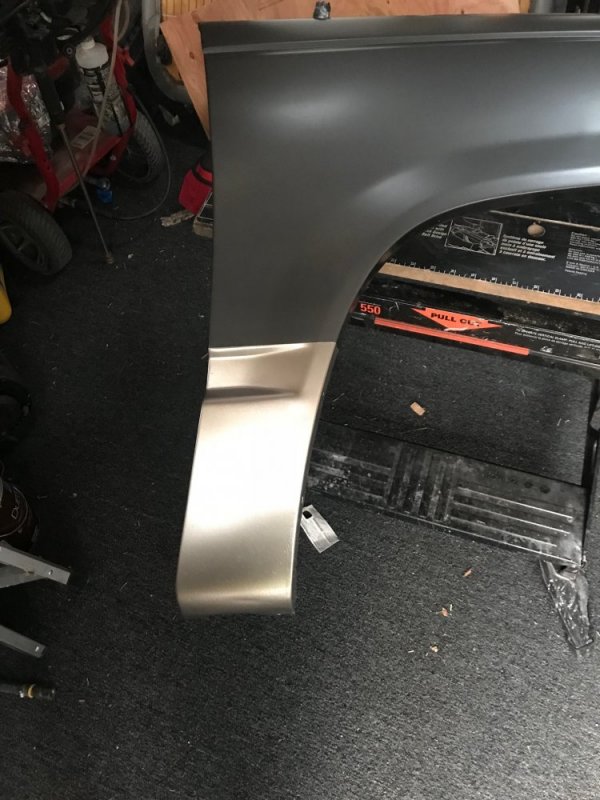

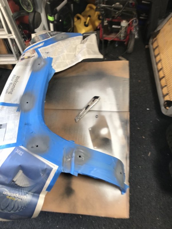

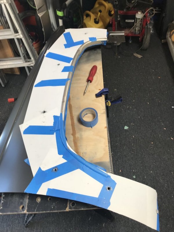

Made a template for the fender flare mounting holes from the old, rusted one so I could attach the flare to the 'new' fender.
Transferred it over to the new fender, drilled the holes and...
...the flare fits on the new fender.
Taped it off to prime the holes and I'll shoot the whole fender with clear tomorrow.
Slow and steady....
Did you go all the way through then oversize the inside holes to get a socket on the nuts?
Yes, the two on the lower/door side were drilled through and enlarged. Those too got the primer and rubber sealing as did the insides for the other four. Those four are already accessible without additional drilling.
Now I know what the difference is between fenders "with flares" and without when shopping on recycled parts sites. Should save a little time with the driver's side should it need replacement; which it probably will.
