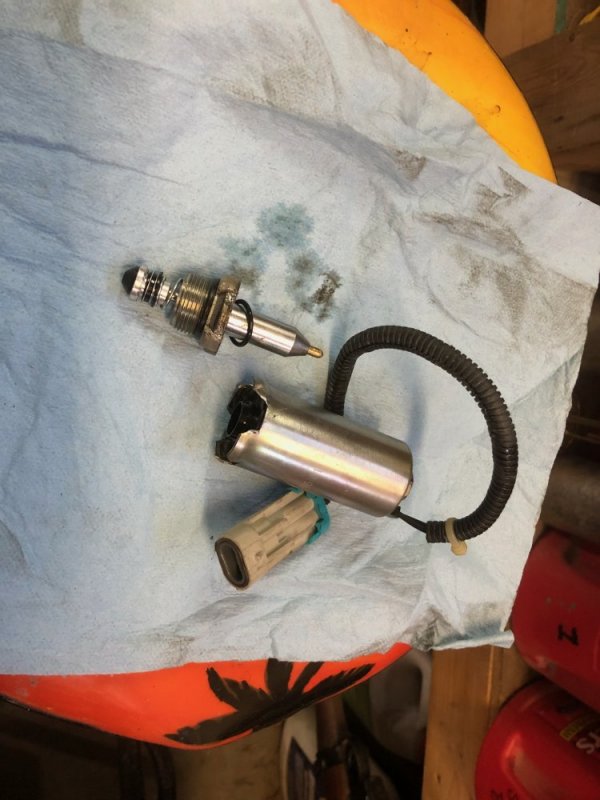

It was due for an oil change, while in the garage I turned on that nice little lift pump switch that is in the harness from Leroy Diesel, I found the leak, an O~Ring I though. HA
When trying to get it removed, the whole assembly seemed to wobble, and wobble it did, right off of its base. I used a punch and hammer to get the base jarred loose then a screw driver to keep it turning without any further pounding.

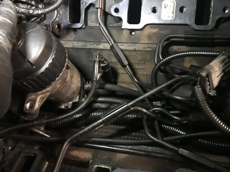

More Burb work. Pulled the intake assembly off to get at the 90,000 miles of gack in the valley and try to ascertain what block I have. Lots and lots of gack in there. Scrape, brush, degrease and rinse with brake cleaner (yes, all holes plugged. Only real marking I found in the valley was two dashes like a very thick 'Equals' sign (=). No numbers, no double triangle/diamond.
Removed the GP Relay and cleaned all connectors and took the opportunity to replace the Glow Plug wires with the PTWiringsolution units I purchased last fall. Will put it all back together using Noalox contact promoter on all connectors. FFM is coming out to bed replace with aftermarket fuel filter assembly (3 micron) and run 3/8" to the IP inlet.

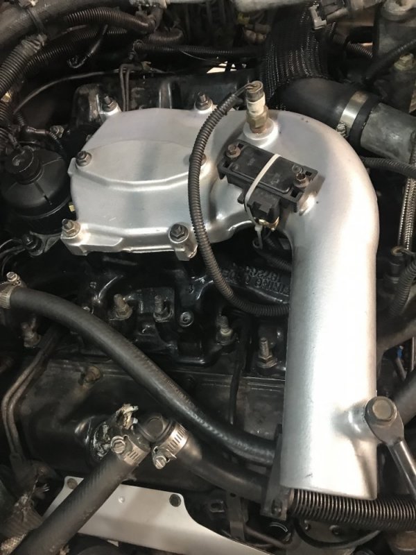

Re-assembled glow plug wires, GP regulator-thing, lower and upper intakes.

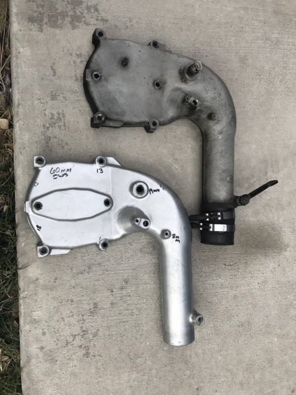

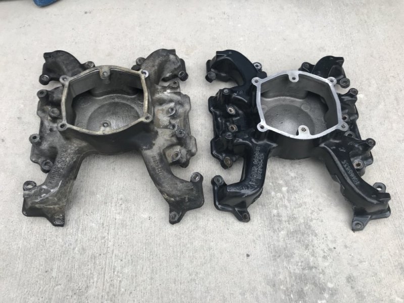

Original and powder coated upper and lower intake parts.

I took the upper off my truck years ago and, as you can see, marked the wrench sizes (cheat codes) should I use it again.

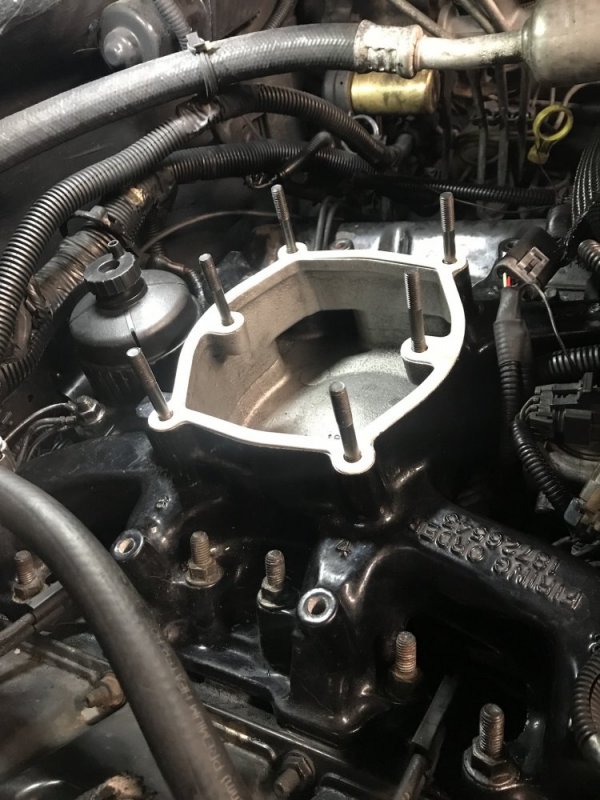

Lower in place with new gasket and 60mm studs for the upper (yes I counted Eight removed Rags that were in the head ports to keep out debris). Torqued in a crossing pattern to 31lbs after two earlier passes at ever increasing torque values. All my grounds go to the FFM bolt so I can keep track of them, clean as needed. These were coated in NoAlox as well.
Upper in place and torqued to 17lbs. All cheat codes removed. Also the sensors are back where they belong.

@Paveltolz I love the upper intake stud idea!

I noticed the studs also, WW eat me to it. Cool idea.
