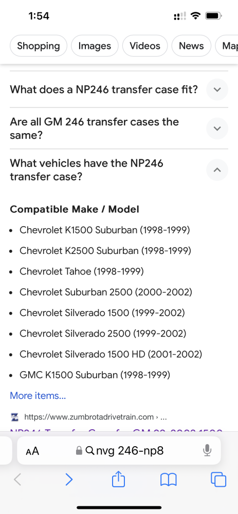

‘98 K2500 Suburban would be a NVG 246, though not as certain for a truck:IMG_0907.png
Concern with the NVG 246 is pump rub which eventually wears through the rear case half which is made of zinc. I went with a reman for my ‘99 K2500 Suburban and they used an aluminum rear case half to address the pump rub issue.
I compared both 96 and 98 model years to rockauto and it’s the same part number for the truck and suburban with electric push button 4wd.Rockauto calls it a NV243.I have heard of the 246 like you mentioned.I heard there was a issue with the housing wearing through at some point.

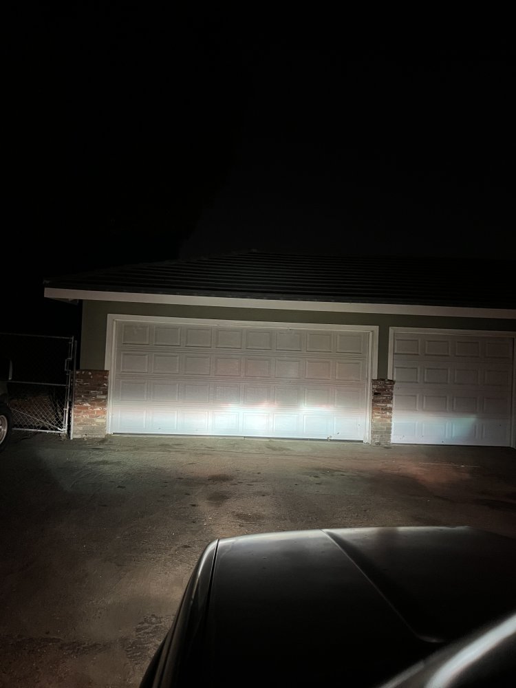

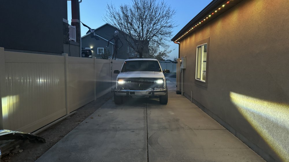

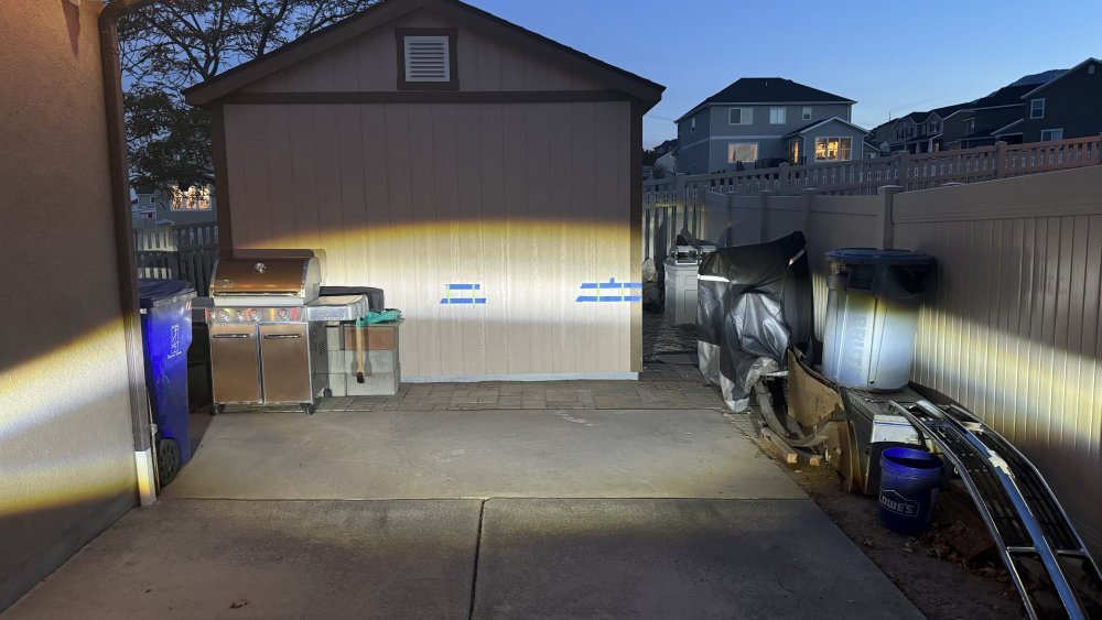

Took the truck for a drive last night. Oops. Headlights are way too LOW. When my helper and I buttoned things up we hadn’t actually adjusted at 25’ and I errored on the side of safety. Tonight we properly aimed them. UT DMV has a guide and if the headlight’s brightest portion (low beam) is more than 4” above or below the centerline. I did a double take cause 4” above would certainly blind pilots! Anyway, IAW the guideline, I did the “drive as close to the wall as possible (6’) with lowbeams on to mark the center of the projected beams. Higher tape markedwith Sharpie on the 2” painter’s tape. Measured down 4” which is the top edge of the lower painters tape.
For those ready to pounce on the illumination above the tape marks, this is the view of the lights at the height of a driver in a VW Golf.
Foul! I see light escaping out the top.
