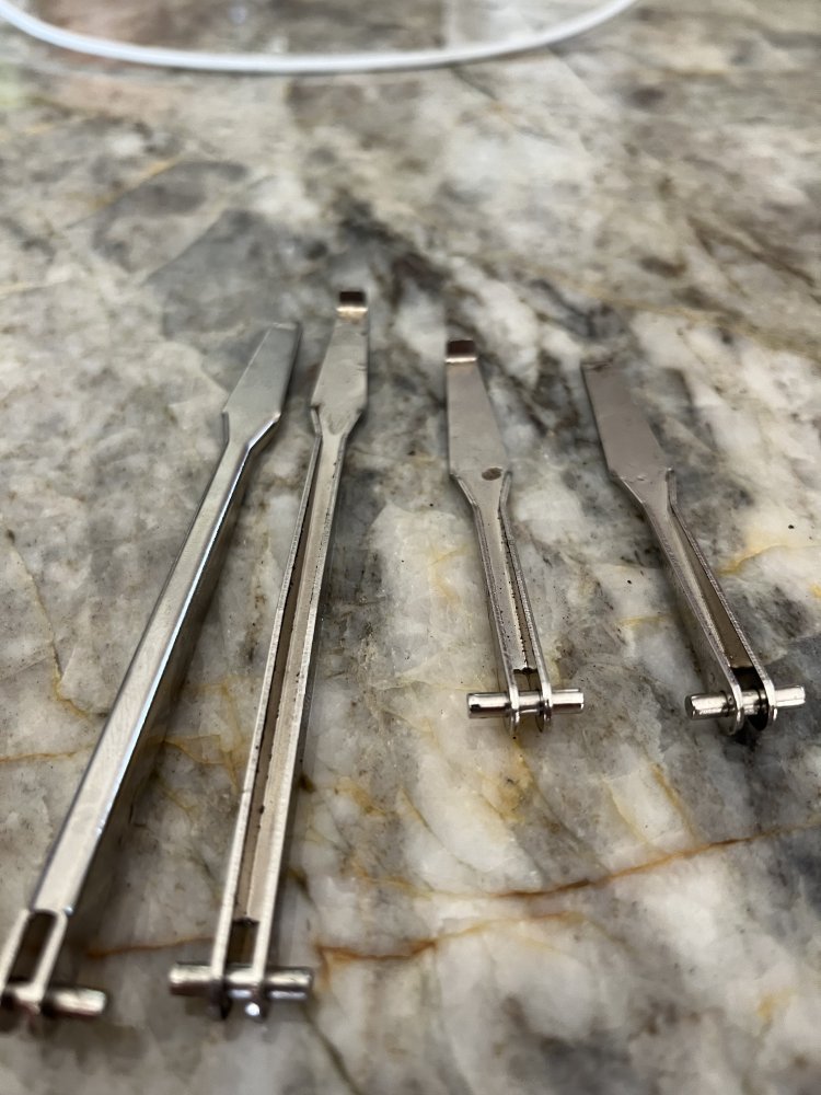

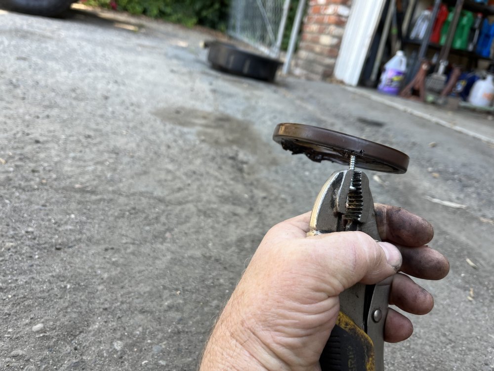

I bought a puller like the one used at the 17:30 mark in the following video:I’m sure You are well versed on how to remove the old pilot bushing/bearing if You dont have a puller system.
Pack it with grease. A shaft/bolt/etc that just fits the bore and drive it onwards with a hammer, pack in more grease as needed until the bushing pops out and hangs on the shaft.

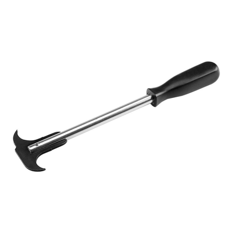

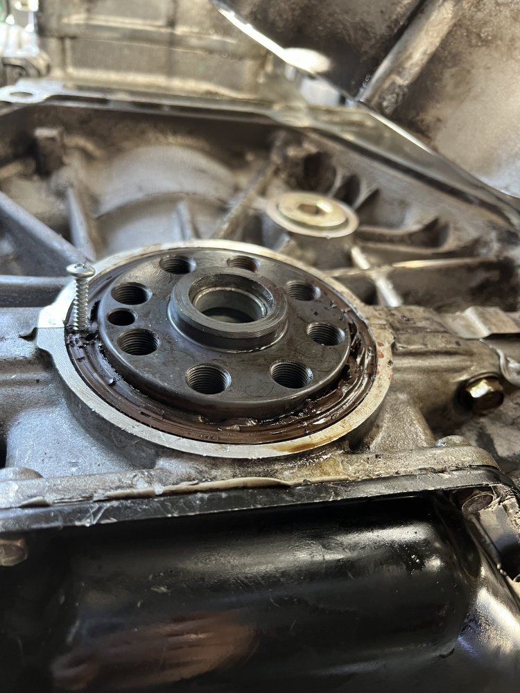

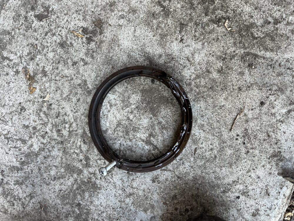

Also bought the seal remover tool. Both tools were about $25 off Amazon. Well worth it even though I will not use them that often. This clutch replacement is easily a $1,200 job if I had someone do it for me.

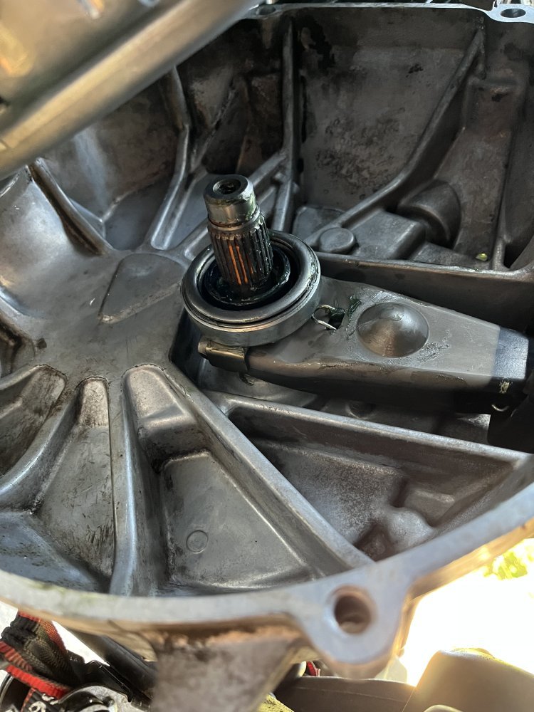

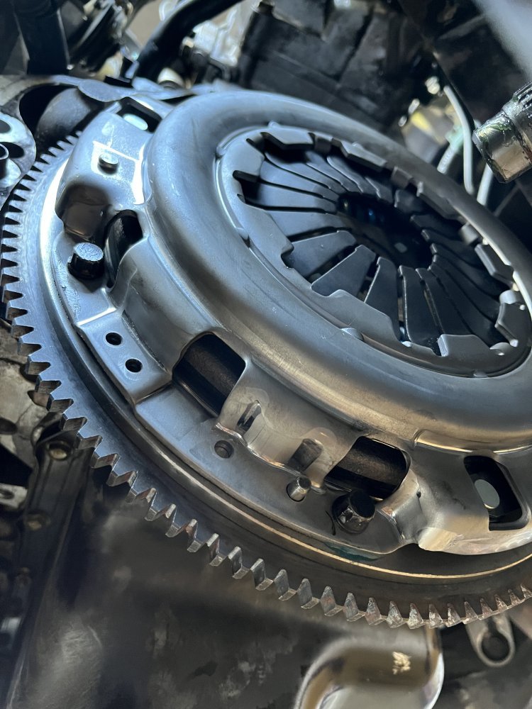

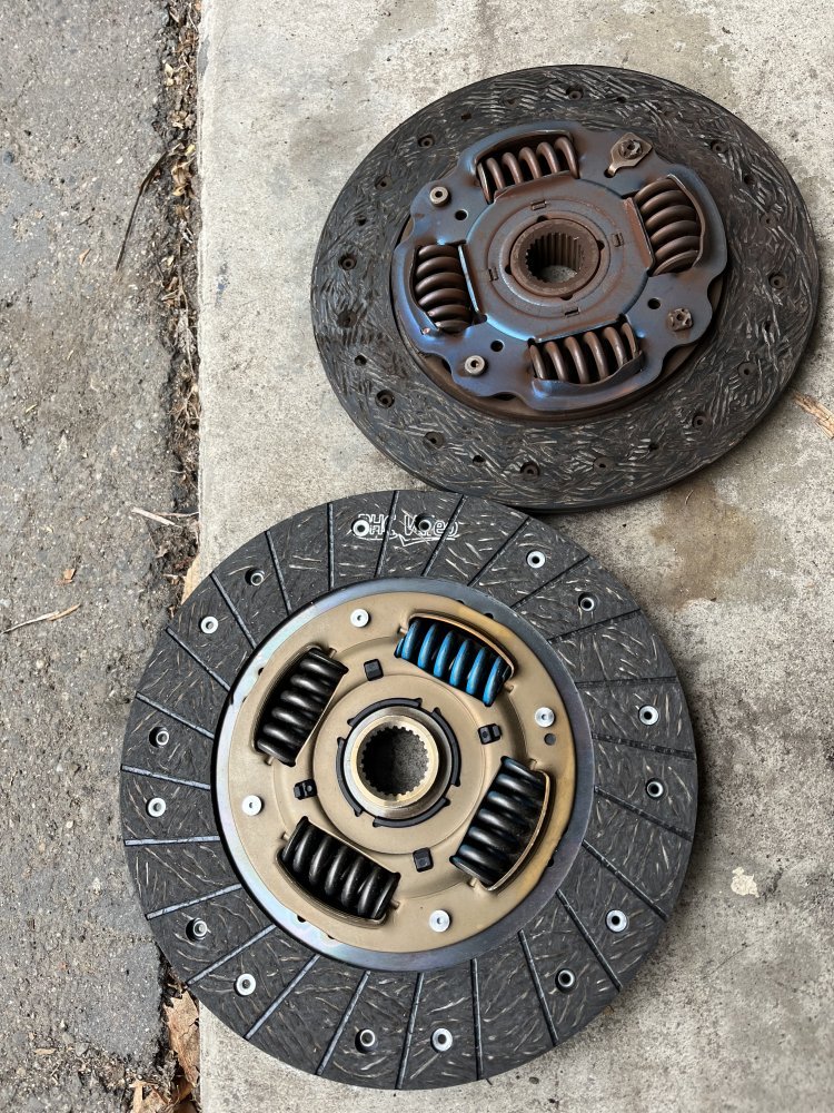

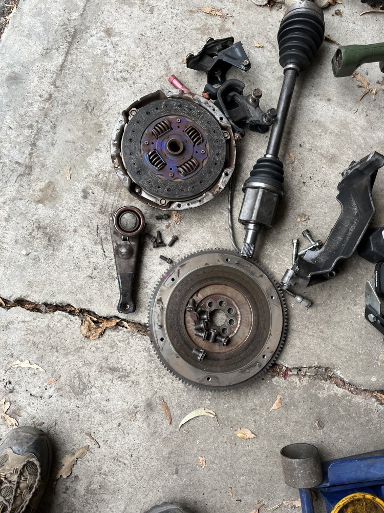

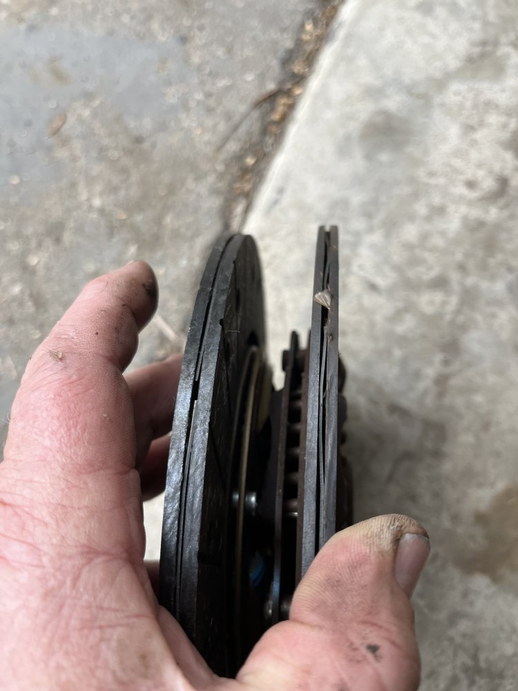

I pulled the clutch and throw-out bearing this am. Also degreased the bell housing of the transmission. Clutch plate was almost down to the rivets. TO bearing moved freely with no obvious source of the sound I was hearing.
