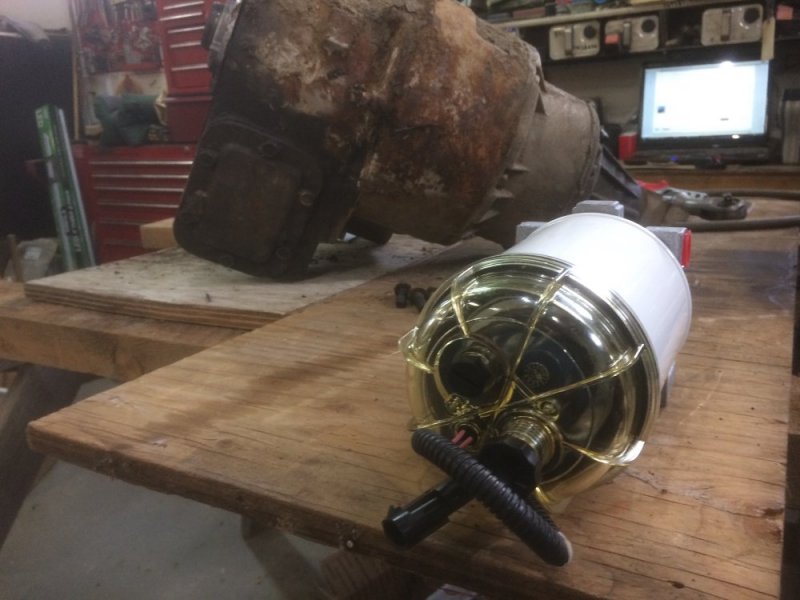

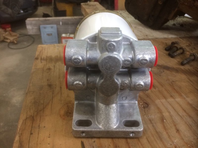

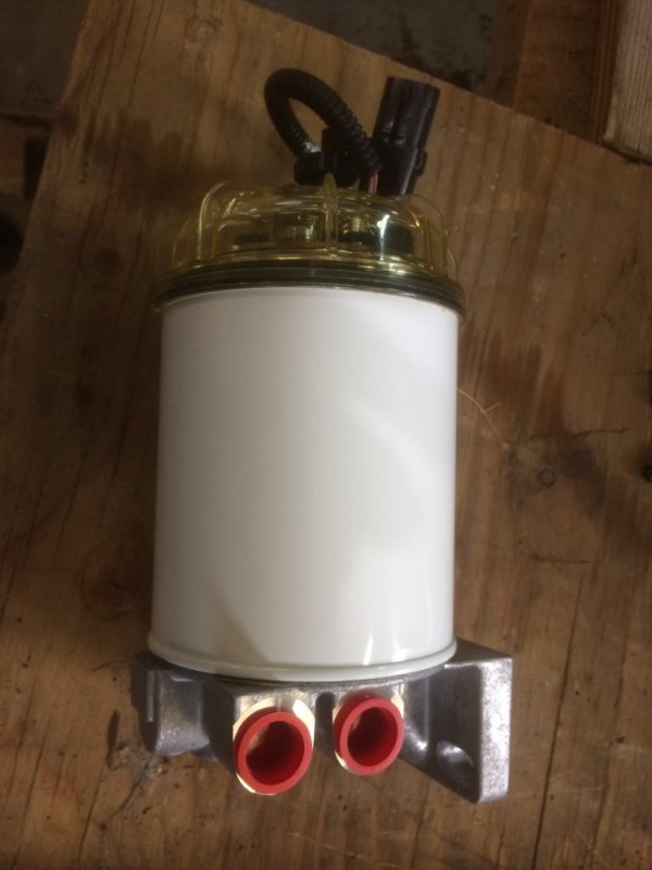

I did receive the heated fuel/water separator/filter system in the US mail this morning, that was a surprise to look up from breakfast to see the USPS jeep pull into the driveway. LOL
I do not believe that it is made by Parker but it looks to be of very good quality.For about 25 bucks, shipping included, do not see how I could go wrong. it appears to be made in USA too.

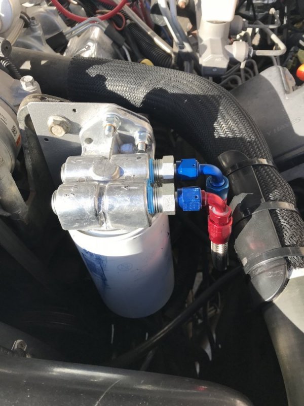

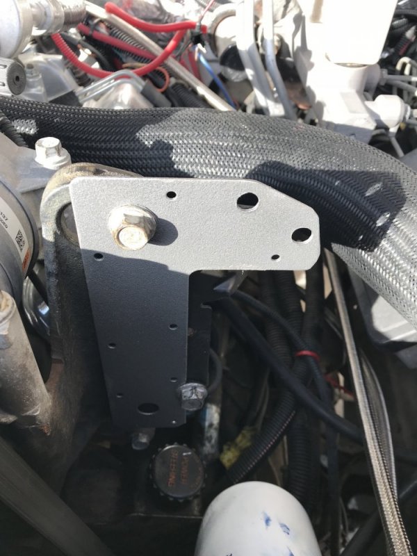

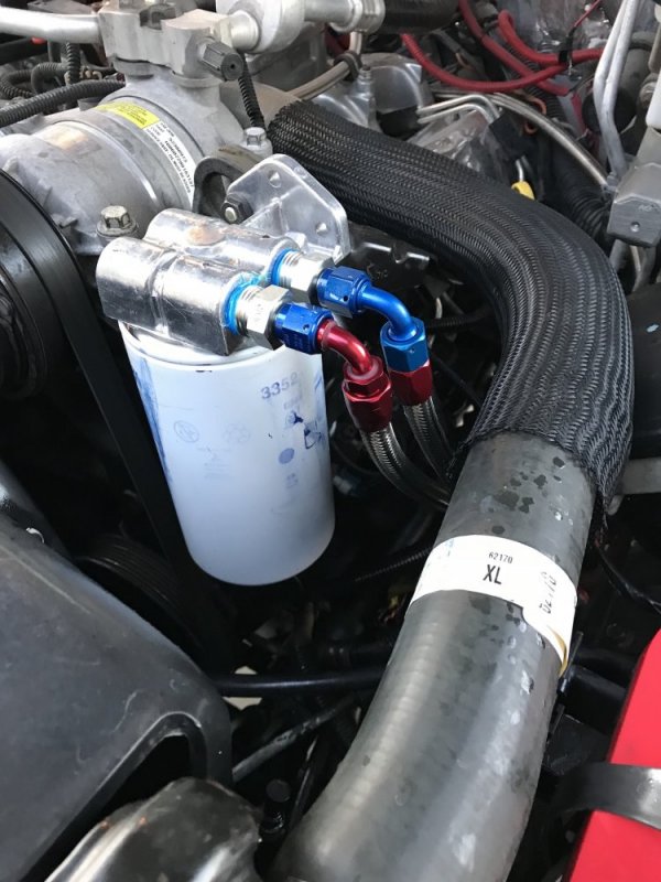

Posted elsewhere I had installed a 6micron fuel filter in the engine bay as a stop-gap to use with an OEM Lift Pump after the Air Dog failed. More of a mock up mounting really. I have it mounted over the Power Steering Pump on the A/C bracket. The assembly was held in place by only one bolt which also holds the radiator hose support. I wanted to make up a bracket for a better hold since one bolt, over the serpentine belt and pulleys...not a good idea for anything other than checking fitment.
Since that mock up was a week ago, Thursday I got an "L" bracket at Home Depot, cut it down a bit, marked and drilled holes and then gave it a coat of paint.
Bracket is held in place with the larger OEM bolts and the filter mount is attached with two bolts so it won't rotate into the pulleys. Bolts are secured with Nylon Lock washers. Should work for the foreseeable future.
Hose protector on the radiator hose to keep the braided lines from inadvertently sawing a hole in it.
