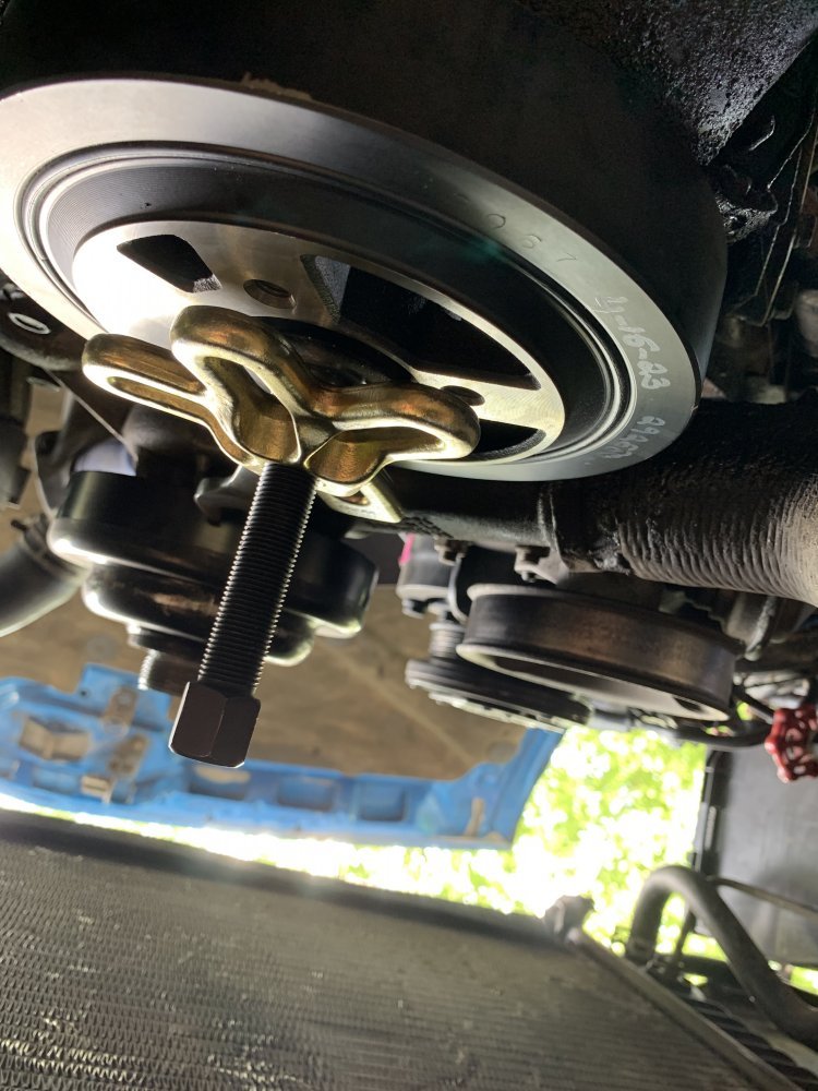

I was looking online and found a thread on DP where a fella got a puller from autozone he rented and the bolt for the puller it’s self was the right thread for the crank. He gave the part number so I looked up our local autozone to see if they had it in stock. Yup that have it for $27 to rent or buy. The fella used the puller threading the shank into the crank and spun the piece you used to do the pulling to install the balancer. Well it’s worth a shot. There’s nothing else available close to me without having to order it and wait lol

Here's the tool that was posted on DP. it's the only one anyone happens to have in stock locally to me, so I'm keeping my fingers crossed it will work to install the balancer and I can get the job done this weekend without having to order anything and waiting another week!
and the thread where I found it looking for something that had the m16x1.5 thread. the tool is only a puller kit not the install but they are saying the bolt for the puller is the right thread.

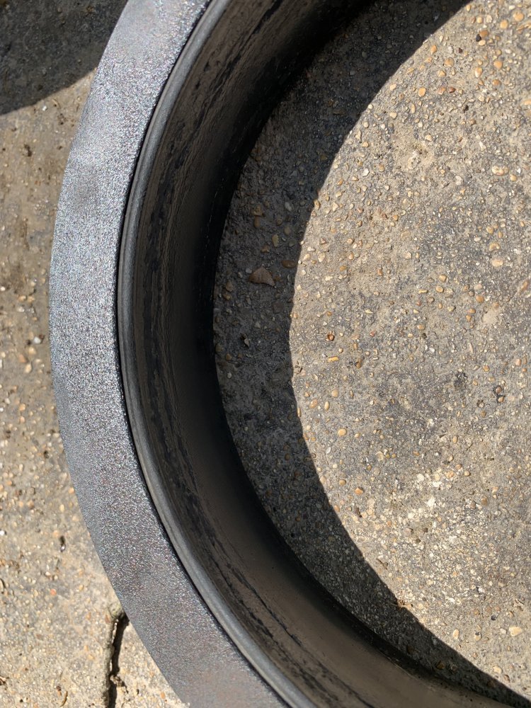

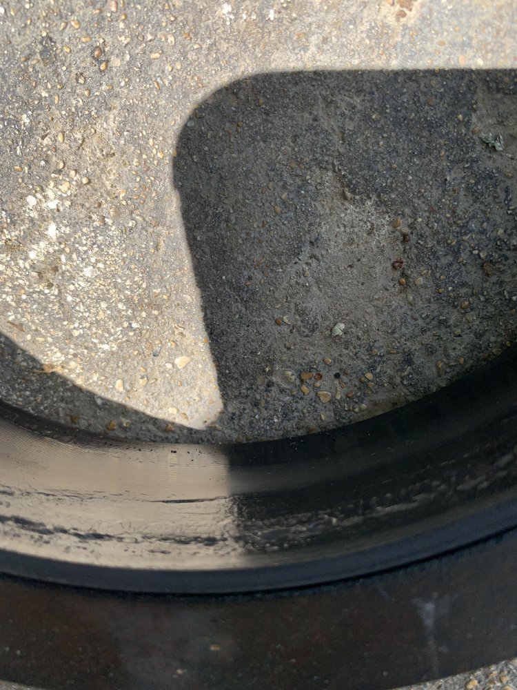

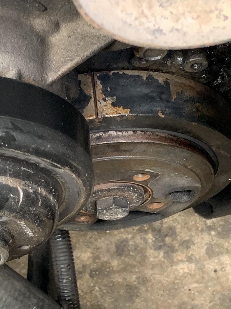

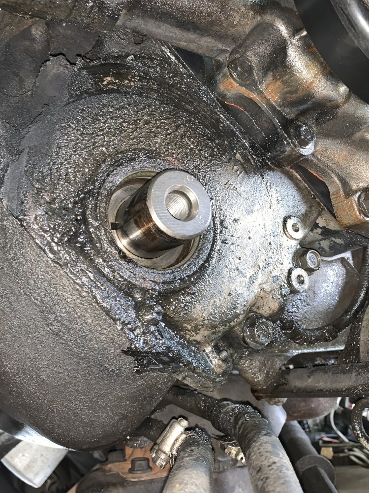

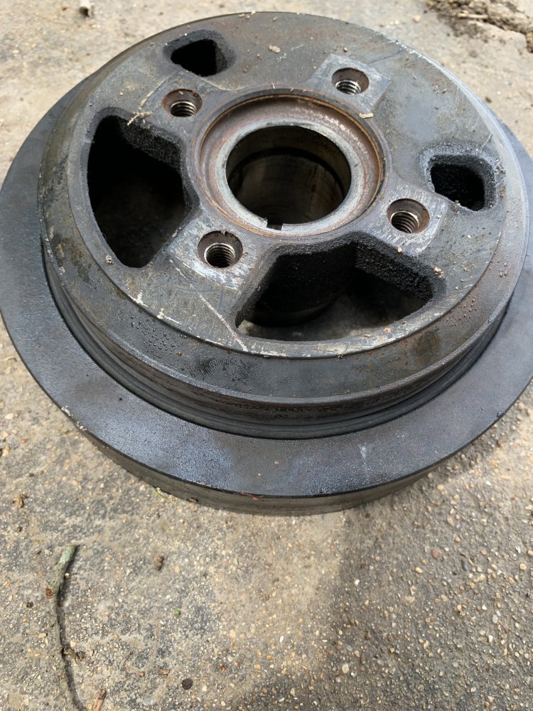

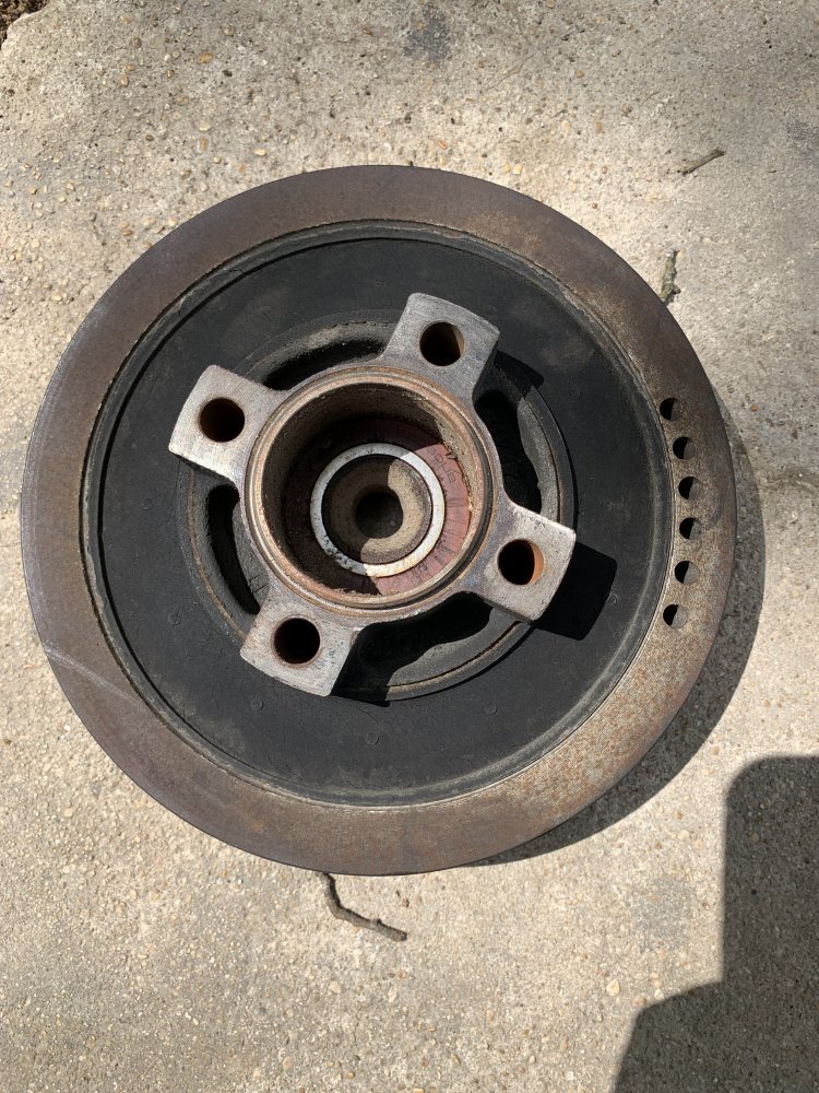

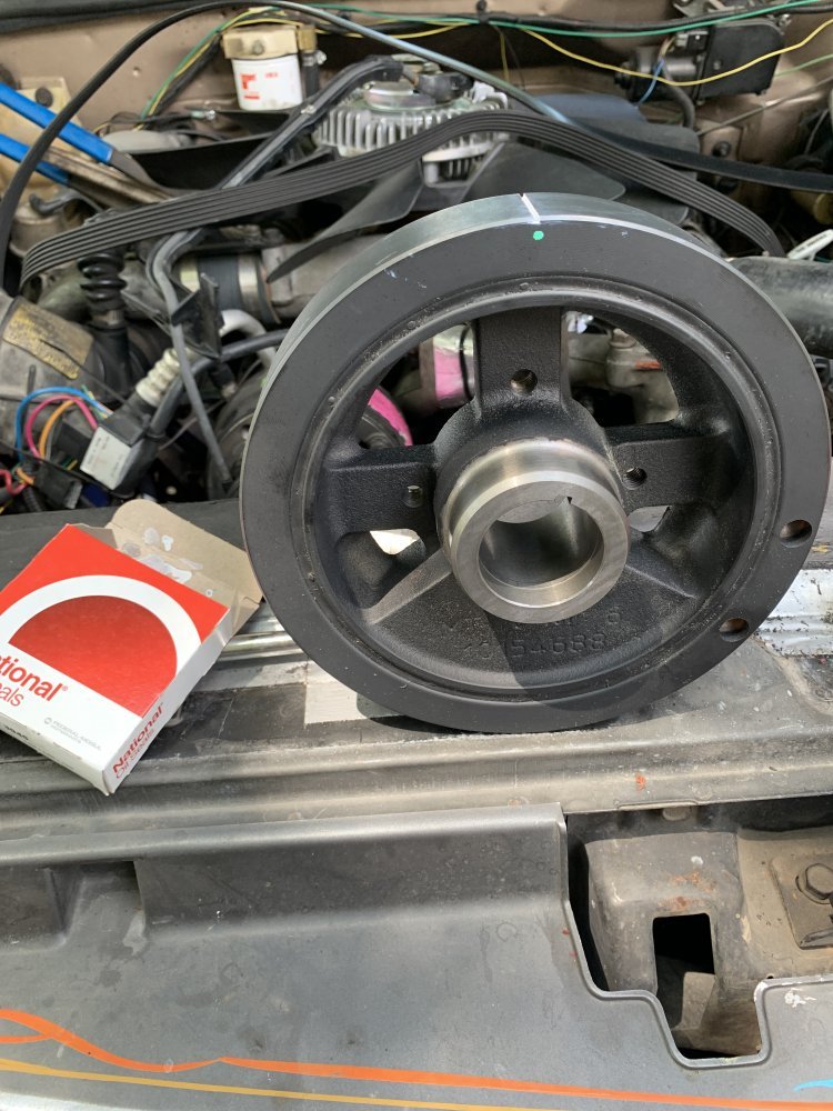

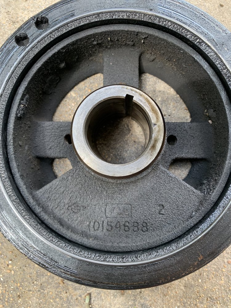

Well folks. It’s apart. Pulled the fan and shroud like y’all said. I ended up having to get my son to help while I held the pump pulley and he used a 5ft cheeter pipe on the fan clutch to break it loose! Dan this is the one thing I hated about these spin on clutches.

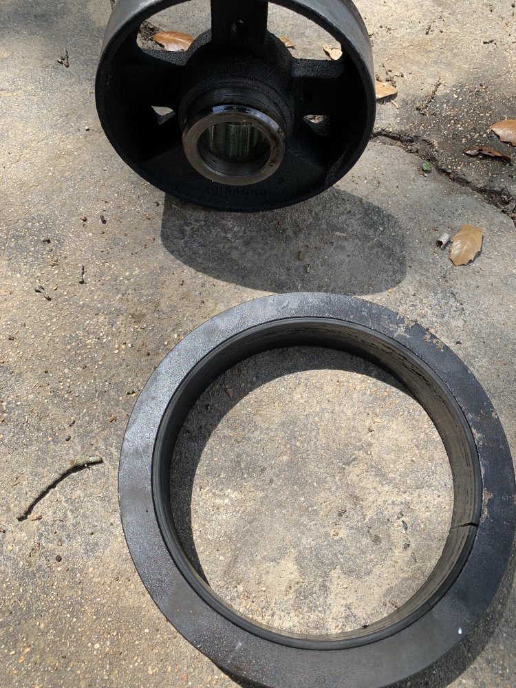

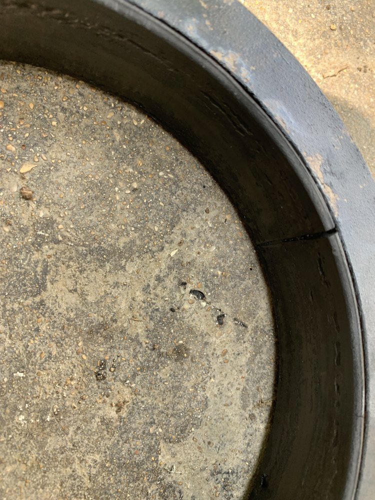

Got the pulley out and started setting up the new puller on the HB. Well the HB practically came off in my hands without really needing the puller!
Here’s some pics of the carnage. I’m getting ready to replace the seal and clean things up for the install

Clean that mess up.
The installation went smoothly. Almost too smooth lol. I took the puller bolt. Flipped the puller nut and used the factory washer. Added a spacer in there so I could grip the nut easier by hand. I was able spin the puller nut by hand installing the HB.
