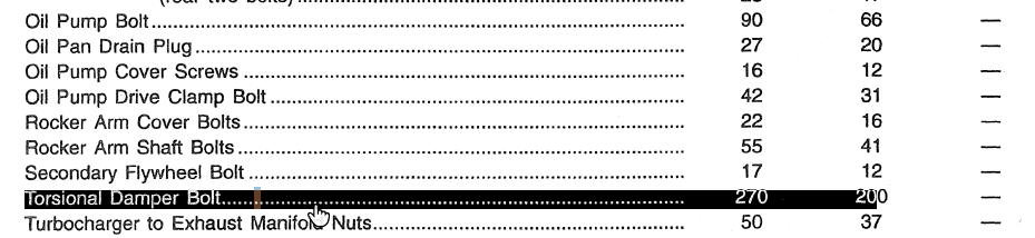

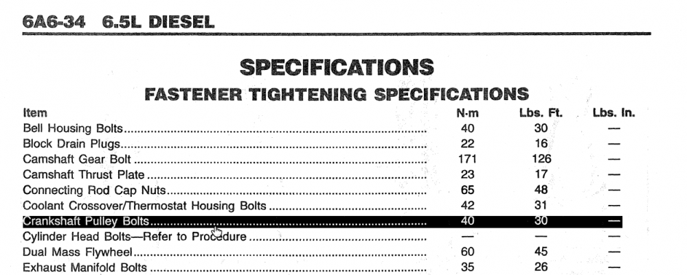

This ^^^ says 200 ft/lb or 270 nm for the HB and 37 ft/lb or 50 nm for the pulley.

  • Pulley Bolts--37 (50)

  • Harmonic Balancer Bolt--200 (270)
the book doesn't say anything about torquing in stages. just shows go to 200. I would attach the file but it's telling me the file is too large.
