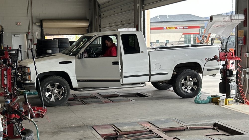

The new wheels and tires came in.
Old 265x70x17 Coopers on Dick Cepeks
New 265x70x16 BF Goodrich Trail Terrains on MBM Legacy's
Tires are 1.6" shorter and kinda disappear in the wheel well shadows. They roll so much nicer, smoother and I can tell just in the short city driving they handle much better too. Need to get new fender flares as the old Zenon's are much too wide for these since there isn't nearly as much offset as the Dick Cepeks.
