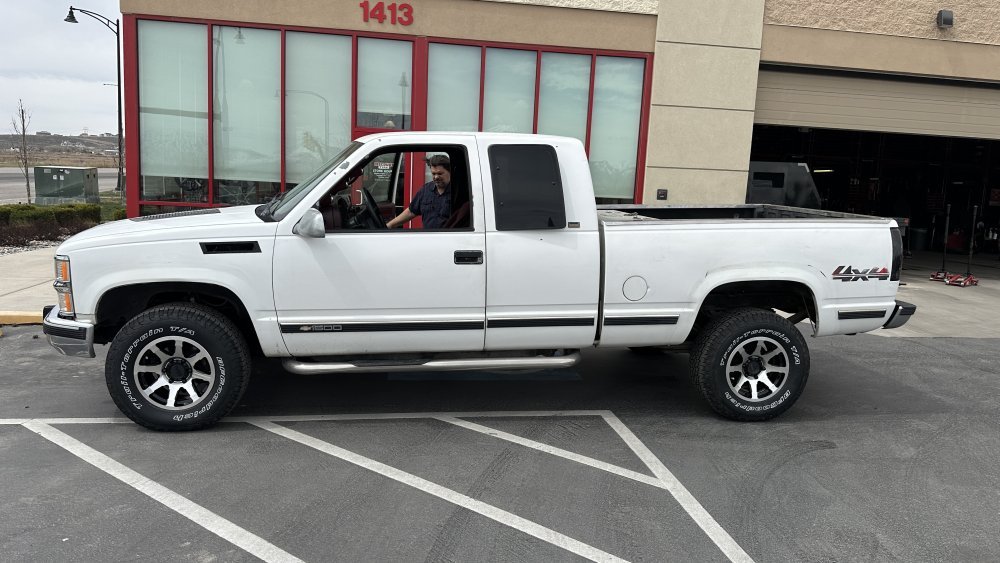

The new wheels and tires came in.
Old 265x70x17 Coopers on Dick Cepeks
New 265x70x16 BF Goodrich Trail Terrains on MBM Legacy's
Tires are 1.6" shorter and kinda disappear in the wheel well shadows. They roll so much nicer, smoother and I can tell just in the short city driving they handle much better too. Need to get new fender flares as the old Zenon's are much too wide for these since there isn't nearly as much offset as the Dick Cepeks.

Nice looking truck. Your new rims look exactly like the ones I got only mine are 8 lug. did you get them from discount tire?

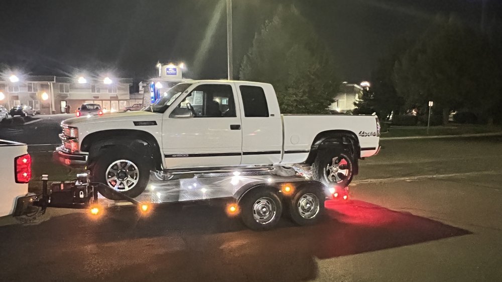

Thanks. It is still a 50+ footer during the day. Started to scuff paint for respray but the GM Patented Self Delaminating Paint affect in other places made that effort worthless. Will remove it all and then reshoot…eventually. Yes, Discount Tire sourced the wheels. Last October I purchased just one with a bottom of the line tire to go on the front along with the spare on the other side so the truck would load on the trailer. The Cepeks stuck out too far to clear the fenders when the truck was hauled up to Washington.
I liked the look and decided to go with these.
Noticed that a couple of other trucks in the area have them too. Oh well, imitation is a compliment with trucks I guess.
