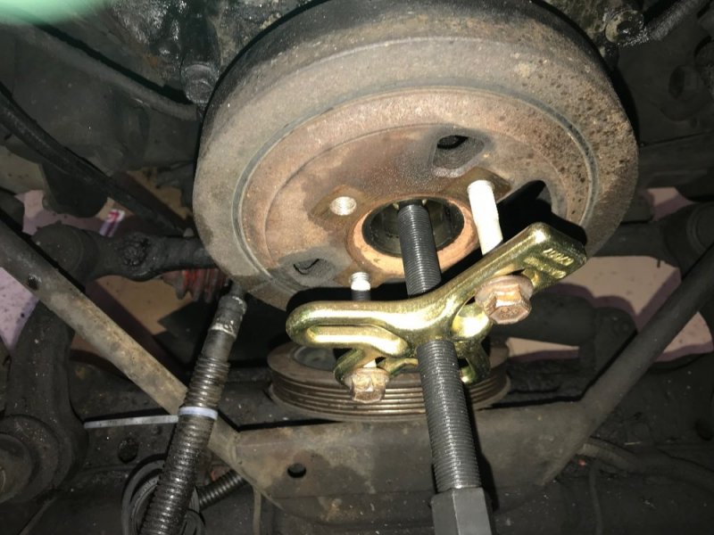

I was able to remove the Pulley and Harmonic Balancer by removing the radiator. Gave clearance to use impact wrench to get the Pulley off as the bolts were just tight enough to spin the motor. OEM HB came off with the puller tool just by turning the bolt by hand. Wow.

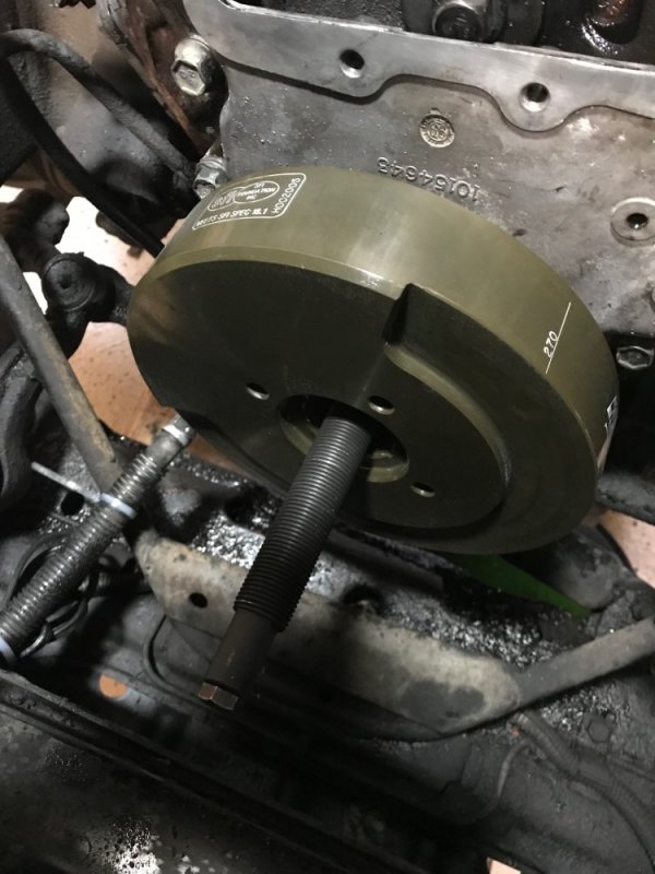

The Fluidampr going back on...not so much. It fought the whole way with the install tool until it about broke. Then the HB Bolt like AKDieseldriver told me he'd used. It fought some more but, I prevailed.
It ain't coming off anytime soon that is for sure because I tried. Why? Glad you asked.

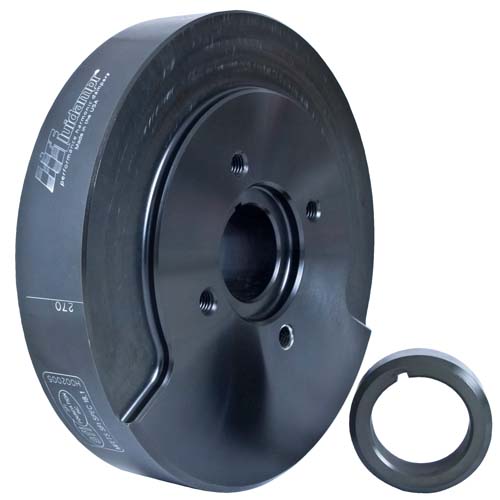

When I got done I picked up the box and this "ring thingy" fell out! Uh oh. Why do I have to everything at least twice?

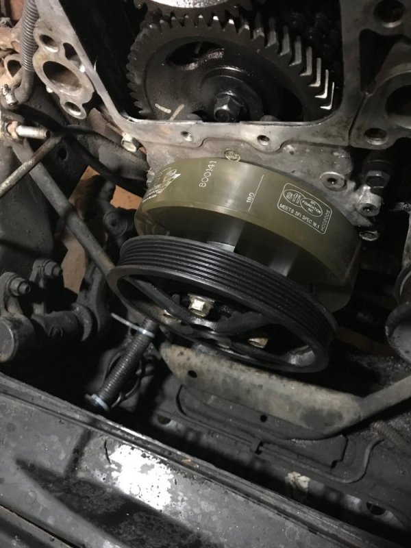

I panicked, tried to take it off and it said, 'no you won't either!" It moved a little but, it was making me nervous as all get out. So I stopped and did a lot of searching and found install instructions and specs on Fluidampr's site plus a couple of threads. One on DP that helped a little and a better one here on TTS (naturally) from 2010 that settled my beating heart. Thank you BTSayles. My part number is 800141 which is the one piece with about the same depth (2.44") as the OEM unit (~2.7"). The $%^& ring is over 1/2" thick so it would put the pulley out of alignment if used behind the HB. Bolt won't spin any further than it currently sits anyway.

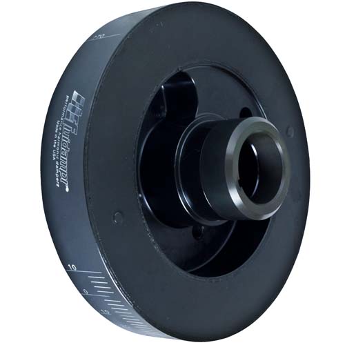

The 800191 is the two piece unit and measures at 3.18.
So, hopefully, the ring seems to be a souvenir to hang from the mirror or it goes on the front or, I'll get news tomorrow from Leroy that I do have to get the HB off and do it again.
I got the bolt set to 200lbs and it isn't moving any further. Pulley lines up with the PS Pump and AC so I know that is correct. Next time...never mind, there won't be a next time...I hope.
Directions, smecktions...Actually, I do read them and they didn't say squat about the spacer. Hence the surprise.
Thanks EWC and Deejaa, I really didn't want to try to get that thing off of there.

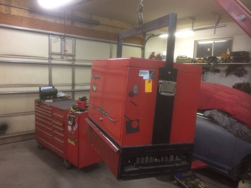

Pulled the front top member of the truck box away from the back of the cab.
Something that happens when the road chest is not tied down and someone unexpectedly stops right in front of You. LOL
Snap On road chest went slamming forwards, tipped it over, no tools were hurt in the making of that would be wreck.
It did take a while to get the tools all laid down so the drawers would properly pull to open again. LOL
Lesson learned, always tie down the road chest. LOLOLOL
The road chest after the wreck. LOL
