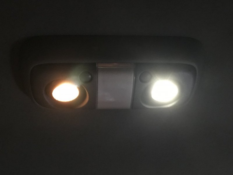

For the fun of it, here's the old incandescent 168 bulb and new LED bulbs in the Reading Lights side by side to show difference. Camera makes the dim one look brighter than it is.
Getting those things out was a bit of a challenge until I thought of using the Gorilla tape. 2 in piece folded in the middle and joined for an inch leaving 1/2 inch to adhere to the lens ("T" shape). Holding on to the base, push up, 1/4 turn and out it comes.

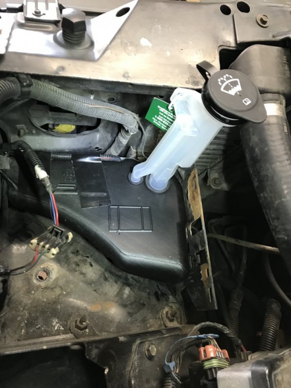

Today's fun was getting the new washer fluid bottle installed. PO had a unit out of a 95 (mounted next to the ABS). He'd cobbled up the pump using added hoses etc. and it wouldn't hold prime and I want that space for other things. LMC sells a kit and it goes straight in without fuss under the battery where it's supposed to be. Tape is to hold the pump wires and the water hose in place.

Those LED lights look good, I need to do this. First I need to replace the interior light switch on the passenger side of the dash. That thing just broke and my lights are out. How hard is it to match up the right LED lights on SuperBright.com?
I got a set of Bilstein 5100 shocks for April's 4Runner. Sounds like that's my Sunday job.
Matching up the bulbs is a challenge only in that you have to know the diameter of the stock bulb and compare to the ones offered on the Super Bright web page. I used the 194s in the Map Lights for the driver & front passenger. There's room between the reflector and the socket for those to go in. Its the four reading lights over the 2nd and 3rd rows that caught me...twice. I ended up using 168 bulbs from Sylvania as I want the job done. Now I have plenty of spares. Good thing these things last forever...no...wait...dang it!

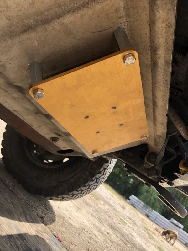

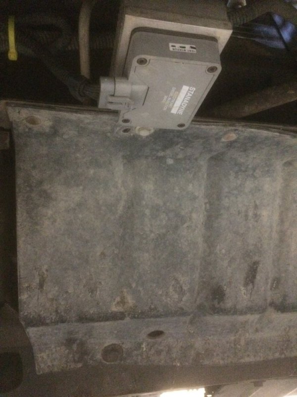

Installed PMD plate on skid plate, but need more space between it and skid plate to accommodate Dtech PMD plus heat sink. Suggestions?

The PMD on the 2000 is mounted forwards of where You are mounting Yours, a bit higher too. Right under the radiator support cross member.
