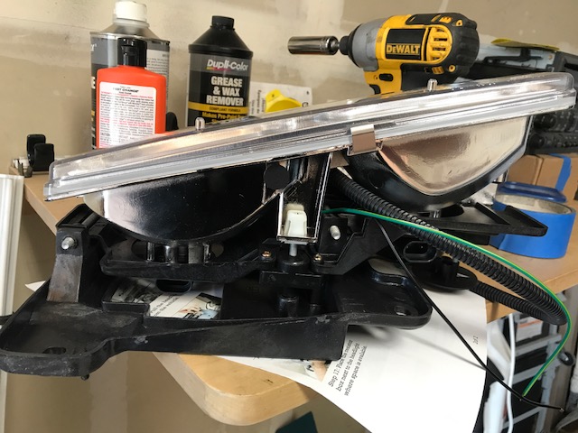

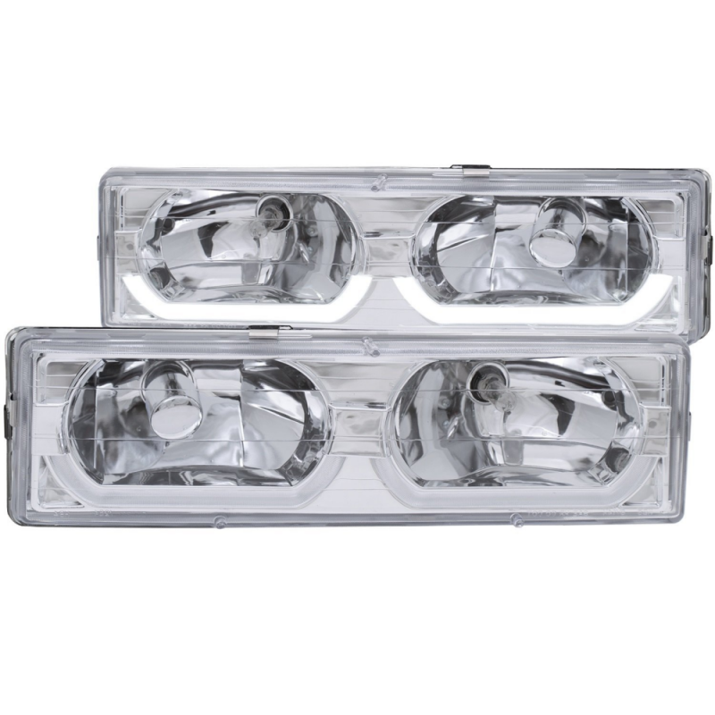

How about some good pics of the reflectors when you get them?
They seem like fair quality. Same construction as the current units I have on the truck. Those I got from LMC and they are better than a different set up I purchased and sent back from another distributor. I thought these buckets would have more of a hexagonal sculpting, at least that's what the pictures seemed to show. Just an illusion formed by the horizontal lines on the lenses.
Shot of the unit from below shows the typical shape of the buckets.

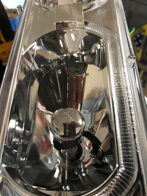

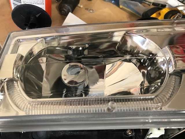

Low Beams. They have the Bulb Cap on the low beam side that my current ones have and despite running the Superwhatevers from Sylvania, those have stayed put.

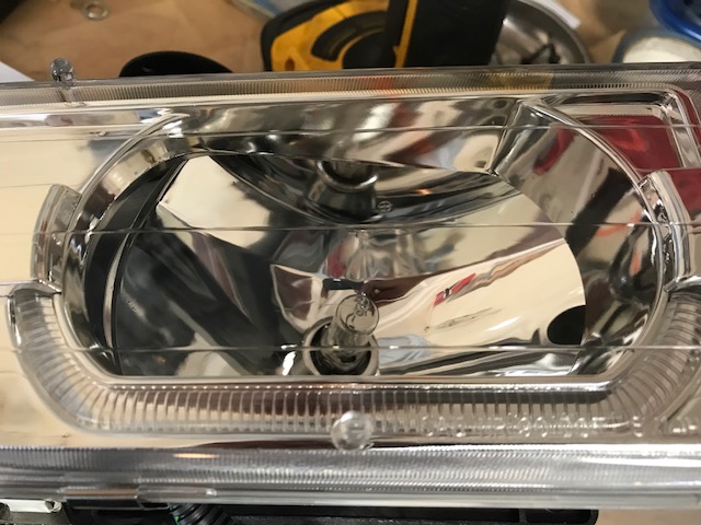

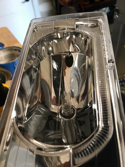

High Beams.
The directions are written very well too. These are written specifically for a GM-400 and if one had never done a headlight swap, these will not leave you in a typical 'Haynes Manual' dilemma / conundrum of 'What, where, how, AArrrggghhh!'
