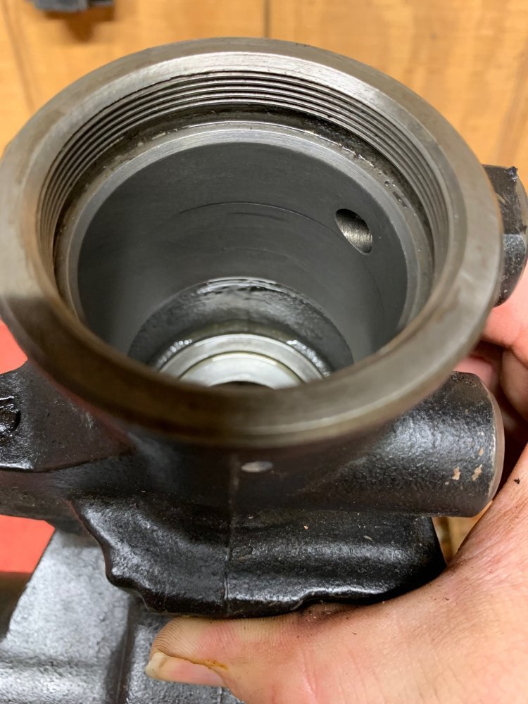

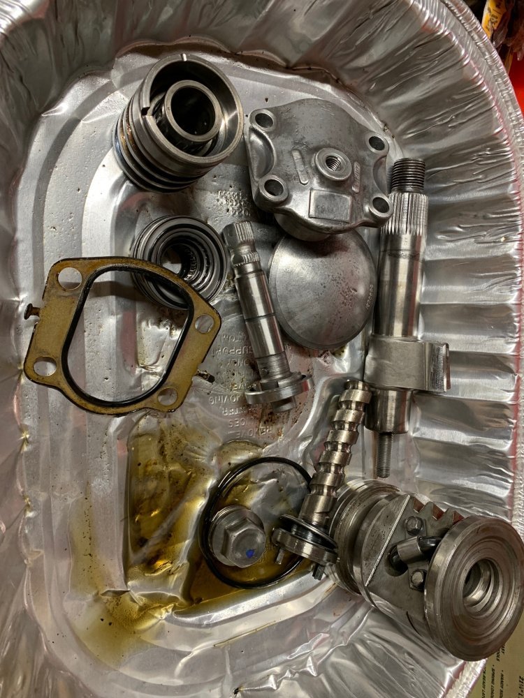

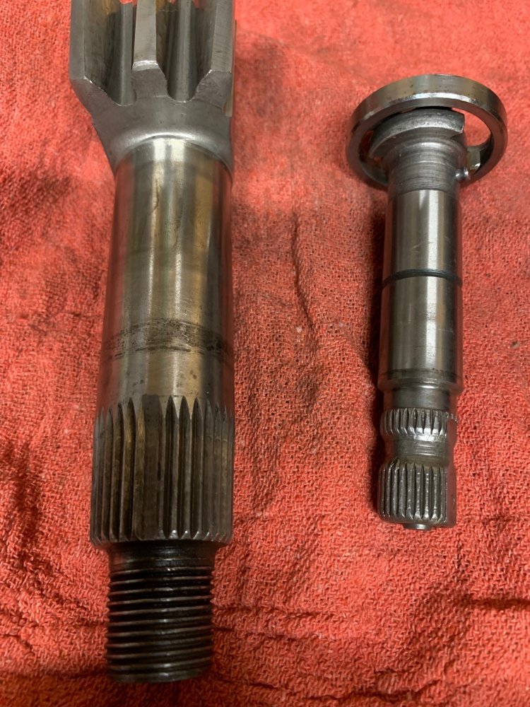

I did some more cleaning on the gear box this evening in anticipation of the kit arriving tomorrow sometime. looked over the housing real good for a bit. I think I will wait to attempt porting it for a hydro-assist cylinder, I have the tools but I am mainly rebuilding this one to see (1) if I can do it, and (2) if this fails I will need to cough up some green paper for a new box. Here are some pics of the box guts. the input and sector shaft cleaned up nicely with the wire wheel on the splines getting all the gunk and paint out of the groves.
the housing has some scaring in both the piston area and the spool valve area. you can plainly see them but can hardly feel them so I hope they will be okay, the box wasn't leaking just had some play on the sector shaft.

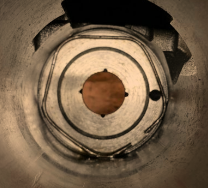

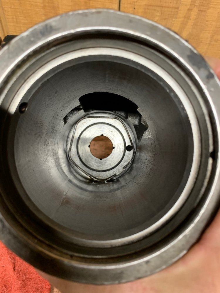

one think that I am curious about is what that hexagon retainer looking thing is that is down in the bottom of the piston area. I didn't remove it but looking at rebuild videos online and other sites, I can't seem to find any info on what it is or it's purpose. Anyone have any ideas? It's not holding anything in there.

anyone figure out what that keeper ring is that sits at the bottom of the piston bore on the steering box? I took my pick and moved it. it's loose in there. two of the corners aren't even touching the bore wall. I am wondering if it's just to keep the piston from bottoming and closing off that port completely.
I think You guessed it.
