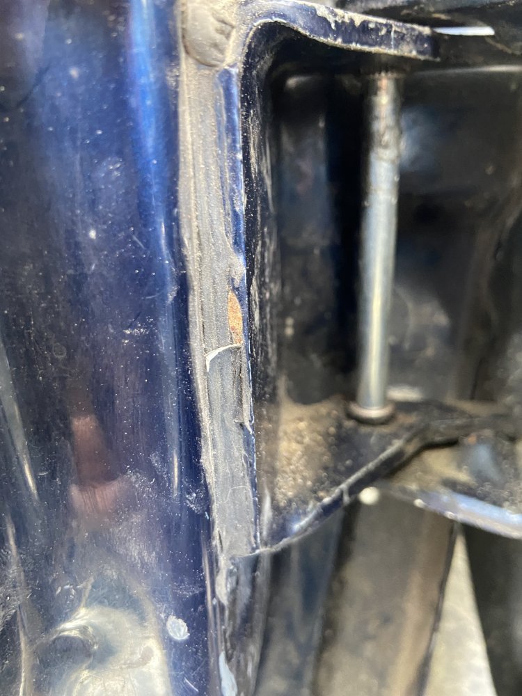

Did some door work today on the ‘99 Burb. Replaced the latch, interior handle and lower hinge pin. Need an engine hoist to replace the bushings, so passed on that and pushed the broken piece of bushing down into the hinge for now. Neighborhood mechanic is on vacation with his family so no access to hoist. Mine is at the Fullerton home and no room in garage to store a new one here in Montana.
Latch was sticky on the lock, preventing the actuator from fully pulling it locked. Works great with the new latch:
Interior handle was bent from forcing door to open as the broken bushing caused it to sag onto the latch pin. New handle and it’s working great:
Also works from outside:
Slid that bushing piece down into the hinge for now:

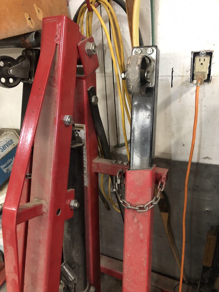

Engine hoist works so nice.

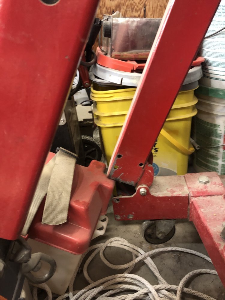

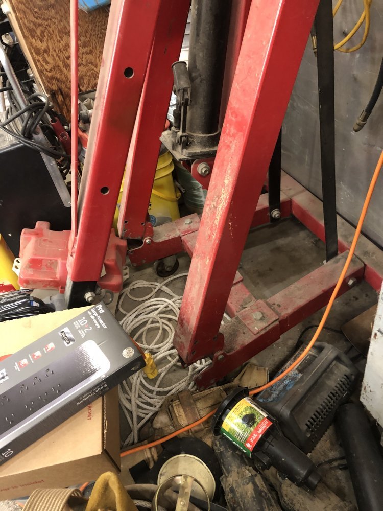

I sawed off the two forward floor legs on my hoist. Installed casters on the portions that was left. Used some 1/4 or 3/8ths inch flat and made two side plates with a hump on each one that sets above where I wanted the legs to pivot. Had three 3/8ths holes drilled through each side plate so that they would align near perfect after side plates was welded on. Got the three holes drilled through the two forward legs, the 3/8ths bolt for the top hinge pins. Now the hoist folds with the levs pointing rearward and up. A couple pieces of ligjt chain around each leg to a support to keep the legs from falling rearwards. I’ll try to get a pic of the contraption tomorrow morning, if I dont have to move stuff to het it into a photographic position.

I own a 2T engine hoist with folding legs, too, @MrMarty51. With everything folded and stowed, it only sticks out a little over a foot when I roll it up against the garage wall. I just found the floor jack to be just fine for the change/installation of new hinge pins and bushings.

Pushing the broken bushing piece down into the hinge works right now, but it does ride up and you need to stay on it.

I may need to look at replacement hinges. They're like $24 per side, but the question is how to install while ensuring alignment.
I tried, but without a second set of hands, it gets tough.....and my wife is a one-armed priest maker right now.
I did mine by myself. Did the upper hinge first, then after it was done did the lower hinge. Only needed the 3½ ton jack to hold the door's weight and to make minor alignment adjustments for putting in the new hinge pin after driving out the old bushings and driving in the new ones.
You need to undo both hinges to be able to pull the door away for enough clearance to get the bushings in, then slide it back in to get the pins in.
I too would like to know how to replace the hinges and still get proper alignment. sure would have been nice if they left them bolt on instead of welded in place.
I suppose it would be a lot of work, but one could pull the door off, then drill through the hinge and pillar, cut off the old hinge and use the holes as a template to drill the new ones . make a backing plate to go inside the pillar for support with the same holes drilled. then bolt it all together and be done without welding them back. even once everything gets drilled, the holes in the pillar could be egged a little for minor adjustments like the old trucks had, also tack weld the nuts to the inner plate.
