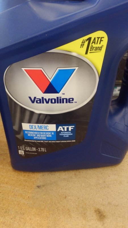

I'm seriously about to throw in the towel on this... It costs me 30 bucks every time I have to go to AutoZone from here. Walmart is twice as far in either direction. And to add insult to injury I bought the first fluid on a credit card. I returned that today and bought the other fluid on a credit card... Here's the insult to it it'll take 5 to 7 days for that money to get back on the cards and I'm about to s*** out of cash.
Doesn't your AutoZone deliver? I know NAPA does as do O'Reilly's and Advanced here in Lincoln. Dex III and Mercon are the same fluid. If the bottle says Dex III/Mercon then you are OK. Now, Dex III is NOT cross compatible with Mercon IV and vice versa. You won't find straight Dex III in a bottle anymore, GM stopped licensing the name and let the patent expire about 20 years ago. They (GM) have come out with new formulations of Dexron since for the newer types of transmissions GM is making, all supposedly backwards compatible with earlier fluids, but as has been said on here before, Dex VI and older trannys that used Dex III aren't happy with each other long term.
You're over thinking yourself into a giant ball of frustration. As long as it meets ATSF and Mil-Spec standards (read the back of the bottle) for the fluid, it doesn't matter whose brand name it is. It will even say on the back of the bottle "Meets Manufacturer's specifications for Dexron III or Mercon fluid when called for" or something to that effect.

Dex/merc fluid unless you want to rebuild your trans in 6 months to a year. Dex vi fluid is not fully compatible with older seals. It is a thinner synthetic fluid that GM came out with to try and eek out a tad more mpg's, and being a synthetic base stock with no additives to reach the desired viscosity, it is classified as an extended drain interval(or filled for life as the OEM's call it now) fluid. Over time it has been known to dry out older seals leading to leaks. GM & Allison got into a legal dispute over this when Allison released there TSB advising Owners with transmissions built before a certain serial number to not use it.
@THEFERMANATOR just to be clear...I should go back and get the bottle that say Dex/Merc and forget about what numbes it has. It doesn't have to say Dex III/Merc or anything?
Dex3 and mercon are basically the same fluid. You won't find a bottle labeled dex 3 as the patent ran out on dex3 back in 06. Just make sure it doesn't say dex vi compatible on it.
@ Husker6.5 story of my life...just paranoid I'm going to screw this up somehow..lol I got lucky to be able to get the tranny for it, although we have no idea how good it is cause it came from a junk yard...but was marked "ok" so keeping fingers crossed. I got confused cause guess keep saying dex III so that's what I kept looking for..
