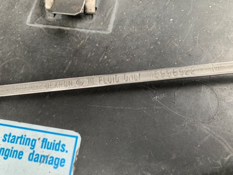

Dex VI is a synthetic fluid too. if I'm not mistaken Dex III was gm spec but the newer versions of Dex are supposed to supersede the older ones. at least that is what I am told. there should be some spamping on the dipstick that will show the GM spec numbers for your trans
What I'm concerned with is on the old transmission when I did a fluid and filter change on it we put Dex Merc in it and that was the day that it started acting up and was never right again. So I just want to make sure I put the right stuff in this one.

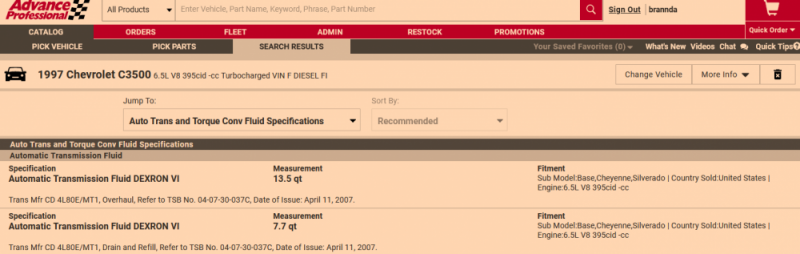

Don't know if this will help but I found this TSB online for the fluid. I looked up the fluid spec on AAP for my 1995 and it shows the same Dex VI same amounts
