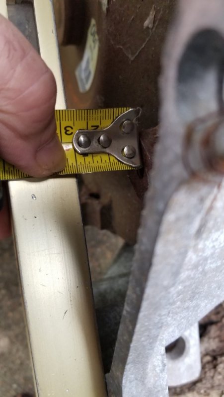

The 1" mark is at the end of my thumb. Trying to hold the straightedge and tape measure with one hand and my phone to shoot the picture with the other. Ignore the 2 & 3 on the tape, that's the metric side in Centimeters (dual metric/english tape, very handy when working on metric things!). Hope this helps, @Stoney.1634252585300452450416513608069.jpg
