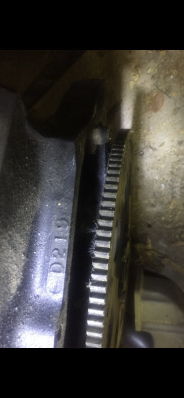

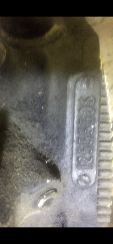

Just out of curiosity with the transmission out shouldn't I be able to get a picture of the numbers on the back of the engine the ones that tell you what engine it is so you know if it's a good one or a bad one
