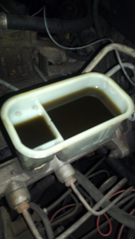

Another thing I forgot to mention..
Under the cap on the master cylinder you have that weird black rubber thing that has the two circular pop out bowl things...
(Yeah I love my redneck description).
Anyhow that thing always sucks the bowl things down in to the MC.
The gasket/diaphragm? Yeah, it's supposed to do that. As the brake pads/shoes wear and the fluid level in the reservoir drops, it creates a slight vacuum in the reservoir that draws down that diaphragm to take up the airspace that would otherwise attract moisture into the brake fluid.
@Stoney with a full MC those rubber thingys shouldnt get sucked down, at least mine doesn't unless the MC gets low of fluid. if there is an air pocket inside the ABS unit or your rubber brake hoses are balooning when pressing the pedal, that will cause those things to also get sucked down.
Yeah, exactly what I was saying. New pads/shoes and full reservoir they're flush with the diaphragm. As the pads/shoes wear and the caliper pistons/cylinder pistons move outward to maintain the distance to the rotor/drum, the fluid level drops in the MC creating a vacuum that draws them down to minimize any air space that would contain moisture that would contaminate the fluid. So popping off the lid to find those hanging down and the reservoir below full is normal after several thousands of miles of wear on the pads and shoes.
