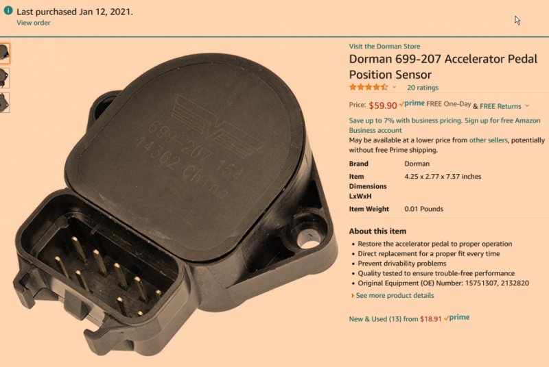

@Stoney the pedal position sensor doesn't effect the lift pump operation, but when you say at times you step on the pedal the truck does nothing as if your not stepping on it or are you feeling hesitation like the truck is trying but not responding well? the reason I ask is because I had a very similar issue where there were random times when I'd start to press the pedal slightly from a stop not trying to move very fast due to being inside my work (speed limit 10 mph) and my truck did nothing as if I wasn't pressing the pedal. no SES light ether. after it happened a few times I connected my laptop and saw there was a code for the sensor mounted on the accelerator pedal. I replaced it and never had that issue again.
@dbrannon79 . What was the name of that sensor and how much did it run
this is the one I bought from amazon, but this was before I learned how Dorman parts were junk! I would check on @RockAutoLLC to see if they offer the GM Delco part. plus the 5% discount for us as members of the forum :)
mine is a 95 model so your's may be different being a OBD2 system. check your codes for APP circuit and also look at the live data. this sensor is like three TPS sensors built into one. so there will be three readouts in the data stream showing, youll need to watch all three. if only one protion is not working it will set a code but not turn on the light. two or more and youll see both the SES light and "service throttle soon" light too.
