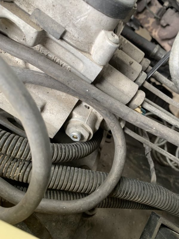

Here is a couple but these are on the older units. ours have pins on both sides. one is visible by opening the hood and looking down at it, the other one is on the opposite side which is the pin on mine that popped out like a button. I popped off the rubber cap and stuck a small screw driver in on the pin and forced it inward. it snapped in (flush with the valve) and started working.

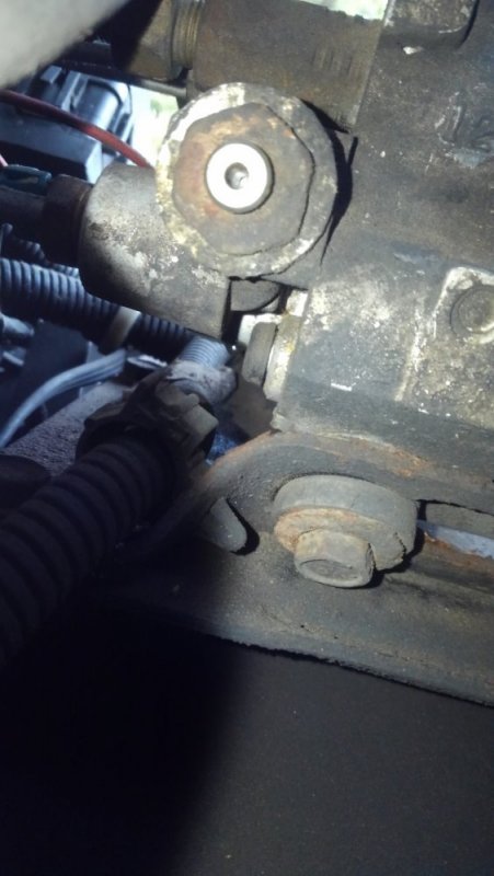

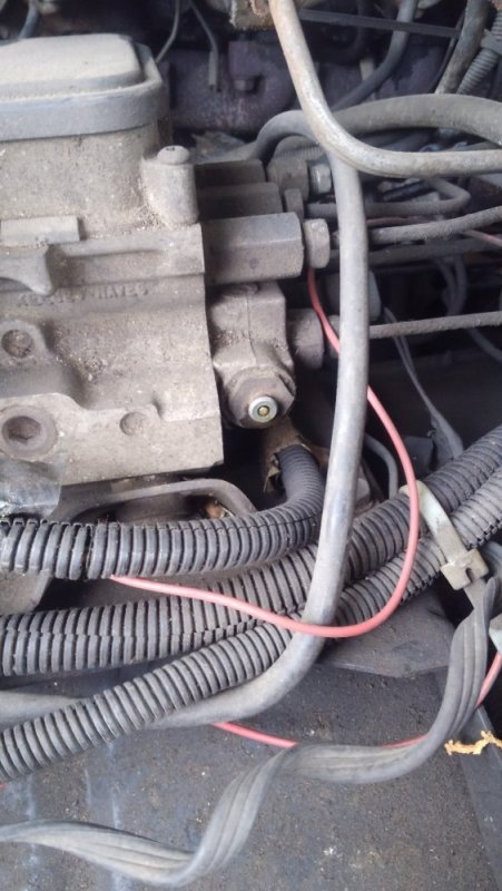

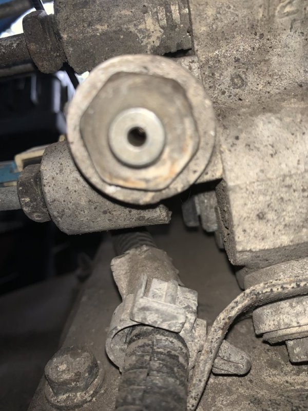

I found them.. I'm going to attach the pictures if I can the top one looks like it is flush with the nipple that it goes down the middle of... The bottom one looks like it is way in
From the video I just watched it looks like the top one is where it belongs... The bottom one it looks like it is either pushed away in or there's no pin in there at all
I will go look at mine and see what position it's in now. others may chime in on how theirs are as well. if I'm not mistaken that pin runs solid all the way through one side to the other but I could be wrong.
Here is how mine is. Look the same as yours unless mine is wrong too lol. Others may have more knowledge on this. I know the bottom one is the one I pushed in as it was sticking out after I did my brake job
With them being same on the two trucks, seems like that’s not it.

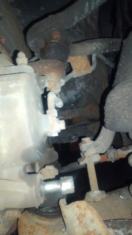

After I left the garage today I looked under the truck, one of the driver's side caliper pins wass 3/4 of the way out.... The other one was loose... About the same on the passenger side except the one that was sticking out some it was only about halfway out.. only holding in by a thread or two
Time to baby it home, pull the front wheel and get that fixed asap! when you pull the wheels take some photos of the pins and post them up. it sounds like your about to have a caliper fall off that possibly can cause a wreck.
