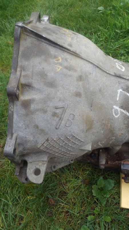

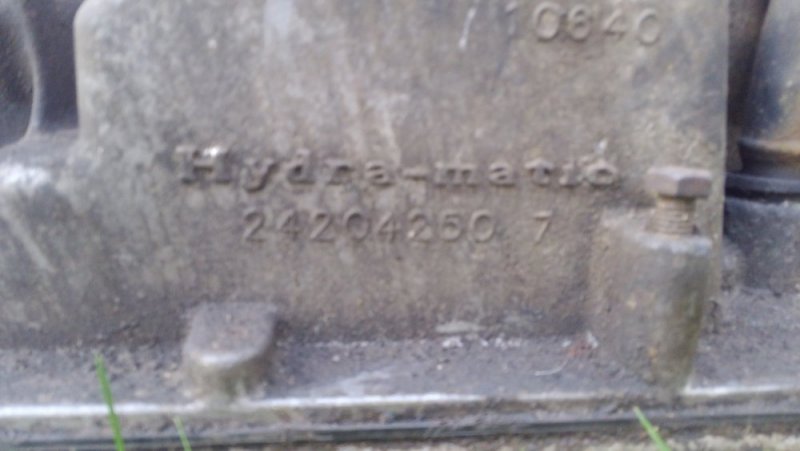

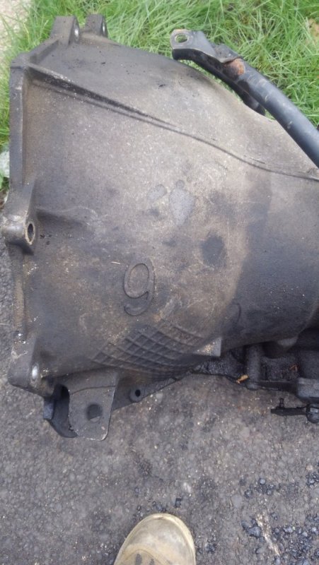

The last two have me confused... The bellhousing with the nine on it is the one that came out of the truck the one with the seven on it is the one I put in... Any idea what that means?

Man, I hope those first two pictures with all that ground up clutch material in the bottom of the pan was the pan off the old transmission, not the new. No clue on the different numbers cast on the bellhousings, maybe year of casting/assembly? Perhaps @THEFERMANATOR would know.
