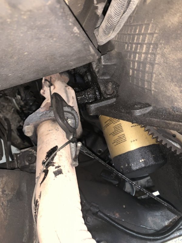

@Stoney here’s the photo I promised of my hideous looking repair I did using furnace cement and fiberglass exhaust wrap with the c clamp holding the one broken bolt. It’s gotten me by for several months. I’m dreading the day I have to put it apart to deal with the broken off bolts!
They are at two pieces set it's actually two different rings one goes around the manifold above the flange and the other one goes around at the crossover pipe by the flange you see you can spin it around then you put bolts between the ears on the clams you don't even use the ones they're on the manifold
If you end up going this route as a repair let me know how well it works. You might encourage me to fix mine plus installing a better crossover pipe to better match my 4” exhaust lol
I would rather have the studs and nuts too. @DieselAmateur
At least if a nut is seized onto the stud, it can easily be heated so that it will free and spin off.
If I ever again have to pull the CO pipe on Mine, there will be stainless steel studs installed and SS nuts too, with a liberal slathering of copper antiseize.
Right on Stoney, I see looking at the picture now how the clamps you got work. Looks like an upgrade from threading into the exhaust manifold for sure. Worst case scenario if things shear or get stuck you could just destroy the clamp removing it instead of having to eff with the manifold on the engine.
