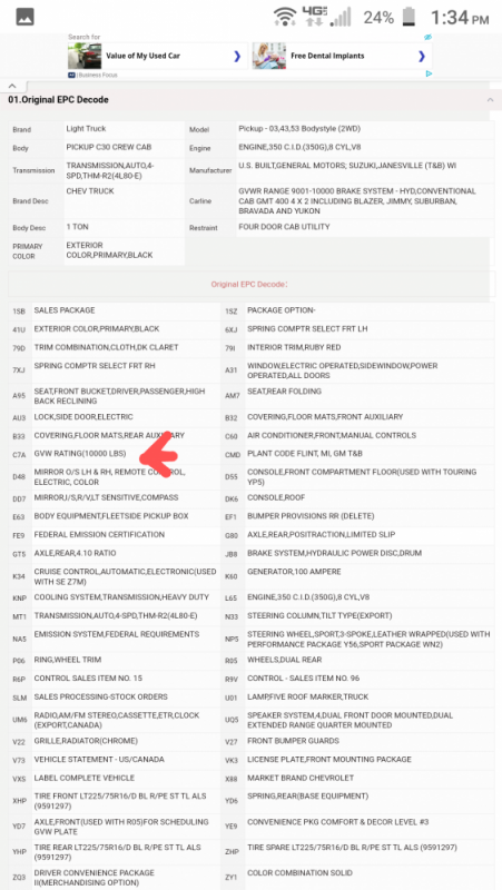

@Stoney when you are using some of the online sites to decipher the vin some are not accurate. it would be best if your original glove box is not in the truck with the sticker, stop by a GM dealer and talk to the parts guy. ask for a print out of all the RPO codes on your truck. I had to do this and they gave me a print out of them with all their meanings. it has been very helpful when trying to get the correct parts. I had this very issue when I replace the brakes. the auto parts gave me a set of wheel cylinders for what they show for "SRW" but my truck has an odd GWVR of 9,000 lb. I actually needed the ones for a dually with the larger bore.
@Stoney I am used to SRW in 2500/3500's. You have a DRW, 6 tires, thus the higher 10,000 LB rating than the numbers I used. (There is a light duty 2500 6 lug that's no end of confusion. )
I believe the largest brakes were on the DRW pickups as far as wheel cylinder sizes for example. Some of the rear disc conversion threads or drum brake upgrade threads mention use of DRW parts.

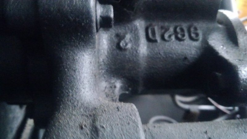

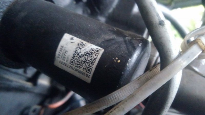

@EWC gonna attempt the hoses tomorrow.. hoping I don't break a line cause if I do it's game over.. do any of y'all know how to identify a hydro boost by the numbers that are stamped into it.?KIMG4922.JPGKIMG4925.JPG
I took that last series of numbers. 75273231 and crossed them to this. That seemed like a GM part number.
