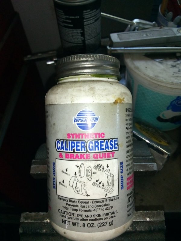

I got thinking about something this morning, when you put the caliper into the bracket, I'm sure y'all have had that fight trying to wiggle it in there. Seems there's only a microscopic amount of clearance for it to slide in. So that got me thinking should I grease the bracket and caliper where they slide together against each other? Wouldn't take much for a caliper to hang up on that bracket when it's trying to release. I know they don't actually slide on it very much but it wouldn't take much either to hang up.. and it would explain why after a little while it breaks loose when it does hang up hit a bump or something and it breaks loose and rotor can spin free. I thought about loosening them up and putting something bearing Grease on them but wasn't sure if that would be effective or a risk of it getting down into the brake pads. What is y'alls thoughts?
Other issue , I remember telling you all that I've had to cut the back brake line going off the ABS to the back of the truck and pinch It off. Does anybody know what size brake line that is? Remember mine is 10,000 pound truck, I would trust y'all's knowledge more than AutoZone computer on this.
Yes, a LIGHT shmear of Hi-Temp Synthetic Disc Brake Grease on the caliper pins and any contact points between the caliper and bracket is a must to prevent binding and corrosion and should be part of any pad change/brake servicing. You want to use a light, thin coating of the grease on exposed areas to prevent excess grease from winding up contaminating a pad(s). Since they carry the weight of the caliper and are protected by rubber boots, a generous coat of grease all around the pin/bushing (if still using the old, two piece, style) or new one piece pin is fine.
@Husker6.5 @ak diesel driver .. thank you. I knew to grease the pins. (Although didn't know there was a specific grease for it.)
But never knew to grease top and bottom of caliper where it makes contact with the bracket.. (the flat surface on top and bottom).. I should have figured that should be greased since the calipers fit so tightly in there.i always have to fight them in and out when I pull the calipers..
