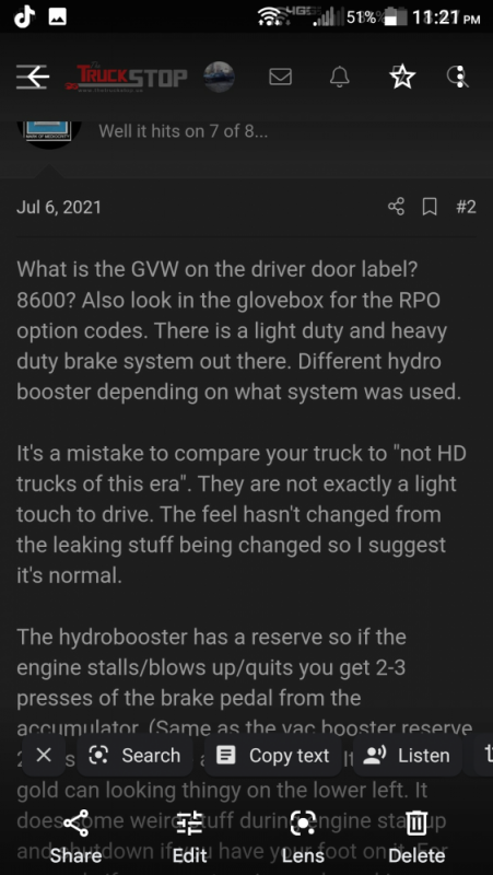

The thing that's messing me up is I remember @WarWagon mentioning one time that some of the trucks like mine have a door sticker for 10,000 pounds and some have a door sticker for 8,000 and some odd pounds... After running the VIN on mine it is a 10,000 pound one ton.. usually when I bought parts from AutoZone they just put in the year make model and kind of engine. And 2wheel drive... That's really making me question is there a difference between the 8000 lb and 10,000 pound brake system.. because all the parts I had bought before would be the wrong ones which evidently would still bolt up if that is so but that doesn't mean they would work right..
