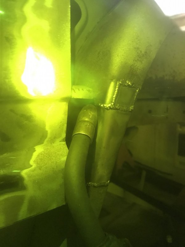

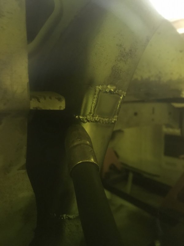

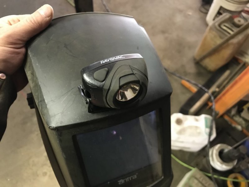

Today I did something I should have done years ago: I mounted a headlamp to my welding hood. I had a big LED work light shining where I was working, but it never failed that I would be in front of it when it came time for me to start welding, especially in tight spaces. This makes it so much easier to see your work before you strike an arc, even with an auto-darkening hood. I highly recommend this mod to anyone that welds. I simply got a battery powered headlamp, removed the head gear and then taped it to the helmet with double-stick tape. Voila!
Here are a couple pics from inside my hood. Of course the way it looks with a camera doesn’t represent how it looks with my eyes, but still you can see quite a difference.
Without the light.
With the light.
DUDE!! Straight Genius!
Thanks! You know I did some Google searching and I was surprised something like this isn’t all over the internet. I could have sworn that I saw one that clipped on the helmet on Amazon around Christmas time but I couldn’t find it. I found one by Miller I think that was basically 2 Mag lights that clipped on the sides of the hood - that seemed excessive....plus it was pricey. I started looking at headlights to adapt on Amazon but I got frustrated reading reviews and trying to choose all the options I wanted so I just picked this up at the local Menards while I was there for wire wheels. I really enjoyed using it! I think one that had rechargable batteries so you could use it for a day and then charge when not in use would be ideal....as long as the Lithium batteries could be sufficiently protected from sparks....

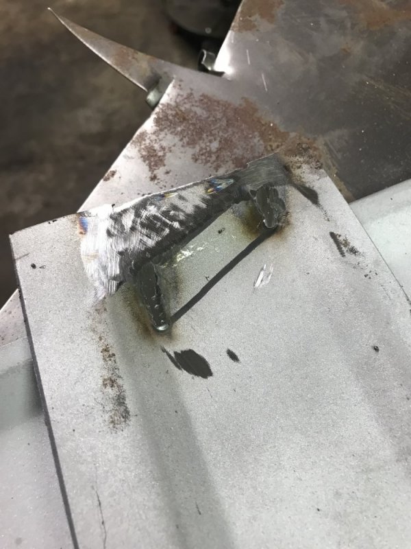

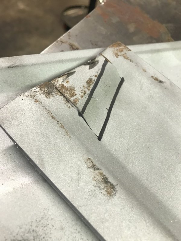

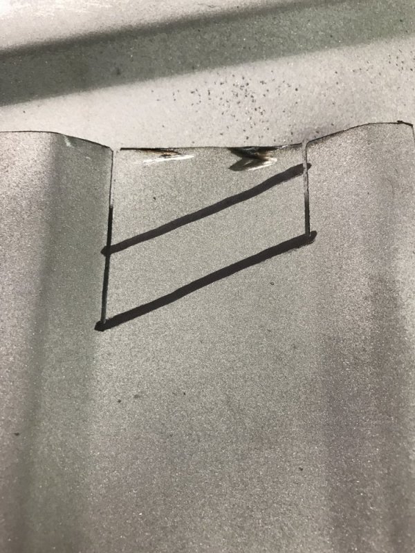

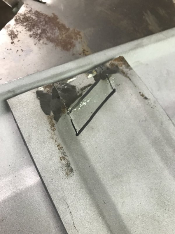

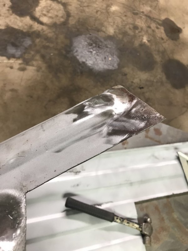

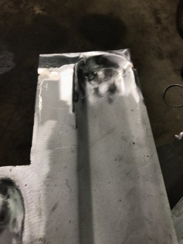

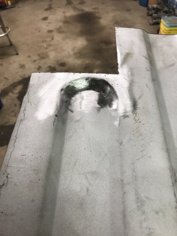

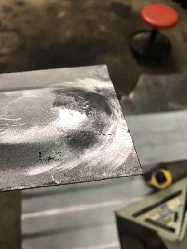

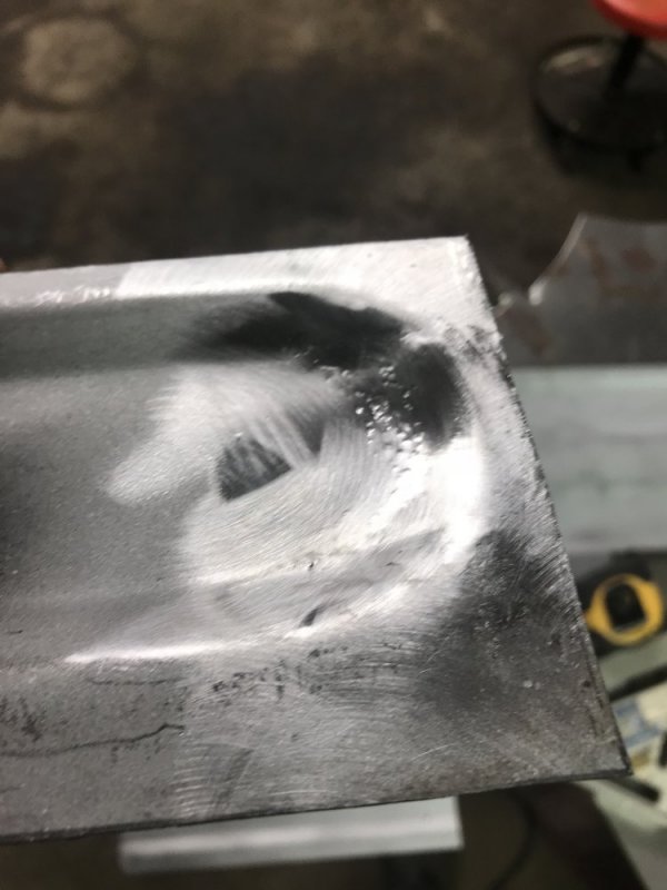

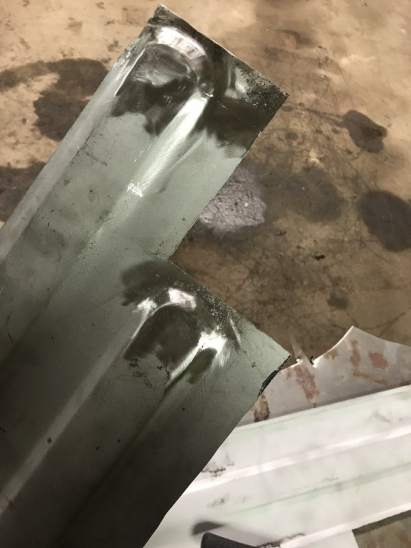

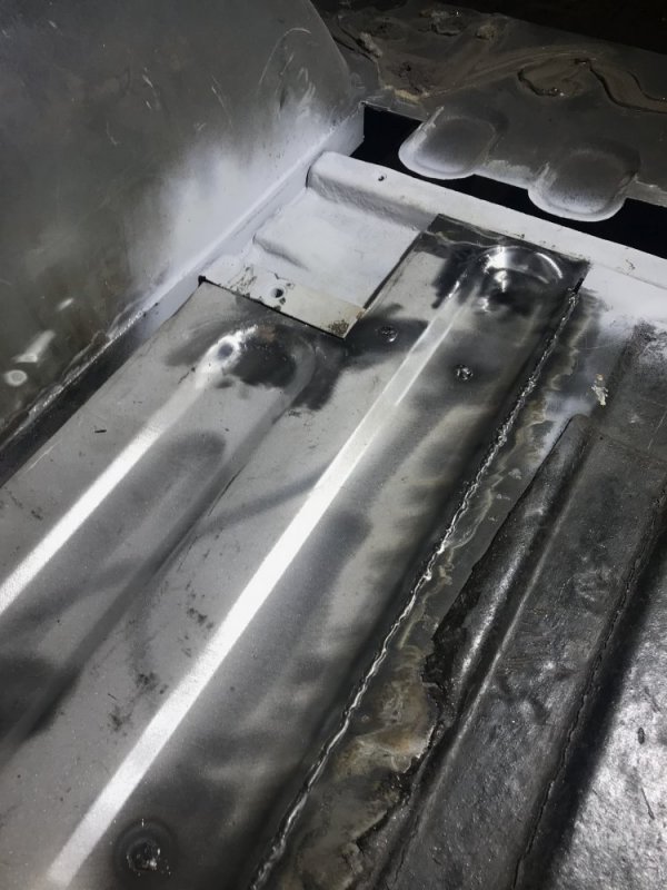

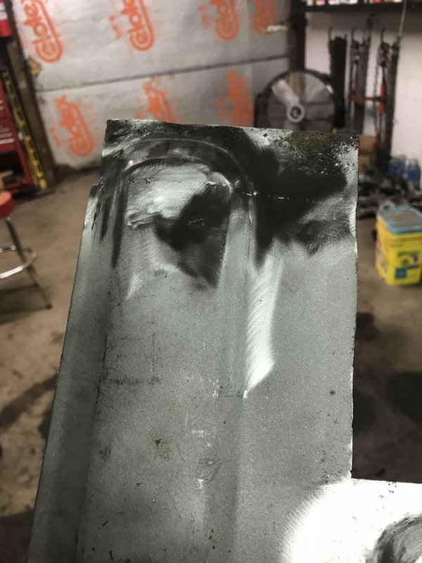

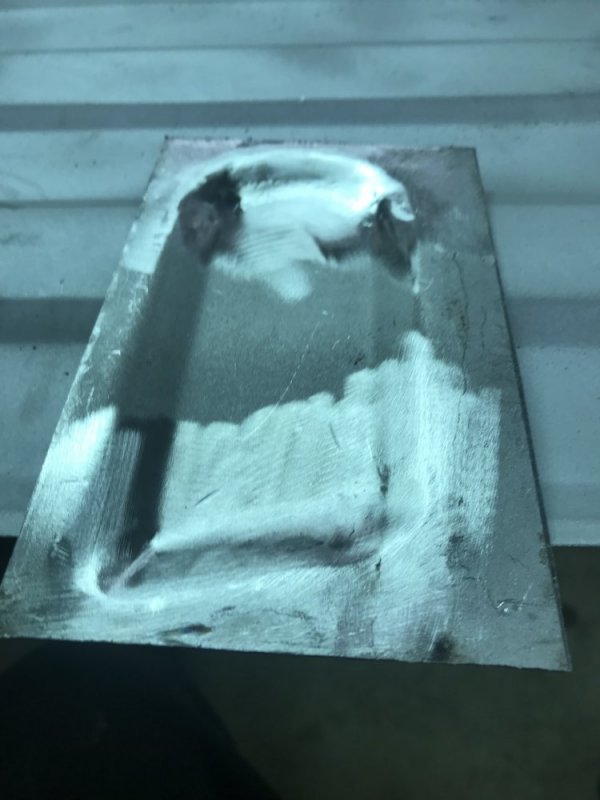

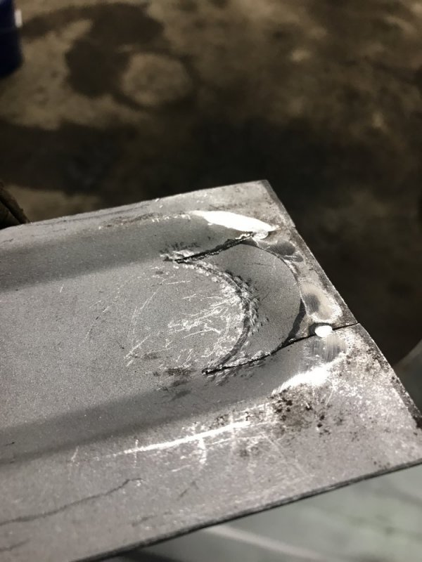

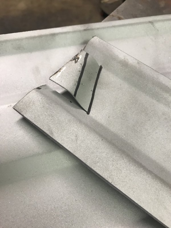

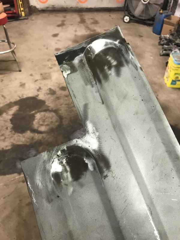

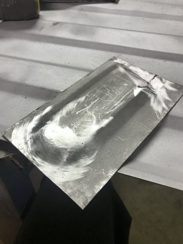

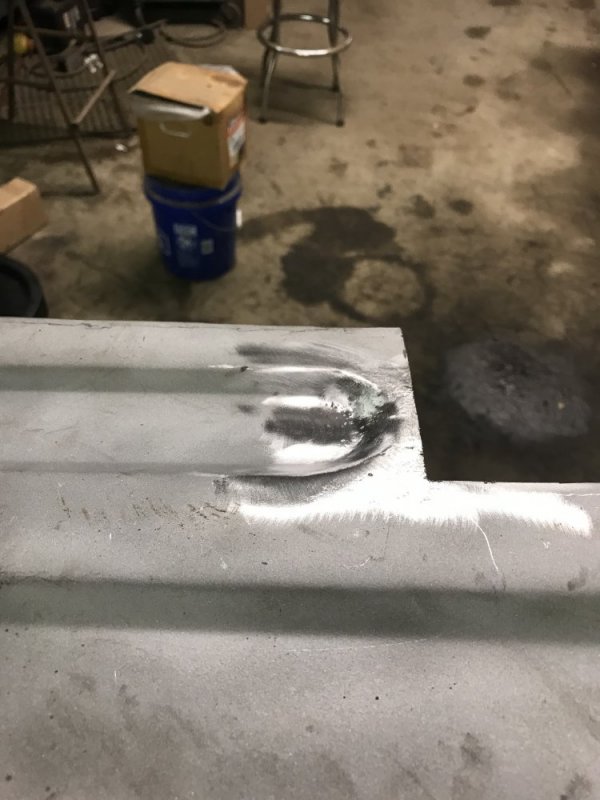

Not a ton of progress this week, but I did do one thing today I’m proud off. I bought a floor patch panel for the cargo area that is just a rectangular piece of the corrugated steel. There are missing details to match the existing floor. Those details are there for strength and clearance, so it’s necessary to have these shapes. I could have done a simple miter to make it fit, but I wanted to challenge myself to make the factory radiused indent. Even further, I wanted to do it by just making relief cuts, shaping and welding, not by patching together multiple pieces of metal. I should have taken pics of the process along the way, so sorry all I have is the beginning and the end. I’m pretty pleased with how it turned out. Yes it could be better, but I didn’t want to continue to work the metal any further and make it too thin - it is for a floor after all, which needs to be strong and will never really be seen. I also learned I need to take it easy with the pick hammer so there aren’t so many unsightly pocks in the metal! Anyway, here are the pics....not too shabby if I do say so myself. :cool:
Here’s what I started with:
And here is what I ended up with:

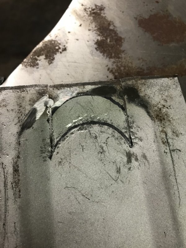

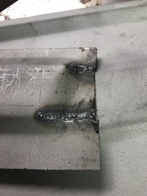

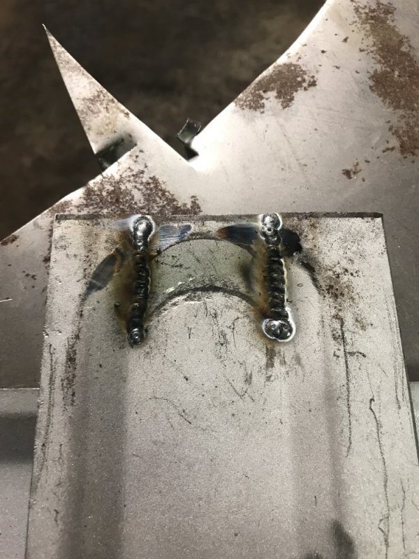

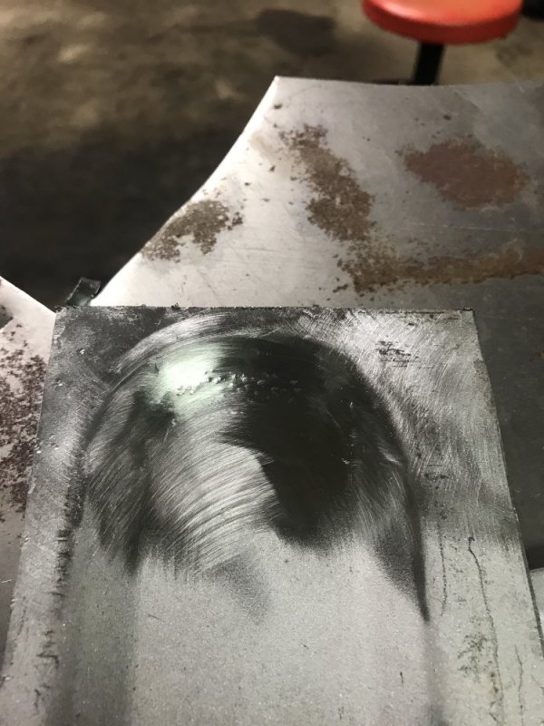

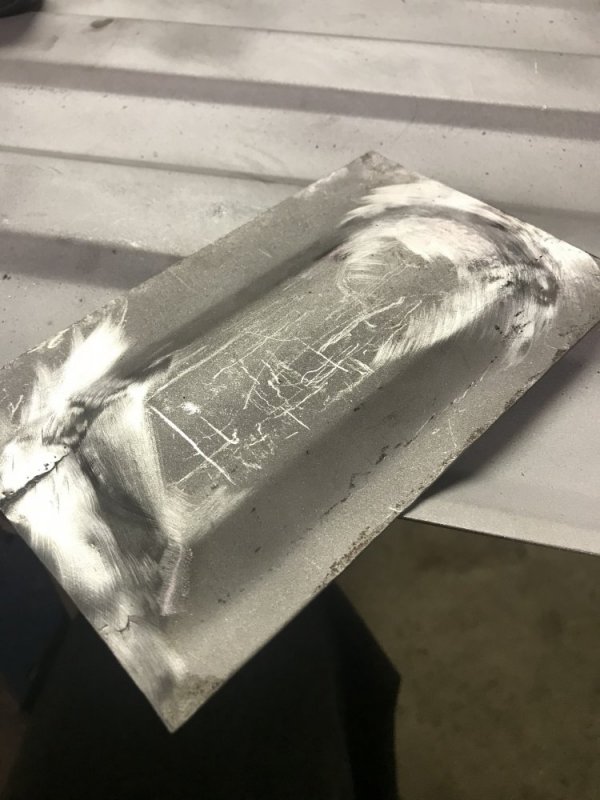

By comparison, this one I cut the factory indent out and welded it to the patch:
BC2879FC-FFA7-455A-8B6E-8FF4430645FD.jpeg38166095-A8AF-4863-954E-58E65E51DE4E.jpeg9D33983D-1FA0-4780-AC50-2AADBBDC23AA.jpeg

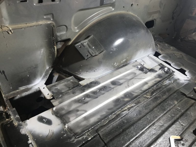

And here they are side by side. Mine is the shorter leg and the GM splice is the longer leg:

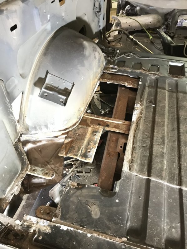

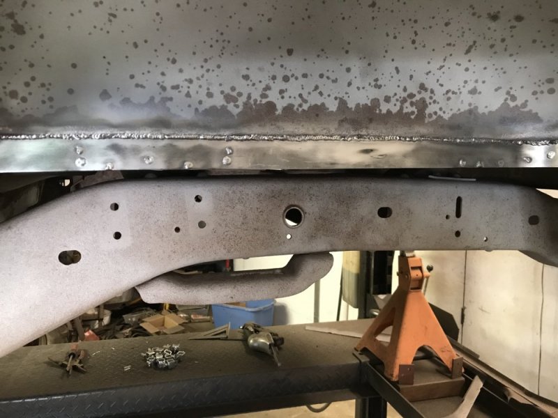

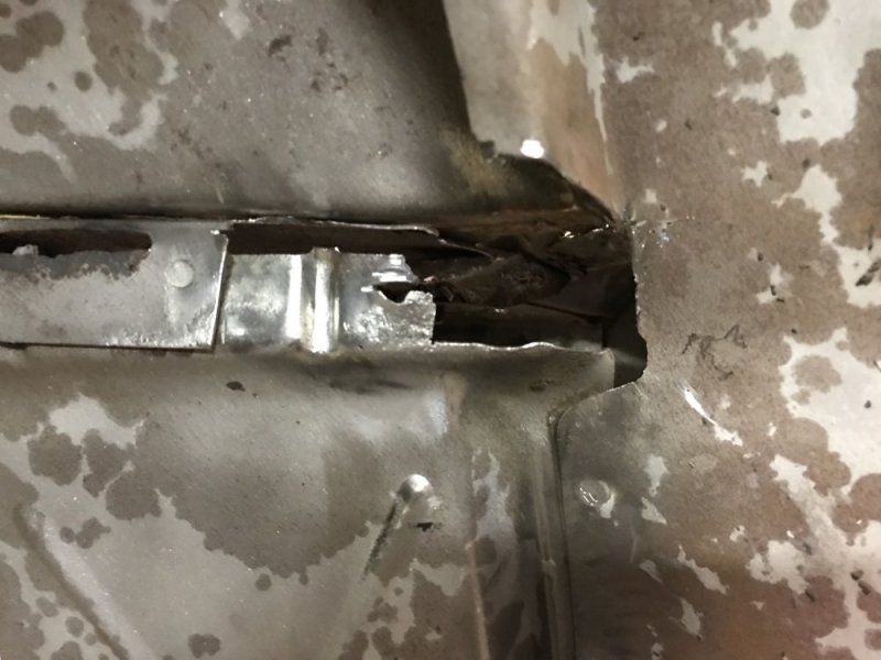

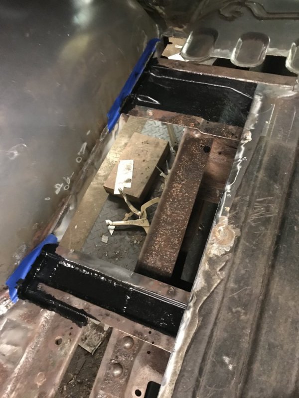

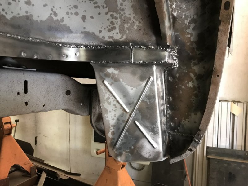

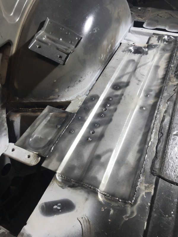

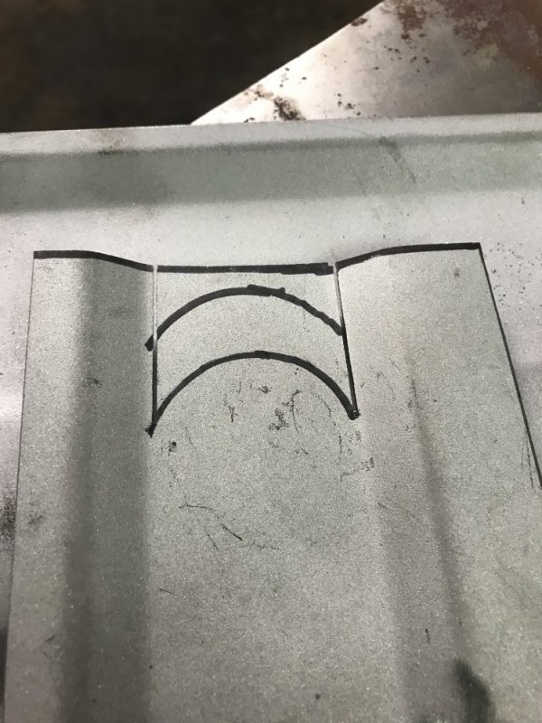

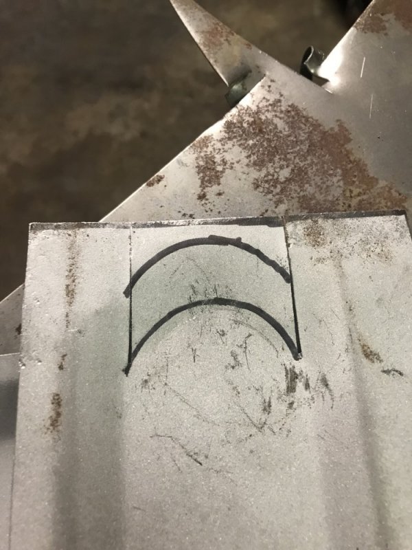

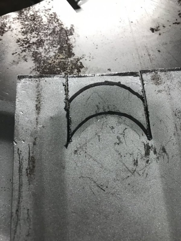

Last night I made some progress and forgot to post.

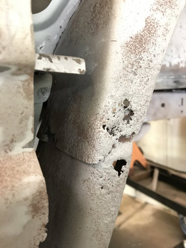

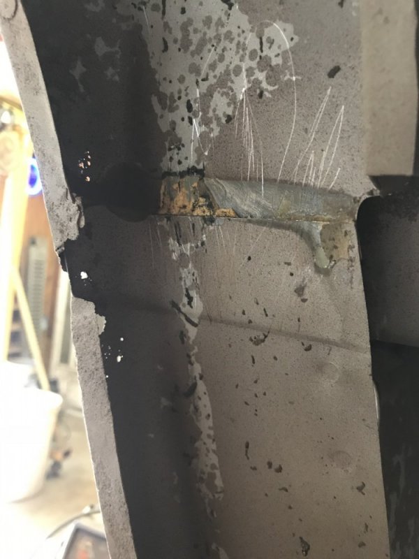

I painted the inside of the crossmembers I exposed by cutting out the floor pan with Rust Seal.

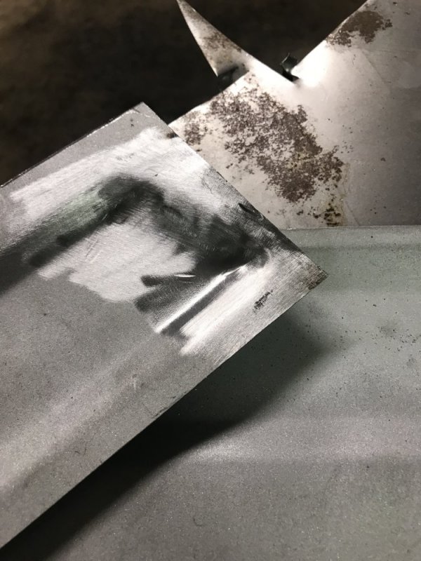

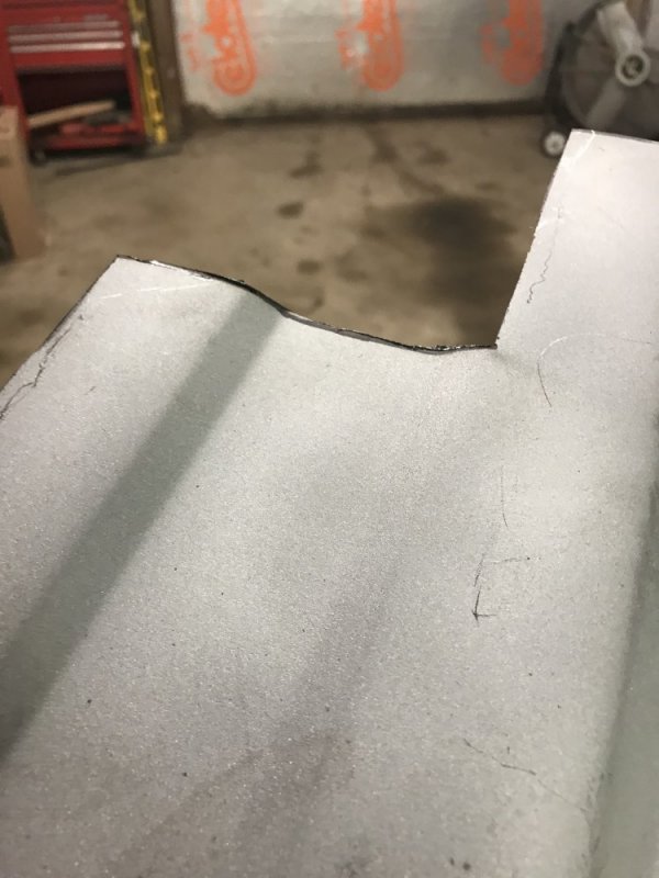

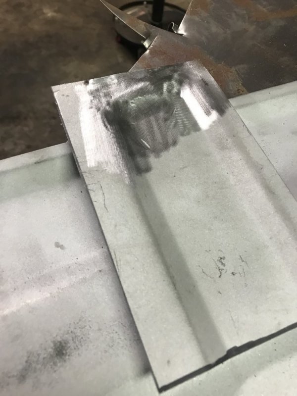

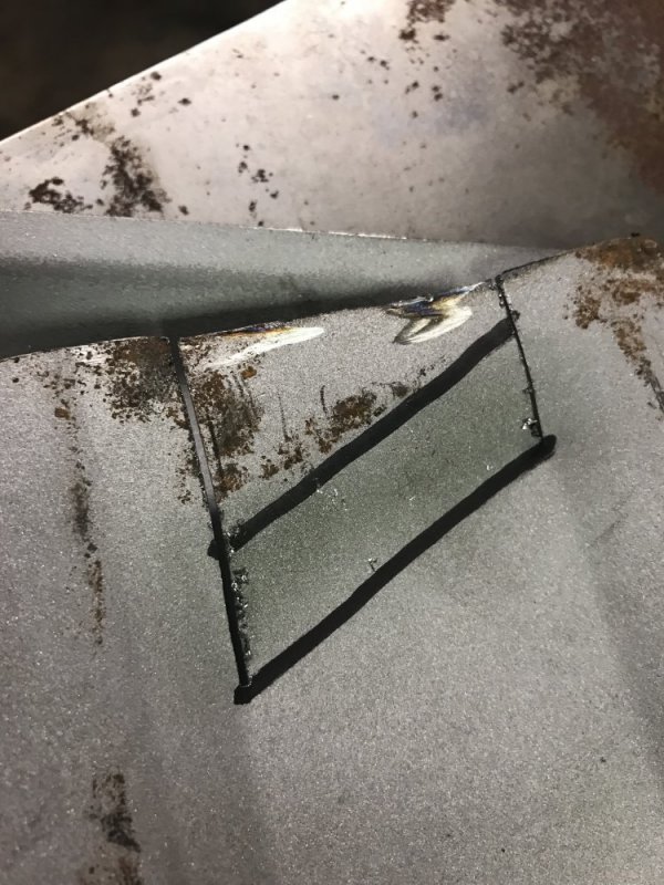

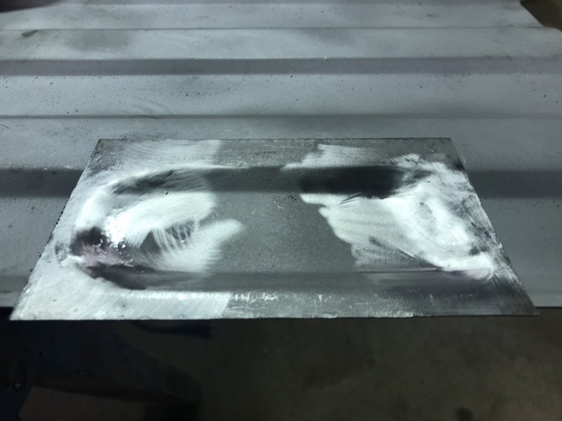

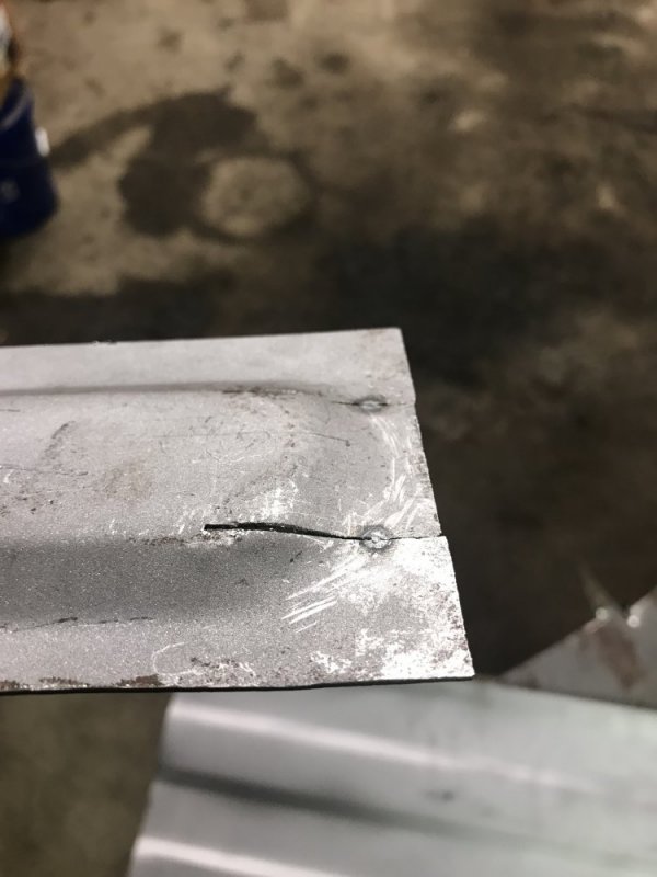

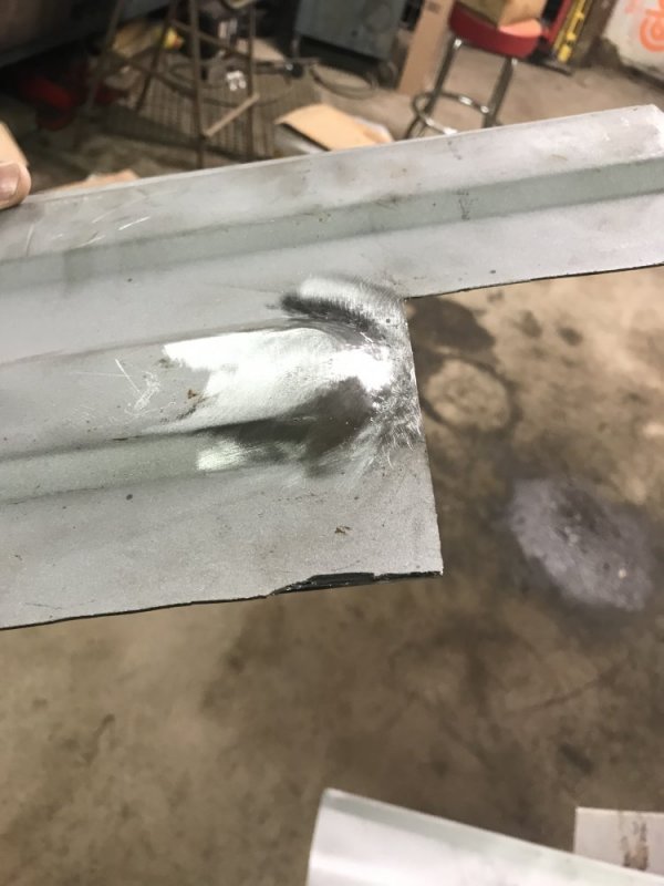

While paint was drying in between coats I made another patch panel. I took a few more pics of the progress this time. Here is one end of the panel:
