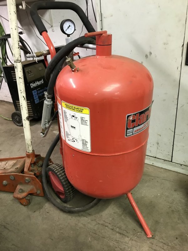

With all that sandblasting I'm curious what your using for an air compressor and blaster?
The blaster is a Clarke pressure pot unit. I think it’s discontinued now. The compressor is an old Speedaire 5hp 2-stage unit with an 80 gallon tank. Sorry, I don’t have any pics of the compressor right now.

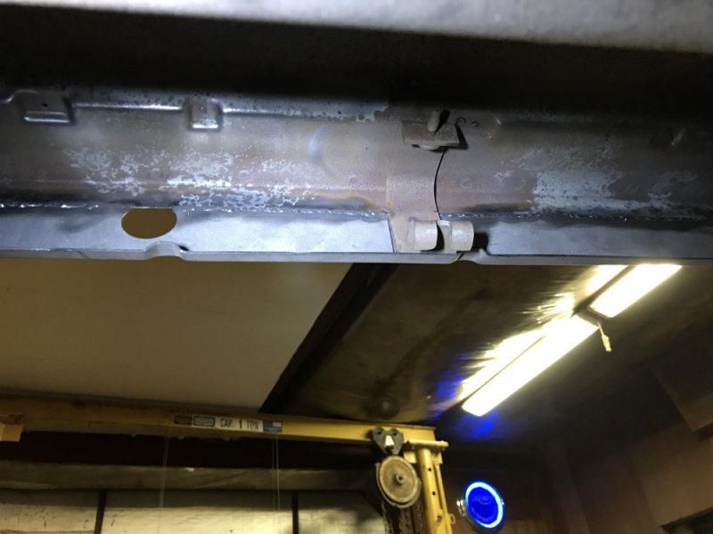

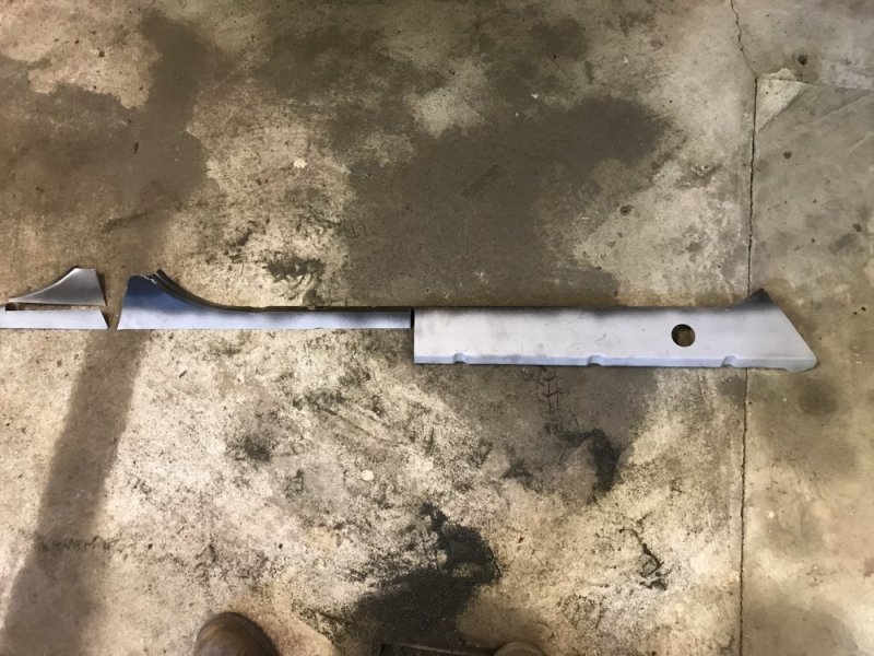

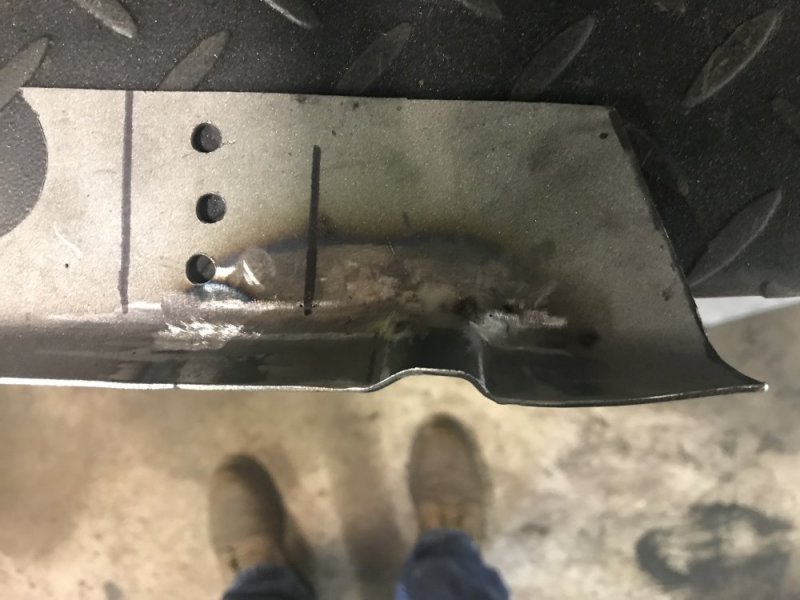

Got to start some metal work tonight. They don’t make an inner rocker panel for a 2 door Tahoe, so I had to make some pickup truck ones work. I cut out what would work and trimmed it until it fit decent.
There are still a couple spots that need some work to match the Hoe, but not a big deal. Of course one of the drain bumps interfered with the running board bracket so I have to do a little swapping there.

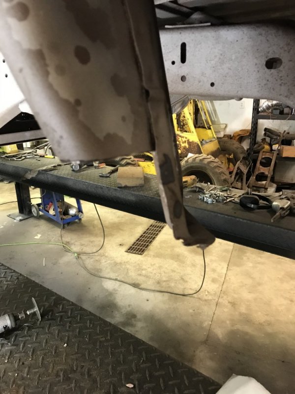

This is what’s leftover.

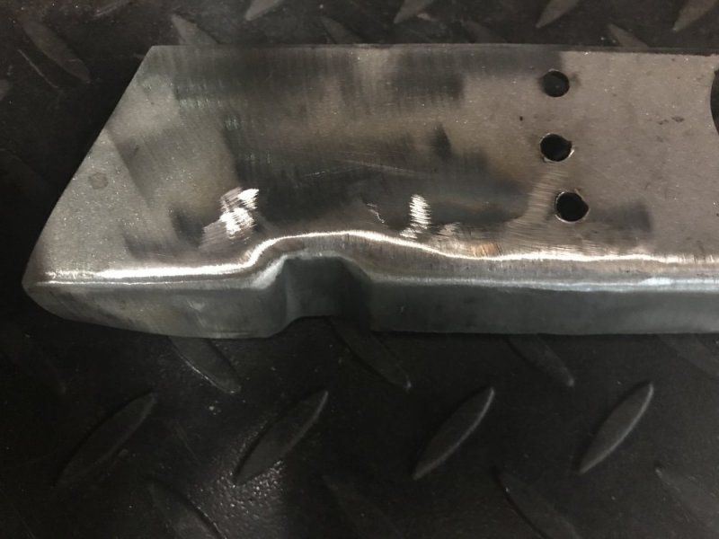

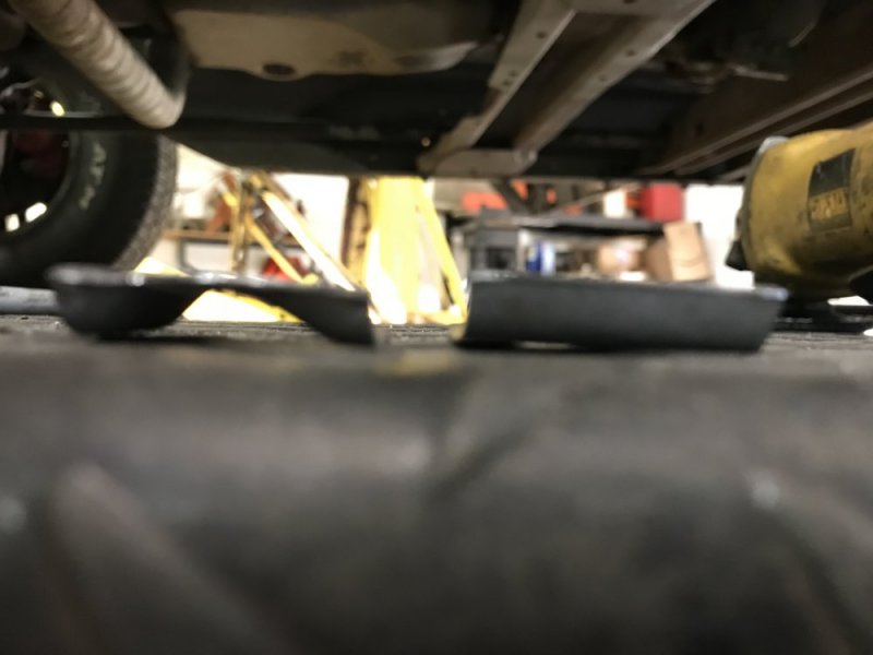

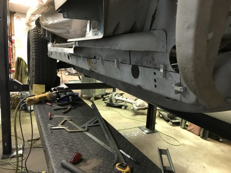

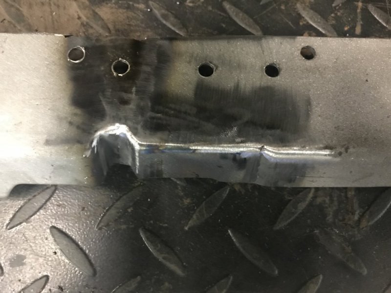

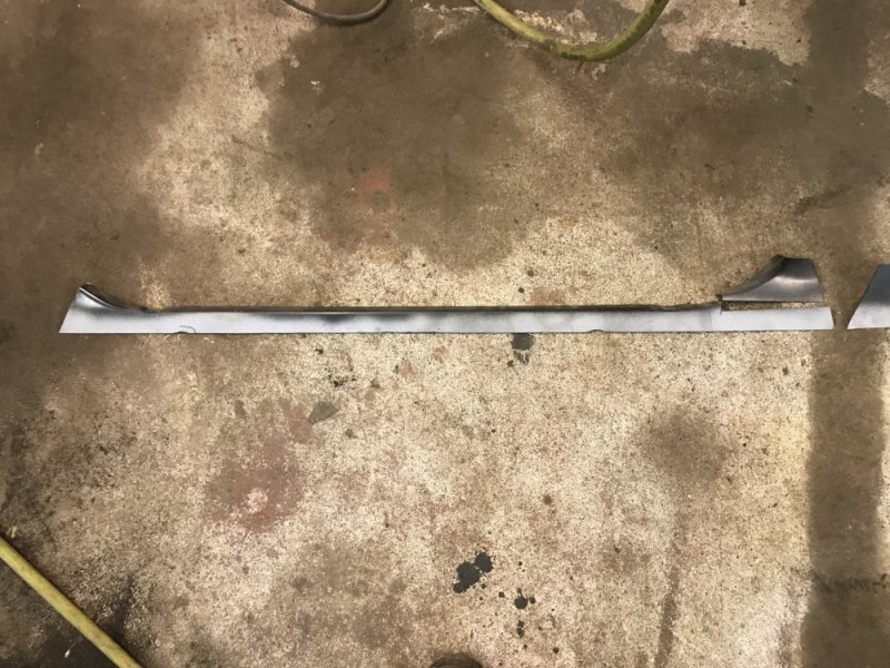

I got the inner rocker patch panel finished and ready for installation.
I got the mods done to the front. The bump is now further forward and out of the way of the running board bracket.

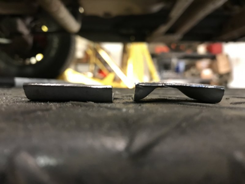

And to the middle. I added a bump up to accommodate the multiple layers of sheet metal where the rocker and quarter panels stack. Also joined the two panels into one piece.

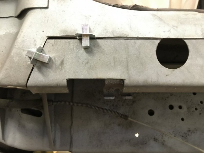

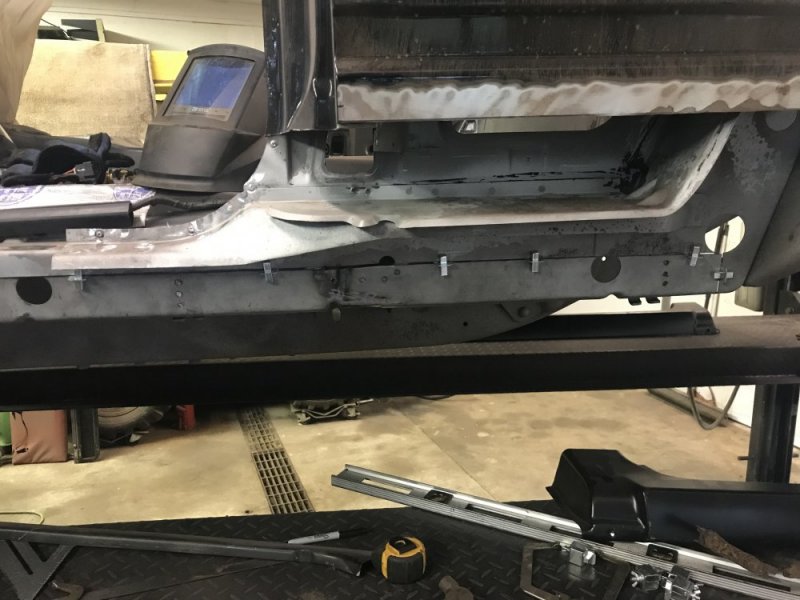

Here it is all installed and ready to weld. I’m really liking these panel clamps.

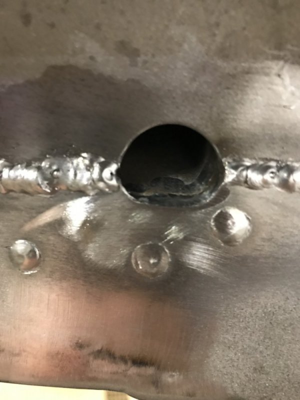

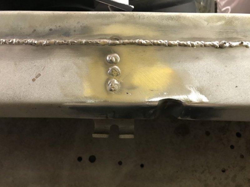

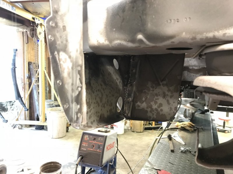

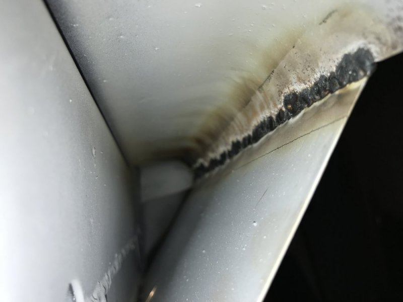

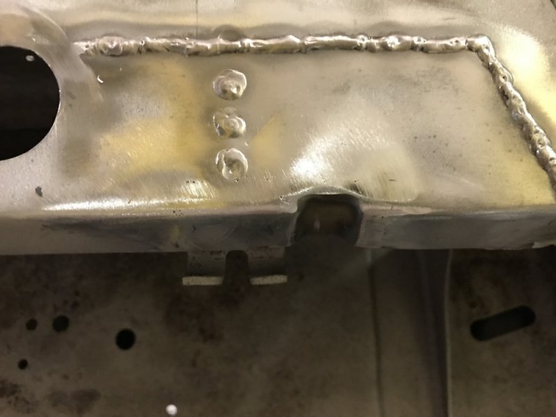

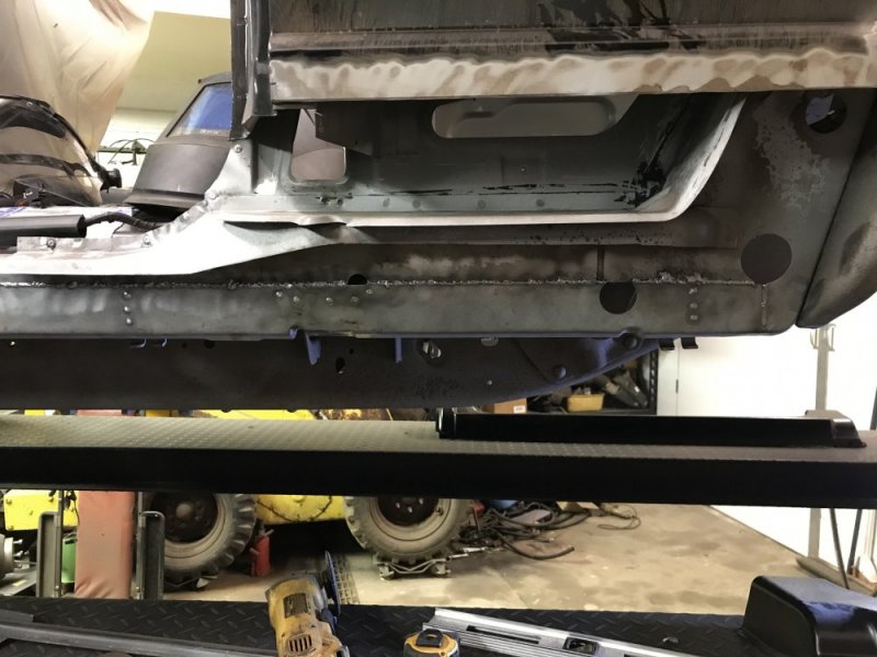

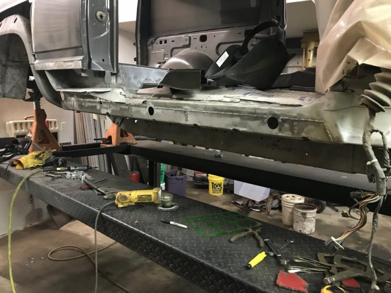

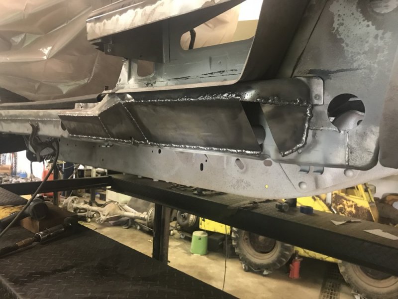

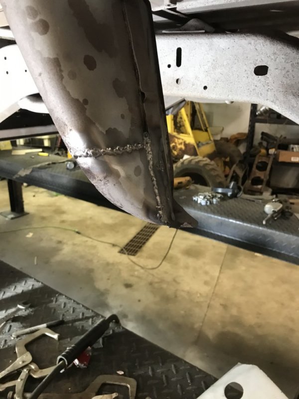

Friday night I finished welding out the driver side inner rocker panel. It isn’t the prettiest since it’s basically a series of tack welds to keep the sheet metal from warping, but there’s good penetration through to the back. Since it isn’t visible once the outer rocker is in place, I didn’t worry about grinding the welds down.

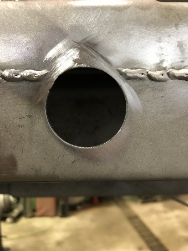

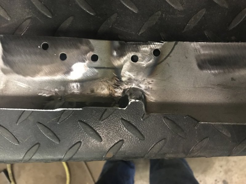

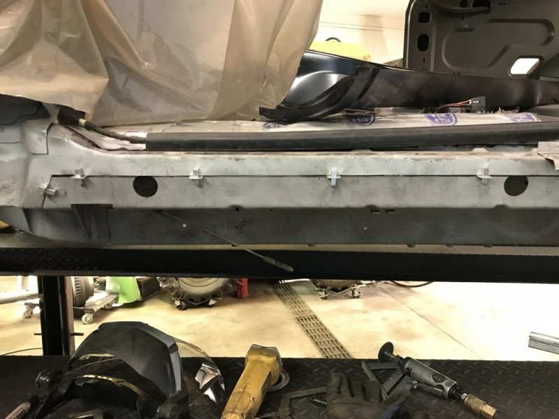

Today I used a template to complete the access circles in the metal. Then I used a carbide burr to cut the metal out.
I opened up the drain hole for the body crossmember as well.

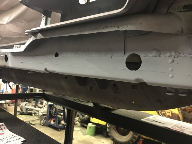

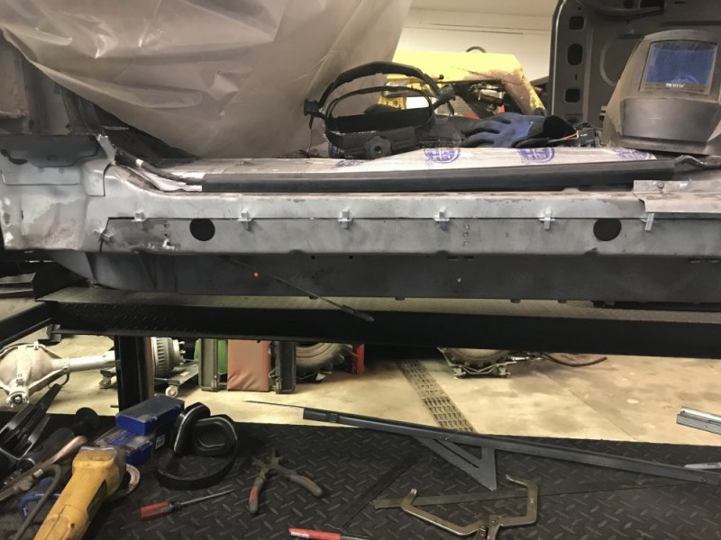

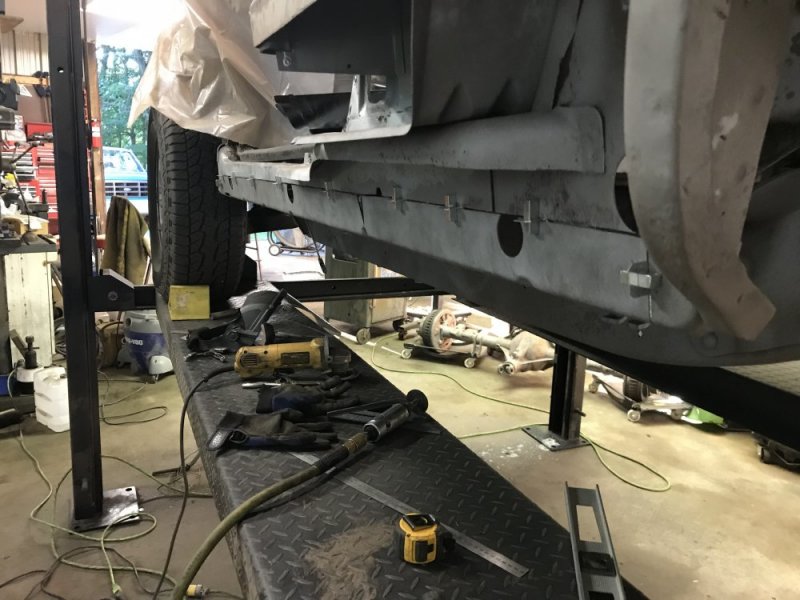

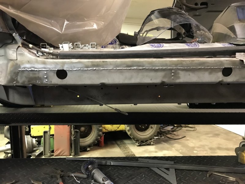

Then it was time to work on the passenger side. It went faster with all of the learning I did on the driver side. I got it all done today even though I had to actually relocate two of the drain bumps due to interference with the running board brackets.

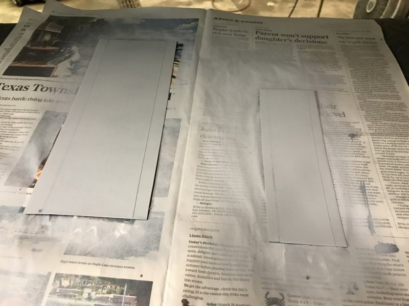

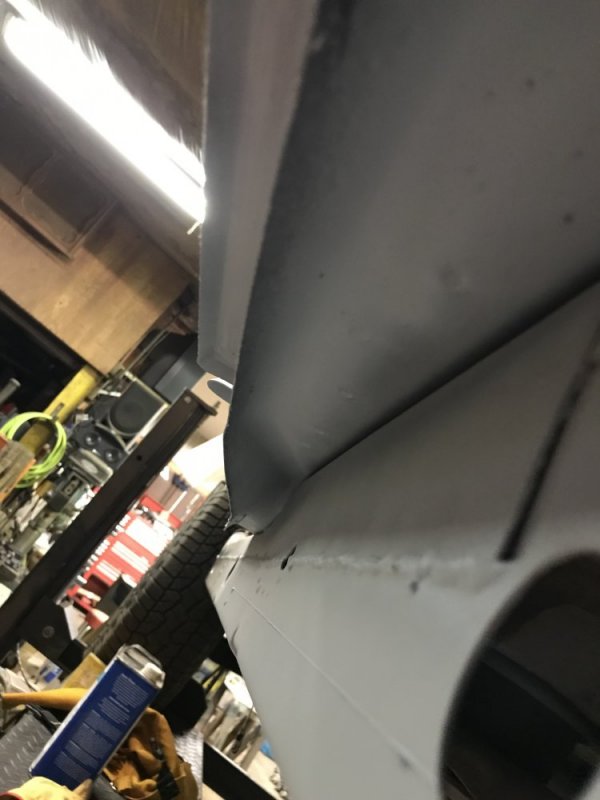

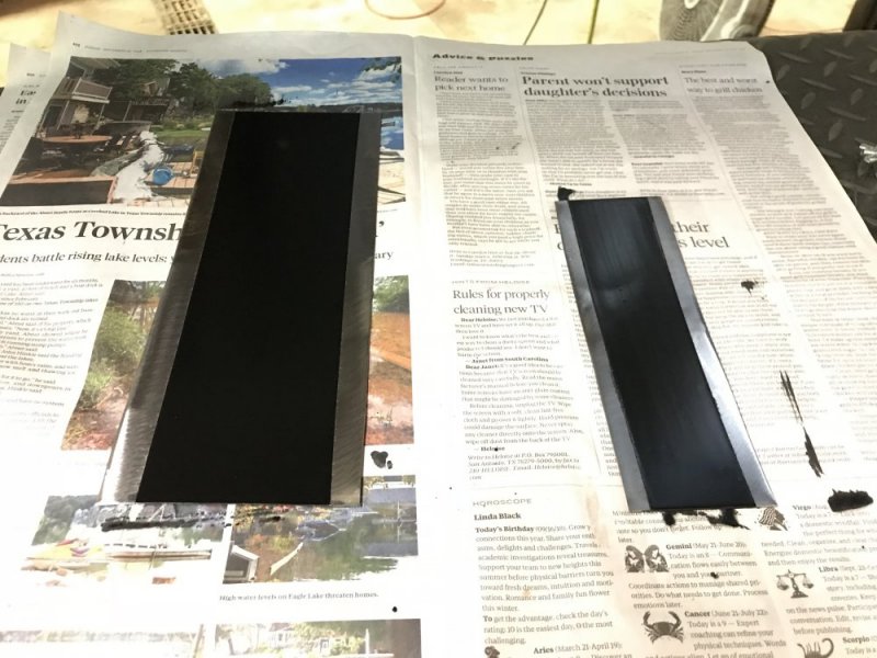

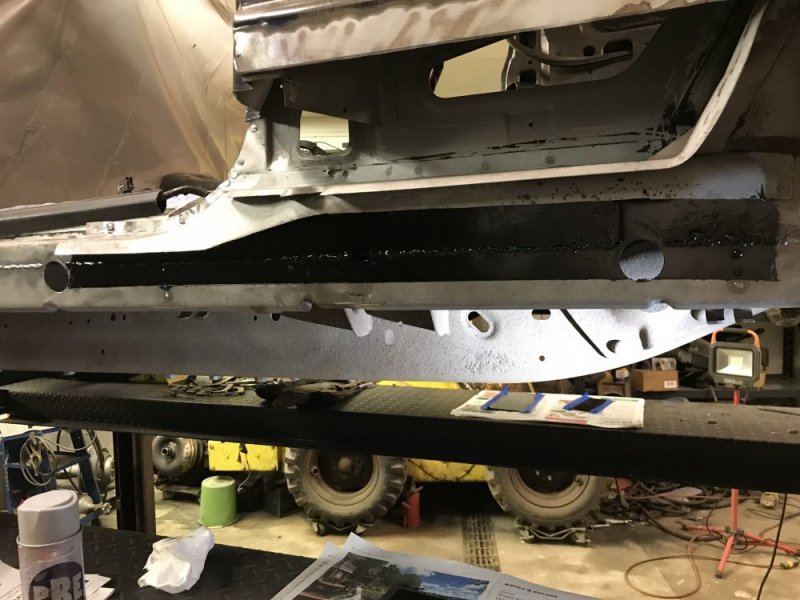

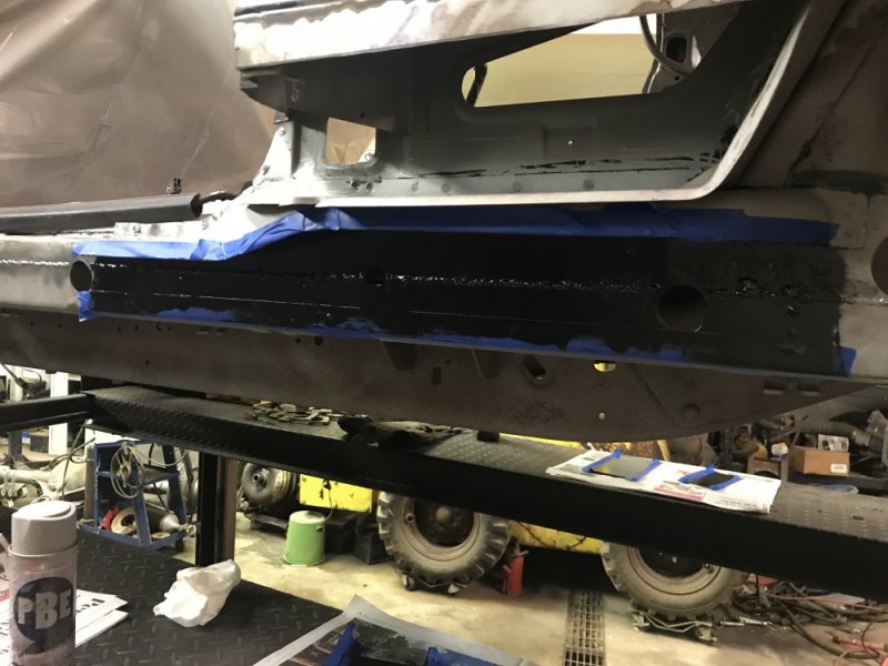

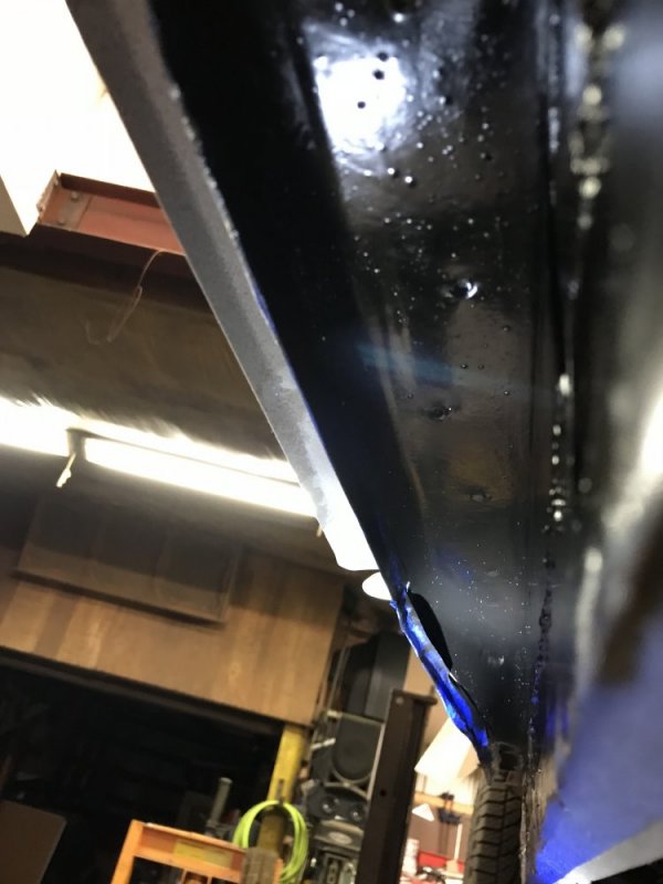

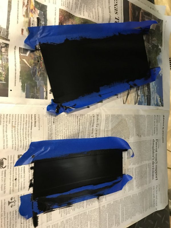

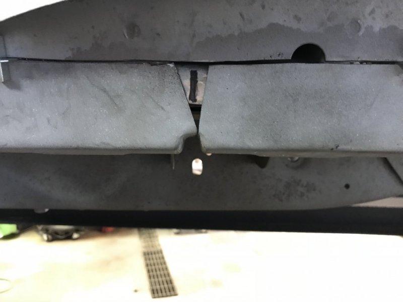

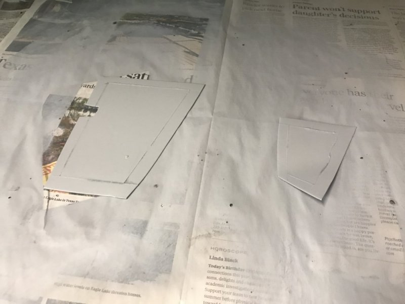

More progress this week. There’s a weird piece of structure between the inner and outer rockers on a 2 door Tahoe. It’s hard to tell what it does, but I guess if the factory thought it important enough to make it I better try to reproduce it. It isn’t the prettiest thing since I made it out of multiple pieces and didn’t really have a good guide to go by. I started fitting a couple pieces and then I applied some paint before welding them in. I used KBS Rust Seal for most of the surface, but masked off where the weld areas would be. Then I sprayed Seymour weld-through primer at all of the weld areas.

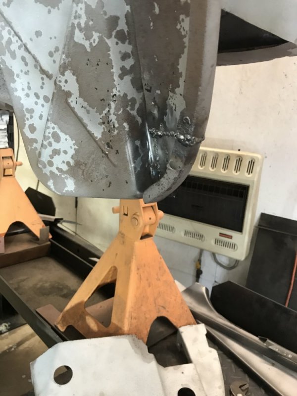

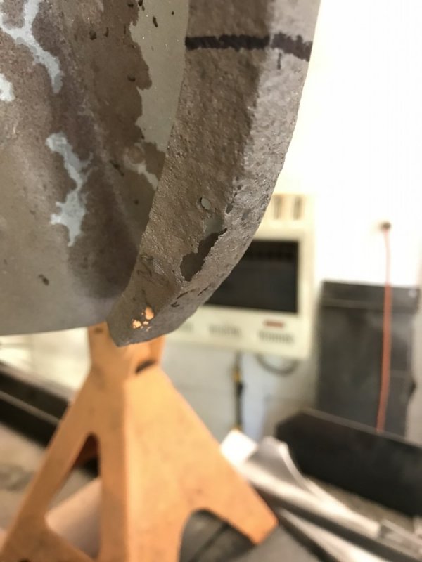

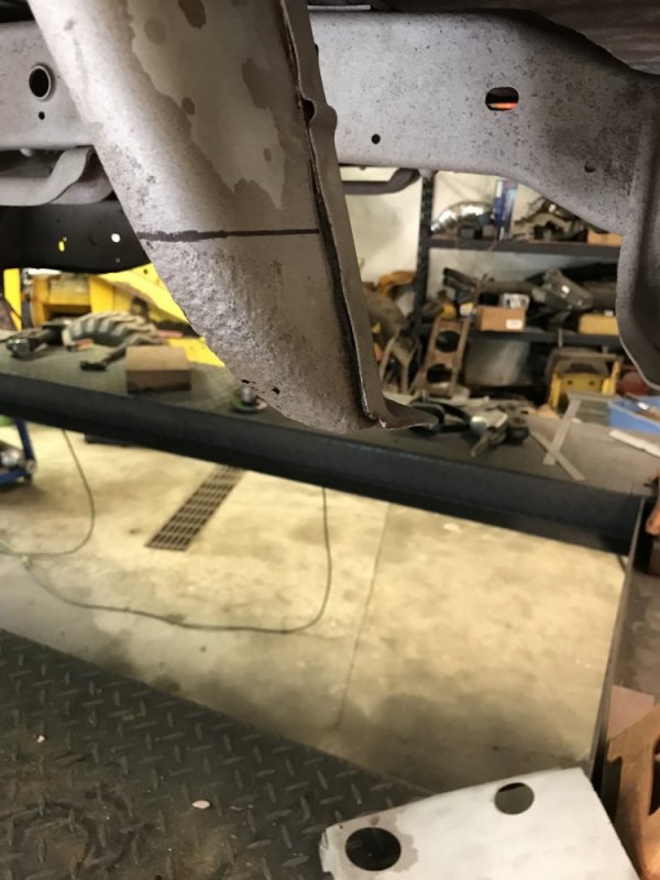

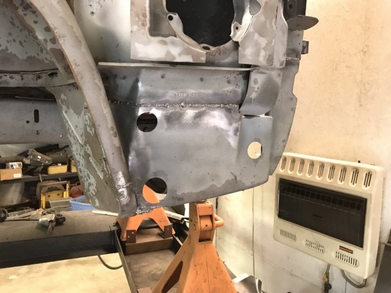

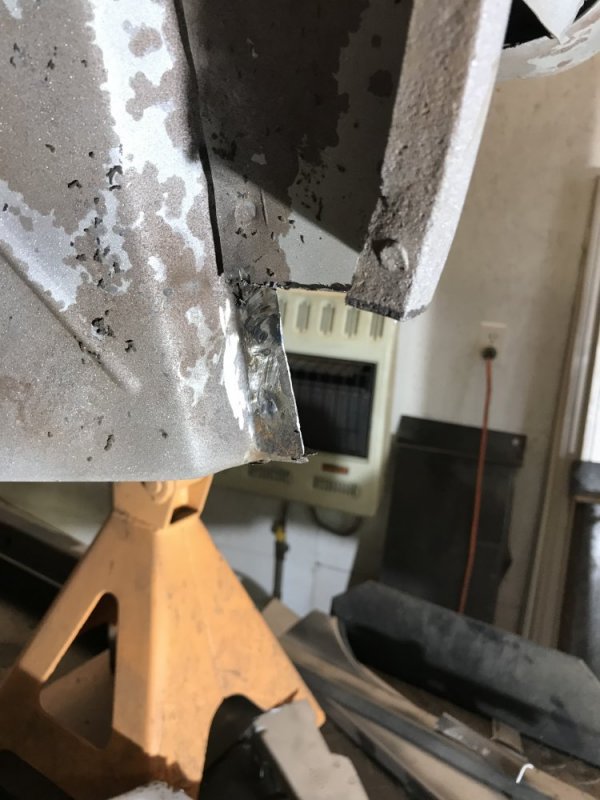

Now I’m working on behind the driver side rear wheel. Most of the original panel was toast both due to rust and someone backing into that corner a couple years ago. That last body cut I did a few weeks ago is really coming in handy here. If I had tried to make this from scratch it would have been pretty sketchy.
